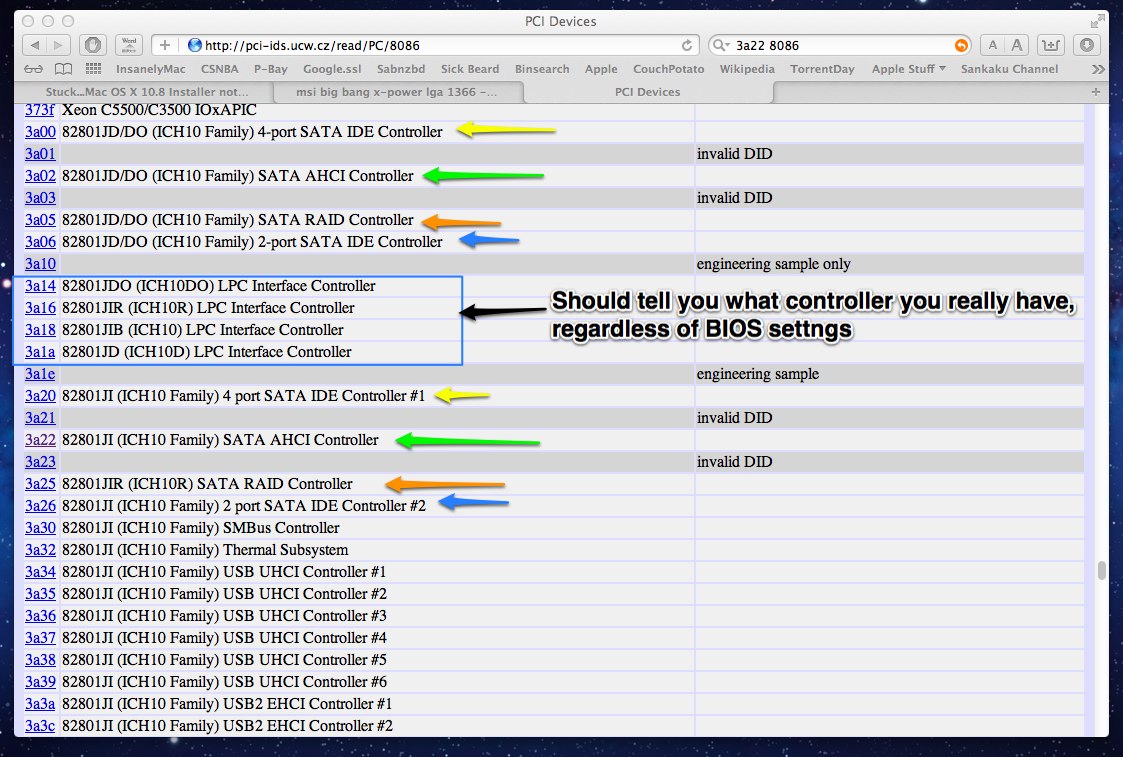

eep357 Posted September 26, 2012 Share Posted September 26, 2012 It's not because of MBR that disks don't show in Disk Utility. True OSX don't like to be installed to MBR, but you would be able to reformat to GUID (if you didn't have patched OSInstall.mpkg/mbr fix). It's your sata controller not loading. AppleAHCIPort.kext has entries in info.plist for ICH10 <key>ICH10AHCI</key> <dict> <key>CFBundleIdentifier</key> <string>com.apple.driver.AppleAHCIPort</string> <key>Chipset Name</key> <string>ICH10 AHCI</string> <key>IOClass</key> <string>AppleAHCI</string> <key>IOPCIPrimaryMatch</key> <string>0x3a228086</string> <key>IOProbeScore</key> <integer>2000</integer> <key>IOProviderClass</key> <string>IOPCIDevice</string> <key>Vendor Name</key> <string>Intel</string> </dict> with device ID 3a22 which is ICH10 or ICH10-R chipset set to AHCI mode, but no other variants like ICH10-D/DO which would be device ID 3a02 in AHCI or any ICH9. Double check you controller and it's device ID and edit plist as neededUltimately though you'll want to fix this via DSDT edit, I doubt the auto patch tool you used did much good, they usually use a collection of specific mobo patch files and if your's is not included, would only apply a few very basic fixes that won't provide much in function. If needed upload clean DSDT before having ran auto patcher and can fix sata For ICH10, as I understand it, you have 4 possible chipsets, each capable of IDE, and AHCI with the R and DO variants capable of RAID as well. Changing the mode in BIOS, will change the device ID, here see pic. Link to comment https://www.insanelymac.com/forum/topic/283134-stuckmac-os-x-108-installer-not-recognizing-hdds-partitions/#findComment-1855832 Share on other sites More sharing options...
r2rX Posted September 26, 2012 Author Share Posted September 26, 2012 You are absolutely right! I feel like an idiot right now... I checked my BIOS again...and my eSATA and SATA 6G were set to AHCI...there was an ATA setting (under RAID) that was set to IDE...when I changed it to AHCI, it worked! I guess I was being hasty and didn't read the 6G part. It installed fine now. Thanks for the feedback. Link to comment https://www.insanelymac.com/forum/topic/283134-stuckmac-os-x-108-installer-not-recognizing-hdds-partitions/#findComment-1855951 Share on other sites More sharing options...
