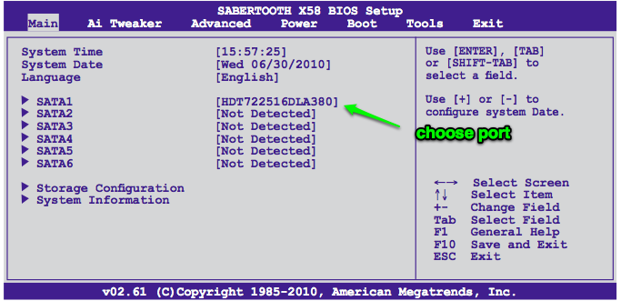

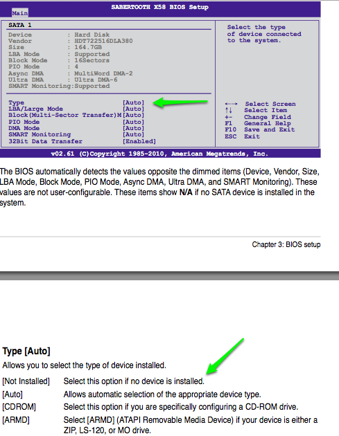

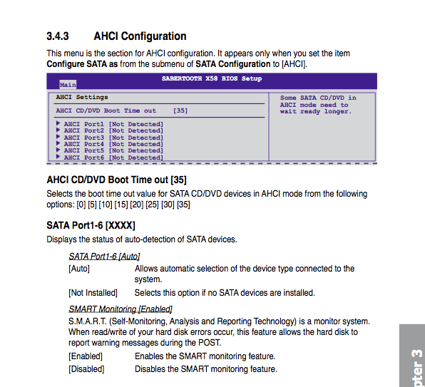

I think your in the AHCI/Storage configuration section. Here's from Sabertooth, very similar:
e5995_sabertooth_X58 (page 66 of 128)-2.pnge5995_sabertooth_X58 (page 66 of 128)-1.png
Yes, that is where I disable it, but still not working. I think that it's only disabling autodetection, not the port. I'll try the boot flag on chameleon, thanks.
