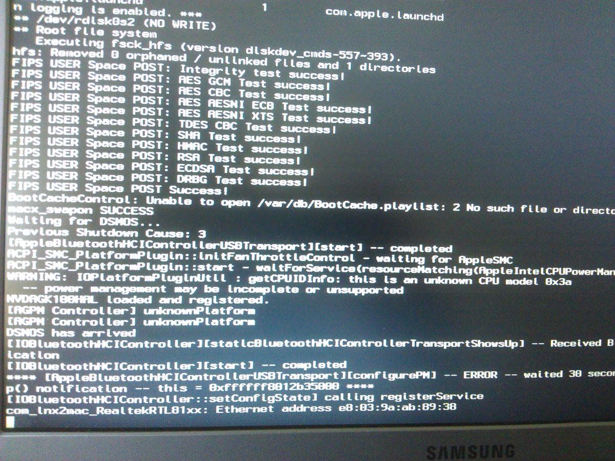

Trying the install on to A Samsung NP550...

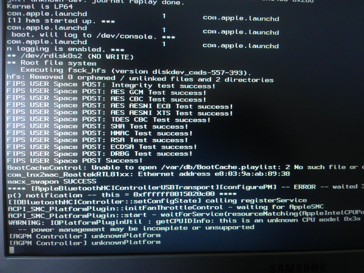

Install finishes fine but then hit the error in the image attachment when reboot.
I boot using the USB and use the switches:
GraphicsEnabler=No -v
help needed - thanks,

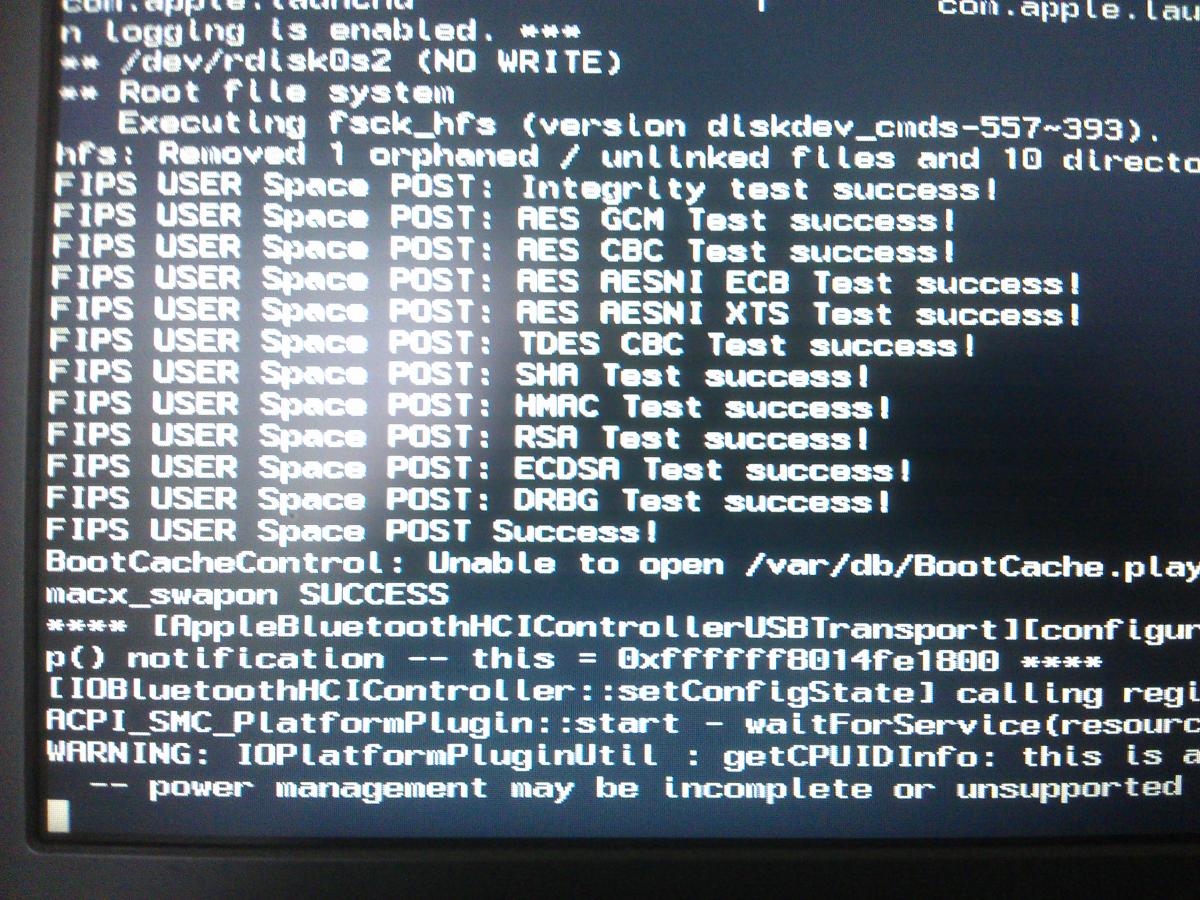

Ten minutes later...
Also just tried AHCIPortInjector.kext from here.
and the recommended boot up:
-f -v GraphicsEnabler=No npci=0x2000
might be getting further ?? seeing this now:

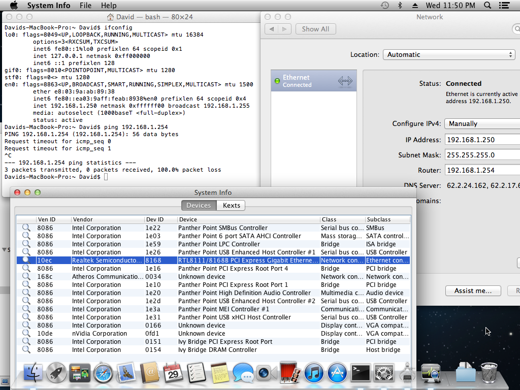

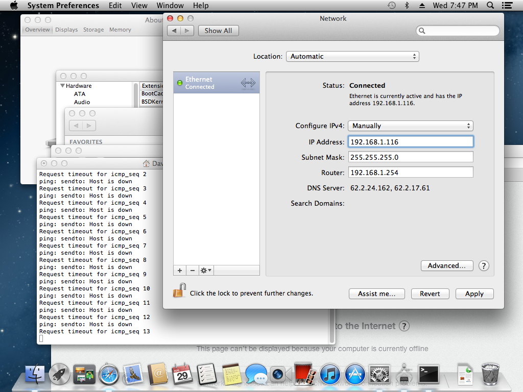

The Ethernet adapter I thought would be first of all since wireless isn't appearing under networking however have u seen anything like this before where the Adapter is shown as connected, I have Manually configured however no networking is possible.
Similarly if I left it to get an address assigned via DHCP it would only get a 169.172 private address assigned...

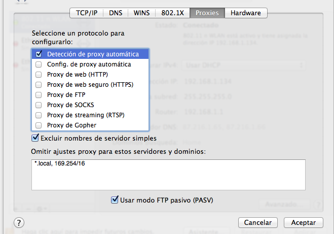

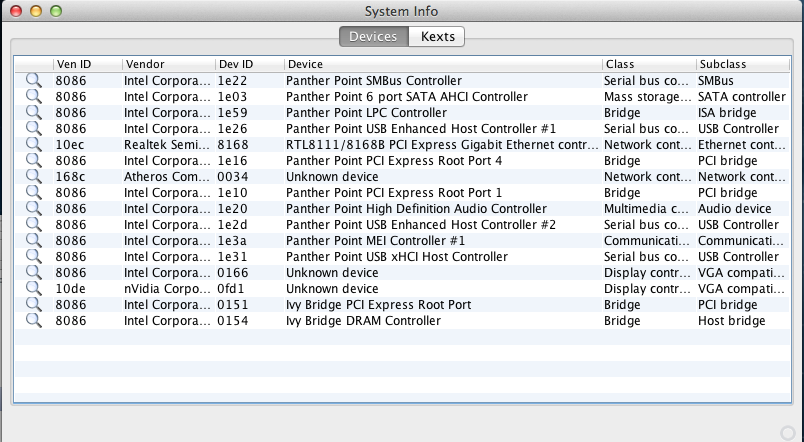

copy extra folder from your USBinstallerfor root your hard disk , use this app for see your hardware, you can try free DNS Google or others 8.8.8.8 and 4.4.4.4 for test, active detect auto proxies
Systeminfo-Mac.zip

No luck getting the ethernet working....
Most confused since what I can see it should be working. lspci output at the top of thread shows:
03:00.0 Ethernet controller [0200]: Realtek Semiconductor Co., Ltd. RTL8111/8168B PCI Express Gigabit Ethernet controller [10ec:8168] (rev 06)
Similarly System Info out put shows that the device is loaded.... the Ethenet is configurable in Network preferences however no pinging or lookups working. Also Network Utility shows no sent packages nor any errors.
Seriously out of ideas : (

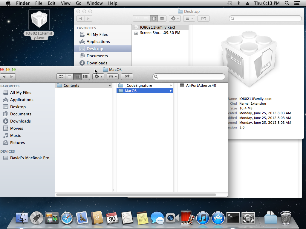

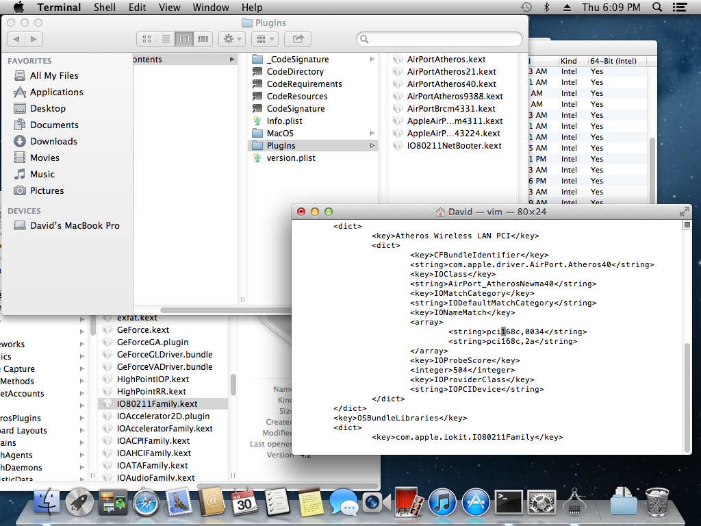

The IO80211Family kext installed is version 5.0. The AirAtheros40 kext within does not have an Info.plist - see screenshot Screen Shot 2012-08-30 at 6.13.19 PM

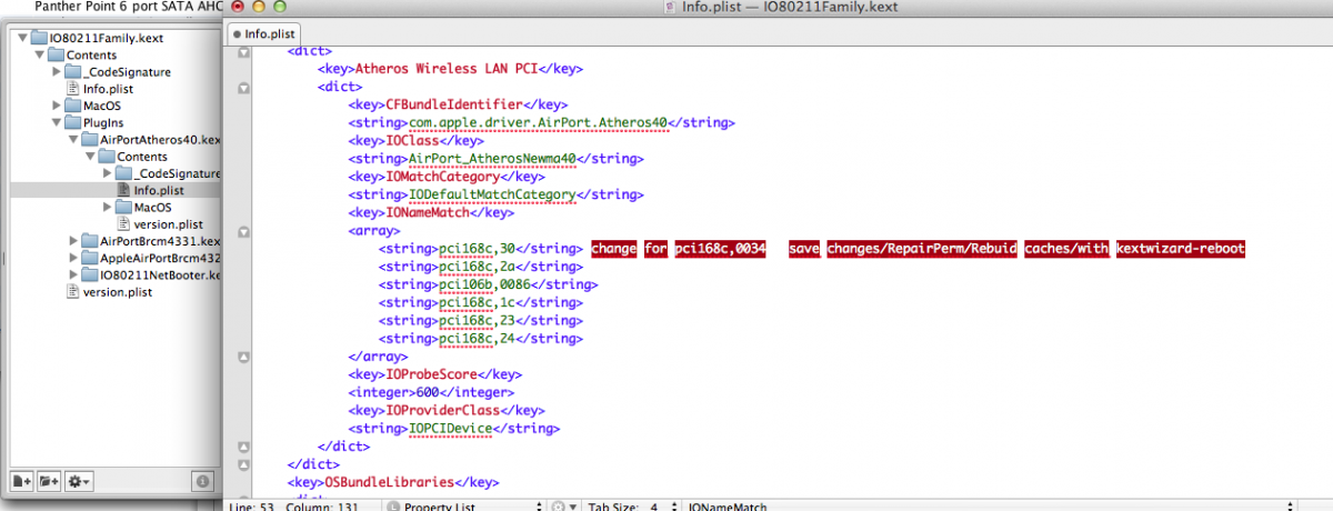

I put earlier version 4.2 in place (fixed permisions) and made the edit then rebooted see screenshot Screen Shot 2012-08-30 at 6.09.30 PM.
No wireless... yet....

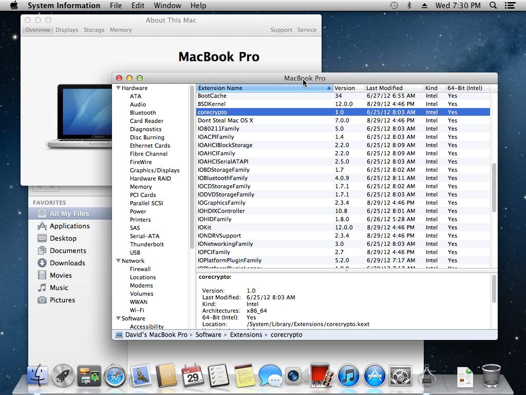

Nope no wireless.
Would "Safe Boot" be causing this ?
No IO80211Family nor AppleAtheros40 kexts appear to be loaded....
sudo dmesg shows
SAFE BOOT DETECTED - only vaild OSBundleRequired kexts will be loaded.

update for 10.8.1 and your card have support , this kext is 10.8.1 you have repair permissions?
yes, if you boot in safe boot not load the kexts

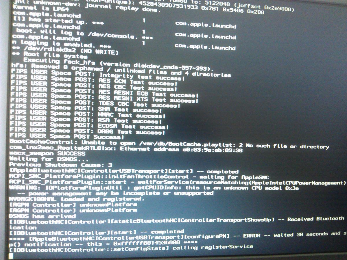

rebooting without "-x" option leaves me on stuck (see screenshot)
Is this error due there being no suppported power management ?
BTW I have already done the 10.8.1 update.
Share this post
Link to post
ok, backup this kext AppleIntelCPUPowerManegement.kext and delete from S/L/E repairPermissions and reboot
