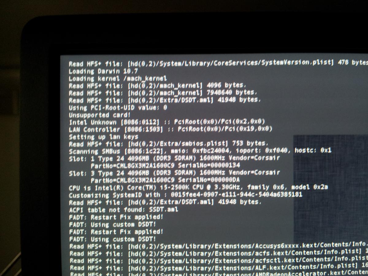

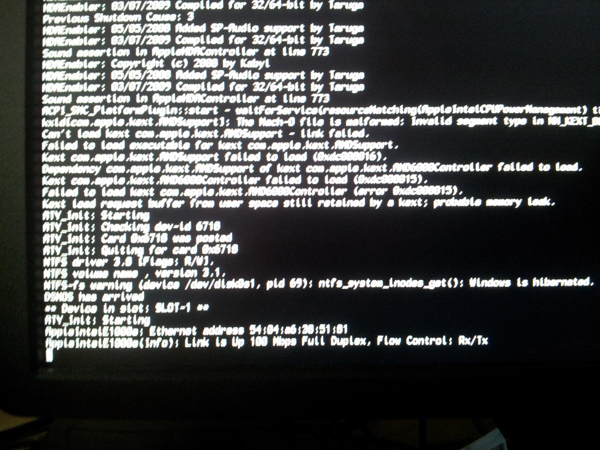

blak24 Posted August 25, 2012 Author Share Posted August 25, 2012 hey fire! I will try this, thanks EDIT: fire, if it boots now, can I restore my time machine backup? Lion was working fine as you know before things were messed up. my question is: will the time machine backup restore also the installed kexts? EDIT2: no boot with that... always saying "Unsupported card!" (first image) and then stuck (second image) Link to comment https://www.insanelymac.com/forum/topic/282219-trying-again-its-time-to-lion/#findComment-1847494 Share on other sites More sharing options...

blak24 Posted August 26, 2012 Author Share Posted August 26, 2012 guys please someone help me... I tried to update bootloader (now no more "unsupported card") if I boot in safe mode the HD3000 is recognized correctly, but if I do not boot in safe mode I have always the same problem: stuck at the second image posted before... Link to comment https://www.insanelymac.com/forum/topic/282219-trying-again-its-time-to-lion/#findComment-1847723 Share on other sites More sharing options...

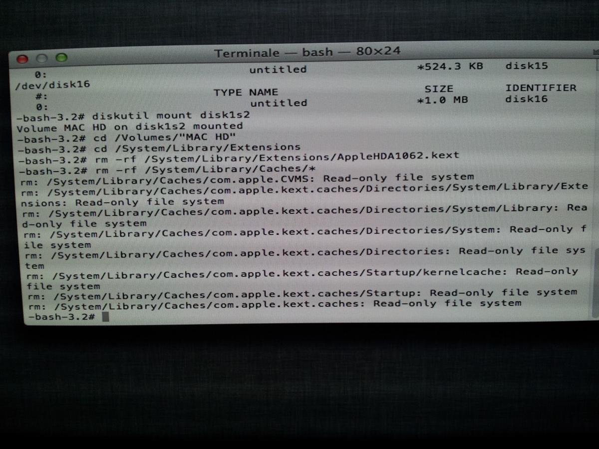

iFIRE Posted August 27, 2012 Share Posted August 27, 2012 ok, boot your usbinstaller open app Terminal 2. type diskutil list 3 see your disk is for EX: disk1s2 4. diskutil mount disk1s2 5. cd /Volumes/name of your disk 6. cd /System/Library/Extensions 7. rm -rf /System/Library/Extensions/AppleHDA.kext 8 .rm -rf /System/Library/Caches/* 9 .reboot -r now Link to comment https://www.insanelymac.com/forum/topic/282219-trying-again-its-time-to-lion/#findComment-1848076 Share on other sites More sharing options...
blak24 Posted August 27, 2012 Author Share Posted August 27, 2012 ok, boot your usbinstaller open app Terminal 2. type diskutil list 3 see your disk is for EX: disk1s2 4. diskutil mount disk1s2 5. cd /Volumes/name of your disk 6. cd /System/Library/Extensions 7. rm -rf /System/Library/Extensions/AppleHDA.kext 8 .rm -rf /System/Library/Caches/* 9 .reboot -r now Ok... I'm not at home now.. I will try and let you know later, thanks! EDIT: tried, it seems that it deletes the AppleHDA1062.kext, but I can't delete cache files... so it still reboots because he continues reading that kext... or maybe it didn't delete it... Link to comment https://www.insanelymac.com/forum/topic/282219-trying-again-its-time-to-lion/#findComment-1848081 Share on other sites More sharing options...

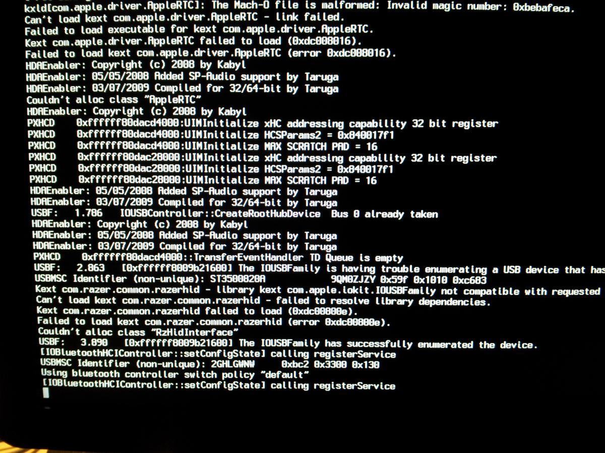

blak24 Posted August 27, 2012 Author Share Posted August 27, 2012 tried booting with -f or -F, I don't remember well, wich disable kernel cache... but I think that the kernel cache is different from the cache in S/L/Caches... EDIT: ok, I created a new partition on my MAC HD and I installed ML. from ML in safe boot I deleted the AppleHDA1062.kext and the folders in System/Library/Caches... it goes on now loading all the kexts... but now it is stuck here, it's a story that will never ends note that these messages (in the picture) are the first messages that appears when it says "MAC framework succesfully initialized"... so as soon as it finish loading kexts (the bootloader) and the system continues booting, it is stuck here... P.S: why I always have these problems? :S I just restored the timemachine backup... shouldn't it be the same system that was before? I was able to boot without any problem... it's a mystery Link to comment https://www.insanelymac.com/forum/topic/282219-trying-again-its-time-to-lion/#findComment-1848108 Share on other sites More sharing options...
