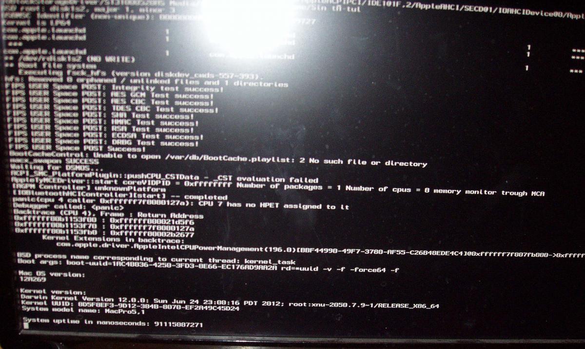

Mendiaco Posted July 30, 2012 Share Posted July 30, 2012 I have installed on my HD Mountain lion with a USB. When I try to boot I have a Kernel Panic. I'll tried to boot without HPET from the bios (Don't Work) Any Idea? I'm trying to install on a Gigabyte EX58-UD4P. thanks. Link to comment https://www.insanelymac.com/forum/topic/281266-kernel-panic-booting-hd-mountain-lion/ Share on other sites More sharing options...
eep357 Posted July 30, 2012 Share Posted July 30, 2012 use nullcpupowermanagement until you get a patched dsdt Link to comment https://www.insanelymac.com/forum/topic/281266-kernel-panic-booting-hd-mountain-lion/#findComment-1838992 Share on other sites More sharing options...
Mendiaco Posted July 30, 2012 Author Share Posted July 30, 2012 I boot from USB (First booting for my HD). I have installed in my USB S/L/E/ nullcpupowermanagement need to install in extra folder too? Thanks. Link to comment https://www.insanelymac.com/forum/topic/281266-kernel-panic-booting-hd-mountain-lion/#findComment-1838995 Share on other sites More sharing options...
Mendiaco Posted July 31, 2012 Author Share Posted July 31, 2012 I Installed in my HD S/L/E nullcpupowermanagement and it works! Thanks 1 Link to comment https://www.insanelymac.com/forum/topic/281266-kernel-panic-booting-hd-mountain-lion/#findComment-1839270 Share on other sites More sharing options...
