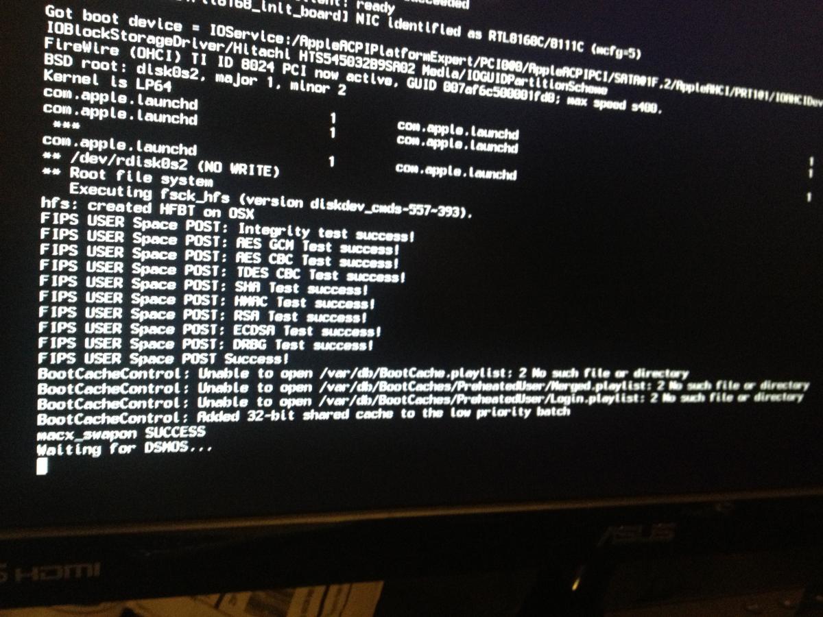

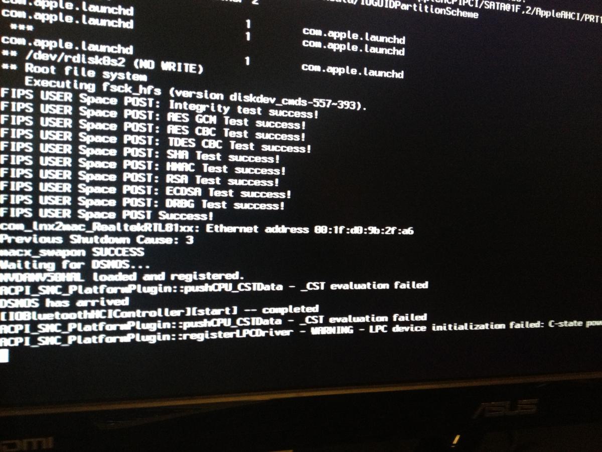

jrdnlc Posted July 21, 2012 Share Posted July 21, 2012 Anyone has thi MB and successfully installed ML GM on it? After i got it installed my CPU fan is running at full RPMs and im getting a pushcpu failed error when booting up among others. Im using a DSDT i got for my board from tonymac It worked fine with Lion please help Link to comment https://www.insanelymac.com/forum/topic/280851-ga-ep45-ud3r-ml-gm/ Share on other sites More sharing options...

everdone Posted July 21, 2012 Share Posted July 21, 2012 The first of the two pictures you posted indicates the problem is with video. If you post your video card used and indicate any graphic enablers used that would help in diagnosing the problem. Link to comment https://www.insanelymac.com/forum/topic/280851-ga-ep45-ud3r-ml-gm/#findComment-1835833 Share on other sites More sharing options...
jrdnlc Posted July 21, 2012 Author Share Posted July 21, 2012 The first of the two pictures you posted indicates the problem is with video. If you post your video card used and indicate any graphic enablers used that would help in diagnosing the problem. I have a GeForce 9400 GT. I dont remember checking GraphicEnabler=Yes when I ran Multicrap. Link to comment https://www.insanelymac.com/forum/topic/280851-ga-ep45-ud3r-ml-gm/#findComment-1835837 Share on other sites More sharing options...
everdone Posted July 21, 2012 Share Posted July 21, 2012 Try booting with -x at the boot screen and see if that will get you to the desktop. You can then look at the boot.plist in Extra to see if GE=No is present. Change No to Yes, save and reboot. Otherwise, try rerunning your setup to set the flag to yes. Link to comment https://www.insanelymac.com/forum/topic/280851-ga-ep45-ud3r-ml-gm/#findComment-1835847 Share on other sites More sharing options...
