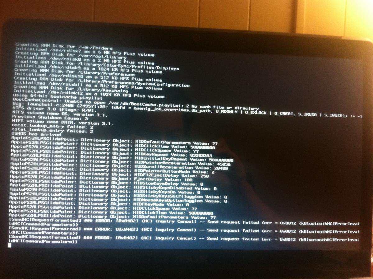

Jary316 Posted June 14, 2012 Share Posted June 14, 2012 Hello, I have been trying to install Lion using Chameleon but I initially got the "PCI Configuration begin" message and my computer froze. I spent hours looking into multiple forums and tried multiple command-line parameters for the boot such as "npci=0x2000" or "-f -v" or even the busratio, graphics, and such. None of it helped, it still froze at the same place. Then I tried replacing IOPCIFamily.kext and AppleACPIPlatform.kext and I got a different result. I also tried to use EvilAppleACPIPlatform.kext & EvilIOPCIFamily.kext which got me the same result. I would like to please show you what happened and ask you if you have any suggestions please. I hope that the picture is visible. The error just kept repeating every 5 seconds or so. I am not sure if it is an improvement from the "PCI Configuration begin" or if it happens after this loading part with the original ktext. For information, I am running an ASUS N61JQ-A1. The specs are the following: Intel Core i7-720QM, ATI 5730 Graphics Engine (Mobile Radeon HD), 4GB of DDR3 1066MHz SDRAM. I have spent a couple hours trying to bypass the "PCI Configuration begin" freeze and I really look forward for your help. Thank you very much for your help. Link to comment https://www.insanelymac.com/forum/topic/279761-pci-configuration-begin-freeze-transformed-in-a-new-kind-of-issue/ Share on other sites More sharing options...
Jary316 Posted June 14, 2012 Author Share Posted June 14, 2012 Hey guys, sorry to have bugged you, I was finally able to fix the problem! I ran the automated tool myFix and the problem is now gone! Link to comment https://www.insanelymac.com/forum/topic/279761-pci-configuration-begin-freeze-transformed-in-a-new-kind-of-issue/#findComment-1826730 Share on other sites More sharing options...
Gringo Vermelho Posted June 14, 2012 Share Posted June 14, 2012 For those who are wondering, myFix installs a patched IOPCIFamily.kext and is part of Conti's MyHack: http://myhack.sojugarden.com/guide/ For those of us who like doing things by hand, get the latest patched IOPCIFamily.kext here: http://netkas.org/?p=1053 Link to comment https://www.insanelymac.com/forum/topic/279761-pci-configuration-begin-freeze-transformed-in-a-new-kind-of-issue/#findComment-1826732 Share on other sites More sharing options...
