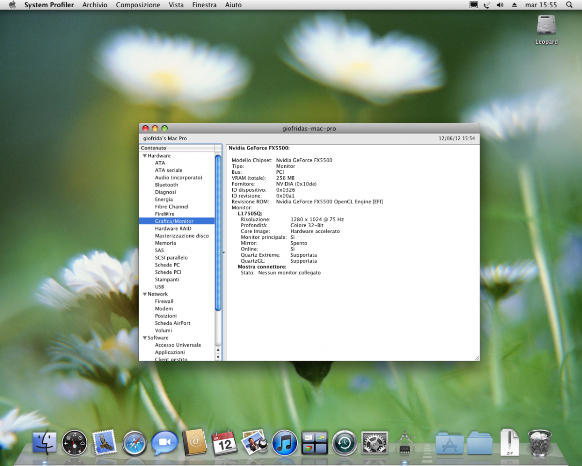

8. Now, QE/CI should work, but with some glitches. (See for example System Preferences window)
9. Open the CoreGraphics 10.5.5 Framework Package with Pacifist. Then, Select all the files, Right Click it, Install to default location. Now, REBOOT.
If you want, you can also enable Quartz GL (Quartz Extreme 2D) by clicking on OSx86 Tools the button Enable/Disable Quartz GL.
Check my Attached File to view my System Profiler.
Translucent bar doesn't work because the FX5200/FX5500 are too old ):

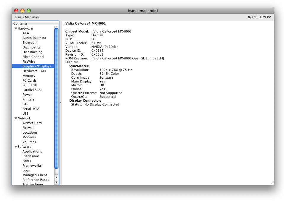

Hi giofrida!!!
I am a new user of Hackintosh!!!!!
Thank you for your post!!!! It helped me a lot!!!  :D
My PC:
Mother: Intel D865GLC
Micro: Intel 3,0GHz 1 core socket 478
Sound: MaxSound onboard(with AppleAC97Audio.kext installed) workin great!
Video: nVIDIA GeForce4 MX4000 64Mb
Software: iatkos 7v.

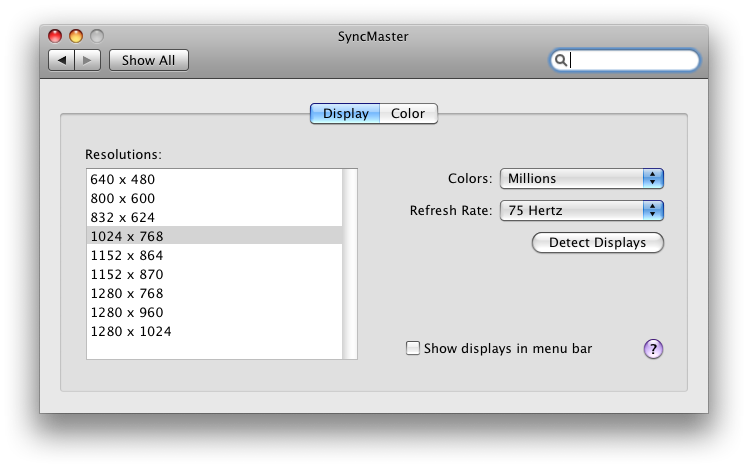

I did all steps that you wrote and it worked good for me, not great, because it´s an old video card and CI works on software mode, but i can change my resolution properties!!!  :w00t:
Thank you very much!!!!
Great Job!
