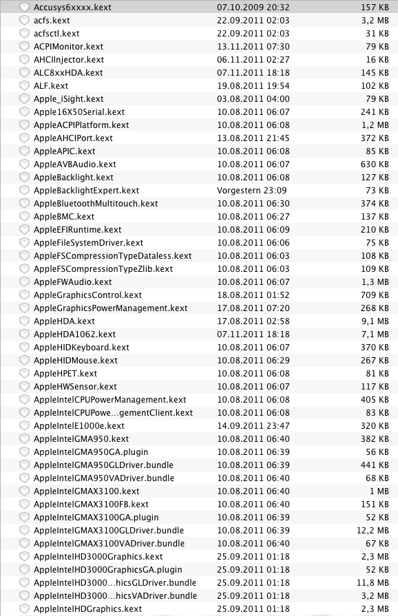

joecracker Posted June 9, 2012 Share Posted June 9, 2012 Maybe you can answer my question. Maybe I can answer your question if you have a similiar system and dont get it running. System: IATKOS L2 10.7.4 Chameleon Bootloader DSDT patched Core i5 2400k Intel DH67GD Mainboard (newest BIOS) 4GB 1333 DDR3 RAM 'Corsair XMS3' (normally: 12GB) Powercolor AMD/ATI HD5870 1024MB KEXTS in attached files KEXTS in attached files Ive got two problems on my new selfmade Powermac G5 mod (pictures may follow if you want) First: My 5870 is recognised and works perfekt. But the fan is very loud and the GPU gets hot (idle 70°C). Games like Diablo3 run perfekt, too. I guess its a sensor problem. Do you have any idea how to fix it? Second: I crashed my system and restored it with TimeMachine. Now Im only able to boot up with DVD, then F8 and entering "rd=disk1". Is there a method to fix it under OSX? I would be very happy about any response. I feel very alone with my problems right now regards Link to comment https://www.insanelymac.com/forum/topic/279640-5870-high-fan-speed-complicated-boot-up/ Share on other sites More sharing options...

eep357 Posted June 9, 2012 Share Posted June 9, 2012 you do not need aty_inject, 5870 if reference design will run otb, no injectors or graphics enabler needed. That said, I still use GraphicsEnabler=Yes so I can manually set the framebuffer to ATIConfig=Uakari and ATIPorts=4 for all the ports to work and DVD player to work. Also if you post list of kexts actually running instead of the contents of your extensions folder, can verify all the right ones are getting loaded, also what is the device ID for your card, if it's 6898 your all good. 2 Link to comment https://www.insanelymac.com/forum/topic/279640-5870-high-fan-speed-complicated-boot-up/#findComment-1825565 Share on other sites More sharing options...
joecracker Posted June 9, 2012 Author Share Posted June 9, 2012 I understand your first part. Thats why I removed ATY_Init.kext now. 6898 is right, too. When I remove ATY Init my about mac only says ATI 5000 Series (not 5870 1024MB), Diablo III still runs with perfekt FPS and fans are quiet. Steam games dont run at this time (still wondering why). What about these kexts: - ATI Support - ATI Framebuffer - ATI 5000 Controller ? Thanks for your reply eep! Edit: Could you please tell me what kexts you use to run the 5870 tryin a clean new install. Link to comment https://www.insanelymac.com/forum/topic/279640-5870-high-fan-speed-complicated-boot-up/#findComment-1825577 Share on other sites More sharing options...
