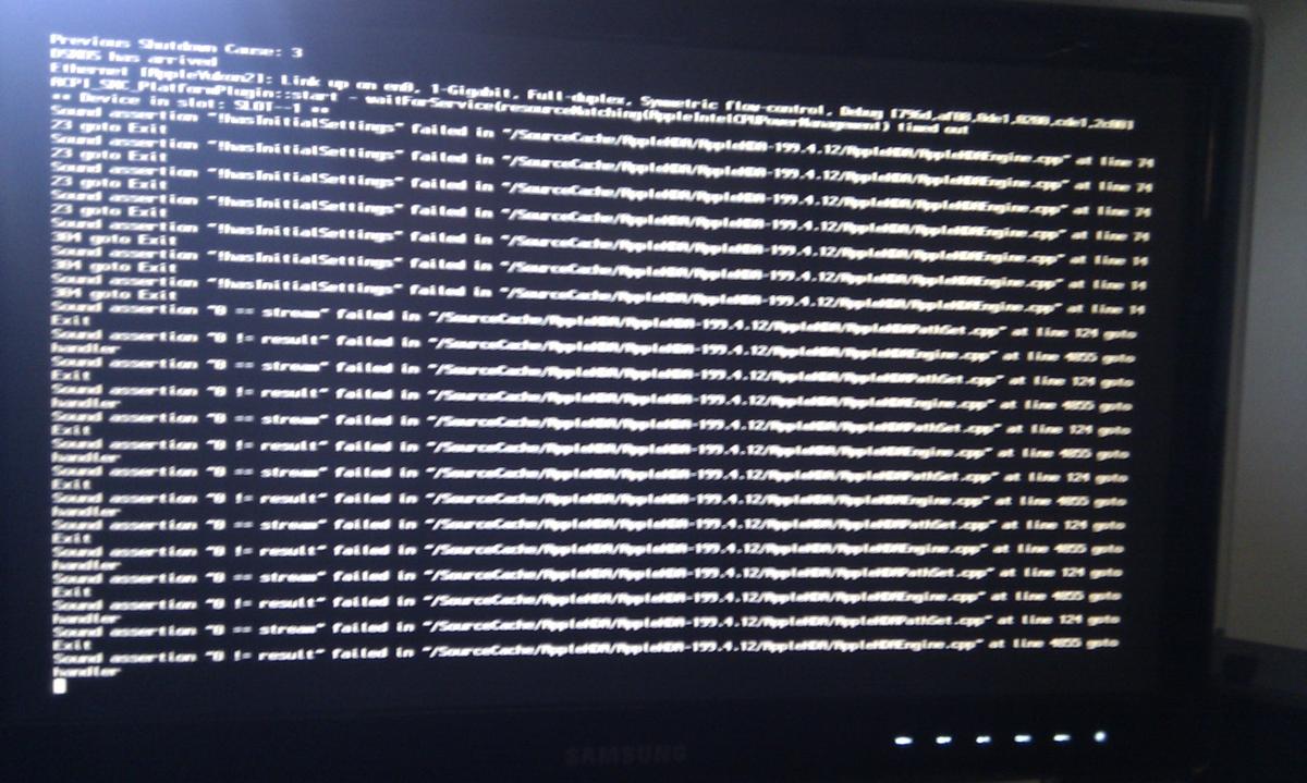

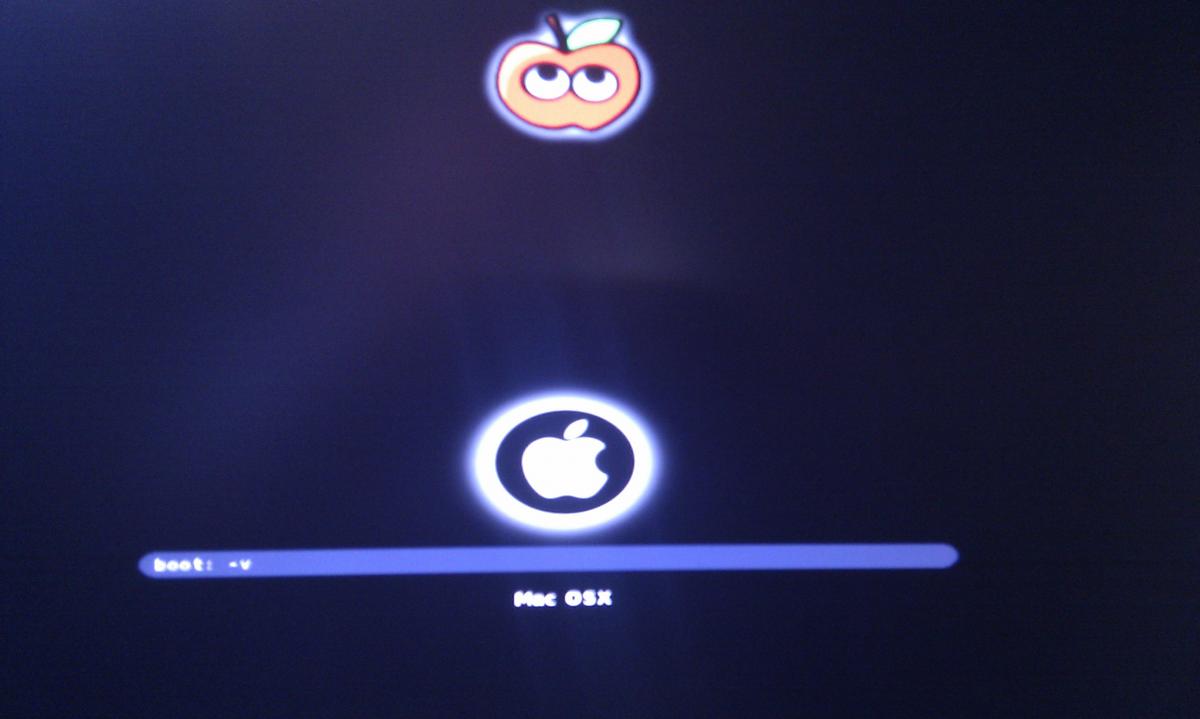

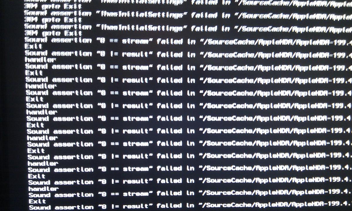

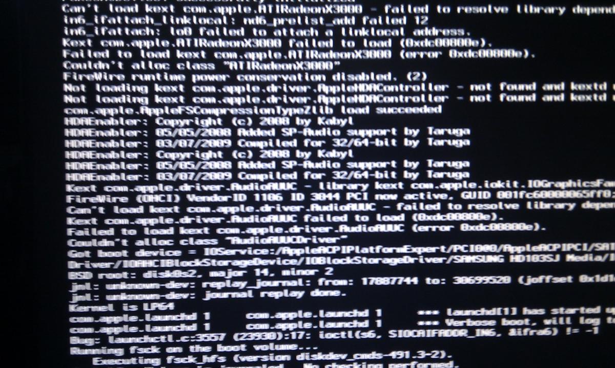

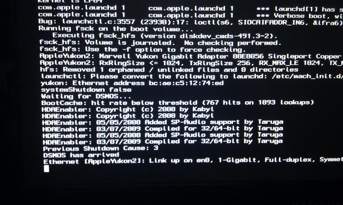

syntax1993 Posted May 28, 2012 Share Posted May 28, 2012 When following this guide I've been able to install OSX, get the 10.6.4 update working and boot without ######. Getting to step 10 worked. I installed update 10.6.5 but after installing, when rebooting, my PC got stuck on booting (Apple logo & circle loading thing). I added -v to check for any errors: Got these: Didn't think these were harmful Until this showed up: Zoomed out: This is where it froze. Does nothing more after this. I've followed up the guide step by step. Used a burned ###### (latest version), made a bootable 8GB flash drive using TransMac on Windows. Plugged in: - HDD to install on - DVD-RW - One HD6950 (I had 2 in Xfire) - USB with Leopard - Mouse (Logitech G5 - USB) - Keyboard (Logitech Wave - USB) - Samsung P2270 Monitor (DVI) - Ethernet cable Unplugged all the rest Specs: Asus P6X58D-E Intel i7 960 3.20Ghz Sapphire HD6950 I hope I explained it well enough & I'd love to hear some suggestions from your side. Thanks a lot! Syntax1993 Link to comment https://www.insanelymac.com/forum/topic/279371-boot-freeze-after-1065-update/ Share on other sites More sharing options...

rlf Posted May 28, 2012 Share Posted May 28, 2012 In the 3rd picture, see the next to last line "DSMOS has arrived"? That means you are booted but your video is blocking you from reaching the Desktop. The Radeon 6950 is not supported by current versions of Mac OS X but will be supported by Mountain Lion 10.8! So there is something you can do to get booted to the Desktop, it's just that your video won't be very good. Now Netkas has published some kexts that give you some video advantage in Lion 10.7.2+ http://netkas.org/?p=1004. But for full support, you must wait a couple more months for Mountain Lion. To get booted now, we are going to move the drivers out of the way and back them up in a folder. Boot in single user mode -s This will be a text environment with a command line. Wait for the prompt "root:' and then type: mount -uw / cd /System/Library touch Extensions cd Extensions mkdir VidBack mv ATI* VidBack/ Reboot using -v -f Link to comment https://www.insanelymac.com/forum/topic/279371-boot-freeze-after-1065-update/#findComment-1823371 Share on other sites More sharing options...
