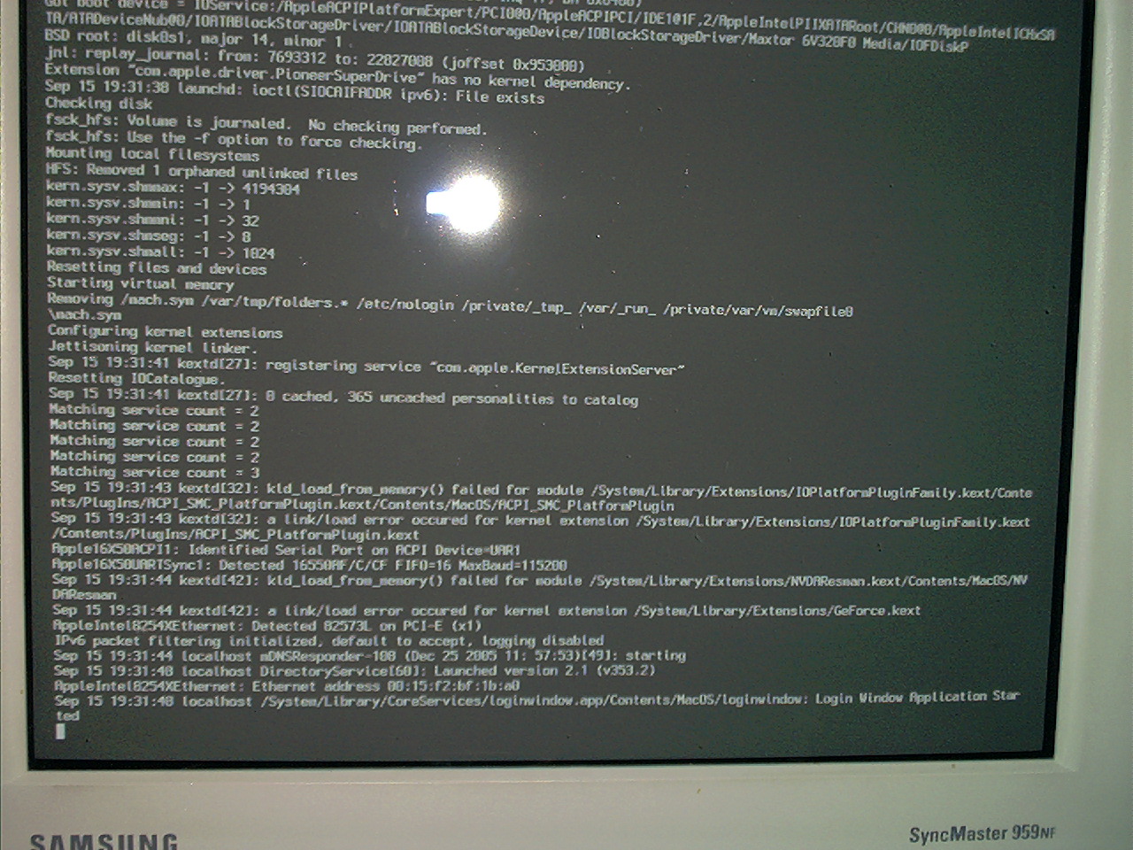

icyderguru Posted September 15, 2006 Share Posted September 15, 2006 Hello, i dont know if its any new or useful but i put the 7300gt from my brothers pro mac into my hackintosh and got the following (look at the attached screen) if this has already been posted or is entirely useless feel free to delete my topic Greetings Link to comment https://www.insanelymac.com/forum/topic/27759-7300gt-pro-mac-gfx-card-in-a-hackintosh/ Share on other sites More sharing options...
Proteo Posted September 15, 2006 Share Posted September 15, 2006 Interesting. Did you copied the kexts and frameworks from the Mac Pro too? If you didn't, you should try it that way... but at least it boots! that's a good thing I guess Link to comment https://www.insanelymac.com/forum/topic/27759-7300gt-pro-mac-gfx-card-in-a-hackintosh/#findComment-189449 Share on other sites More sharing options...
icyderguru Posted September 15, 2006 Author Share Posted September 15, 2006 Interesting. Did you copied the kexts and frameworks from the Mac Pro too? If you didn't, you should try it that way... but at least it boots! that's a good thing I guess No i didnt copy the kexts and frameworks from the Mac Pro to mine. Since i dont want to mess up my main installation i would have to set up a test system but i dont realy know which kexts and which framework is needed. Also, my brother got only this one card so i cant use it all the time, it would be nice if someone could post a complete list of which kexts/frameworks or whatever is needed to try it out. I also read that it is only possible with the 10.4.7 kernel? Maybe someone of the dev guys could have a word to save me some wasted time? Link to comment https://www.insanelymac.com/forum/topic/27759-7300gt-pro-mac-gfx-card-in-a-hackintosh/#findComment-189479 Share on other sites More sharing options...
CoolBits Posted September 16, 2006 Share Posted September 16, 2006 Yeah you need 8.7.2 kernel to run kexts from Mac Pro and only those kexts can run that 7300gt from Mac Pro.. Link to comment https://www.insanelymac.com/forum/topic/27759-7300gt-pro-mac-gfx-card-in-a-hackintosh/#findComment-189740 Share on other sites More sharing options...
codec Posted September 26, 2006 Share Posted September 26, 2006 same problem with 7300GT, but it's happened, when U install macvidia 2.1 or 2.2. With macvidia 1.08 I havent problems and everything works fine try to remove driver and install again (if U havent installed macvidia driver - I don't know what can I help U) Link to comment https://www.insanelymac.com/forum/topic/27759-7300gt-pro-mac-gfx-card-in-a-hackintosh/#findComment-196126 Share on other sites More sharing options...
