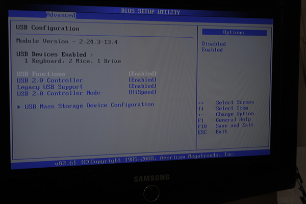

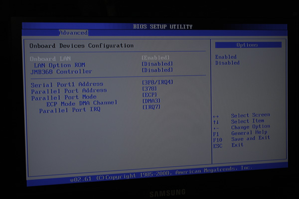

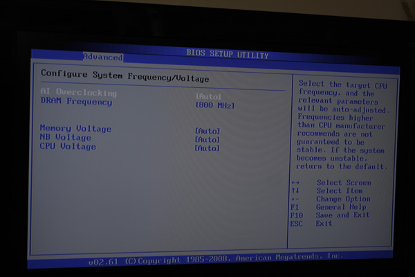

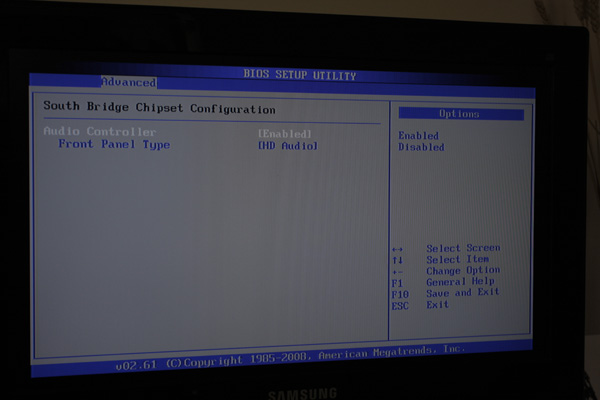

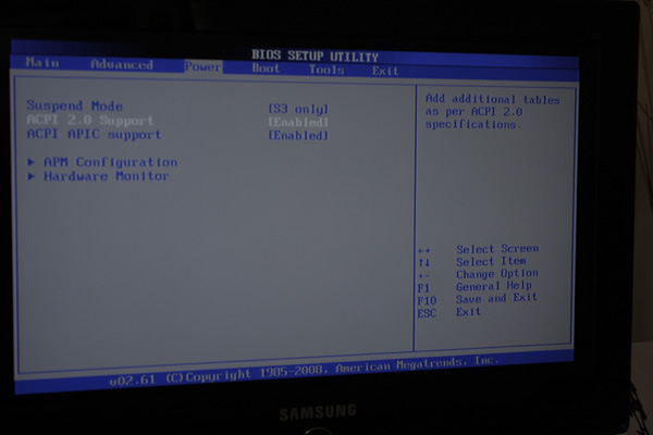

Fabio1971 Posted April 2, 2012 Share Posted April 2, 2012 mhmh!! fammi vedere le impostazioni da bios Link to comment https://www.insanelymac.com/forum/topic/277223-aiuto-progetto-super-mini-htpcmacserver/page/3/#findComment-1810371 Share on other sites More sharing options...

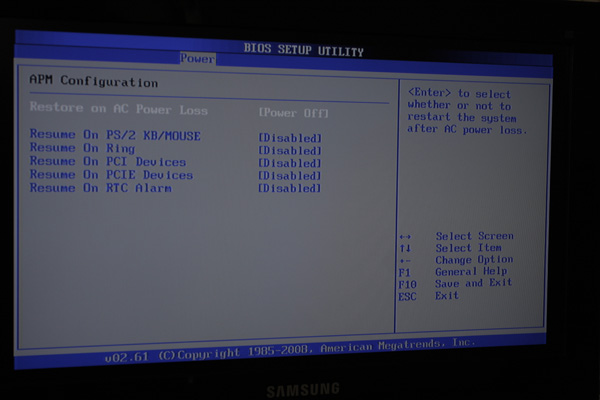

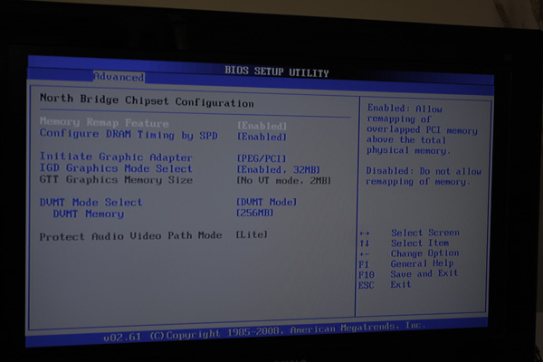

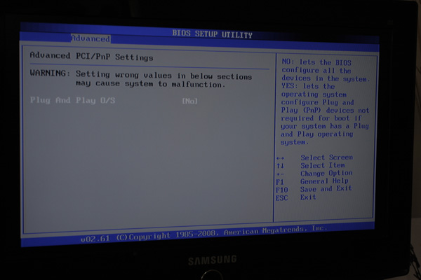

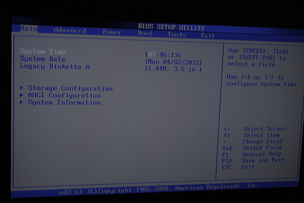

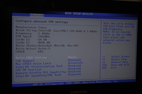

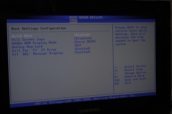

anik101 Posted April 2, 2012 Author Share Posted April 2, 2012 mhmh!! fammi vedere le impostazioni da bios eccolo ggggraaaziiiie Link to comment https://www.insanelymac.com/forum/topic/277223-aiuto-progetto-super-mini-htpcmacserver/page/3/#findComment-1810376 Share on other sites More sharing options...
Fabio1971 Posted April 2, 2012 Share Posted April 2, 2012 se non mi sbaglio la tua scheda a la video integrata disabilita da bios Link to comment https://www.insanelymac.com/forum/topic/277223-aiuto-progetto-super-mini-htpcmacserver/page/3/#findComment-1810380 Share on other sites More sharing options...
anik101 Posted April 2, 2012 Author Share Posted April 2, 2012 se non mi sbaglio la tua scheda a la video integrata disabilita da bios ho disabilitato "IGD graphics mode select" ho fatto bene? comunque niente di nuovo solo una risoluzione..... Link to comment https://www.insanelymac.com/forum/topic/277223-aiuto-progetto-super-mini-htpcmacserver/page/3/#findComment-1810383 Share on other sites More sharing options...
