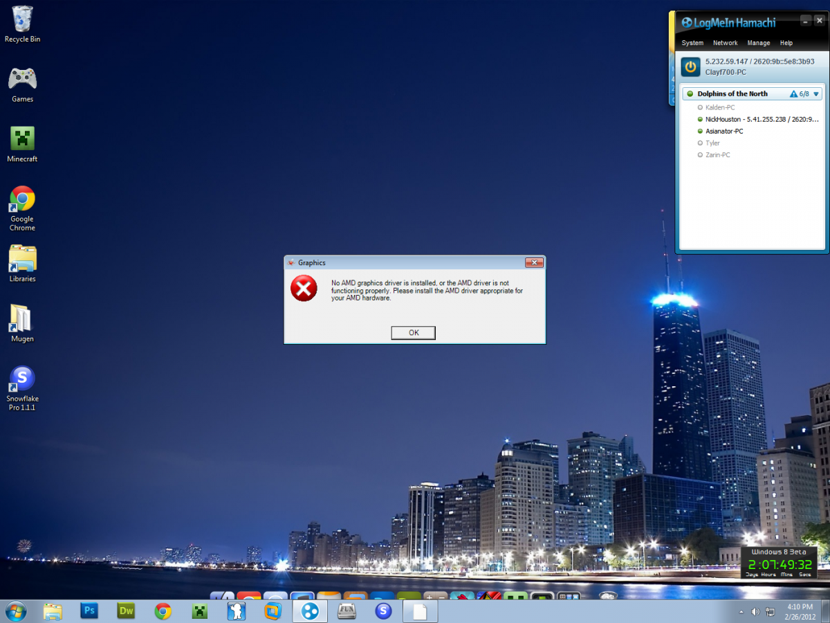

Clayf700 Posted February 26, 2012 Share Posted February 26, 2012 Hey guys, The last time I flashed my video card from Radeon HD6770 to HD5770, It worked great on Snow Leopard. But not so much the same on Windows 7, It goes to a terrible resolution and disables aero. My assumption, is that Windows 7 stopped recognizing the video card. Does anyone know how to get it working for both Operating systems? My theory is if I do this: Then it will work for both? Link to comment https://www.insanelymac.com/forum/topic/276468-flashing-radeon-hd6770-to-hd5770/ Share on other sites More sharing options...
fantomas Posted February 26, 2012 Share Posted February 26, 2012 Hi no, this is what is causing your problem on Windows ! I had the same trouble ! http://www.insanelymac.com/forum/index.php?showtopic=261483&view=findpost&p=1791236 1 Link to comment https://www.insanelymac.com/forum/topic/276468-flashing-radeon-hd6770-to-hd5770/#findComment-1801014 Share on other sites More sharing options...
Clayf700 Posted February 26, 2012 Author Share Posted February 26, 2012 Hi no, this is what is causing your problem on Windows ! I had the same trouble ! http://www.insanelym...dpost&p=1791236 Since I am AMD, I'm stuck on snow leopard. Is it possible to do this with only snow leopard? My Plan: keep the vendor on default and change the Videocard ID to HD6770 Link to comment https://www.insanelymac.com/forum/topic/276468-flashing-radeon-hd6770-to-hd5770/#findComment-1801018 Share on other sites More sharing options...
fantomas Posted February 26, 2012 Share Posted February 26, 2012 to 6770 or 5770 ? if to 5770, yes, you can ! http://www.insanelym...dpost&p=1790274 my flashed 6770 into 5770 work fine on 10.6.8/10.7.3/10.8 without any patched kext. on Seven x64 works fine too ! 1 Link to comment https://www.insanelymac.com/forum/topic/276468-flashing-radeon-hd6770-to-hd5770/#findComment-1801039 Share on other sites More sharing options...
Clayf700 Posted February 27, 2012 Author Share Posted February 27, 2012 to 6770 or 5770 ? if to 5770, yes, you can ! http://www.insanelym...dpost&p=1790274 my flashed 6770 into 5770 work fine on 10.6.8/10.7.3/10.8 without any patched kext. Okay, I kept everything the same except for the Video ID, which I changed to HD5570, and when I reset my machine I got an error message do I need to install the drivers and that's it? Link to comment https://www.insanelymac.com/forum/topic/276468-flashing-radeon-hd6770-to-hd5770/#findComment-1801050 Share on other sites More sharing options...
fantomas Posted February 27, 2012 Share Posted February 27, 2012 Personally, I didn't have need to install any driver, since I already had the latest version of Catalyst. (i'm on seven x64) In your case, you can optionally install it. Link to comment https://www.insanelymac.com/forum/topic/276468-flashing-radeon-hd6770-to-hd5770/#findComment-1801120 Share on other sites More sharing options...
