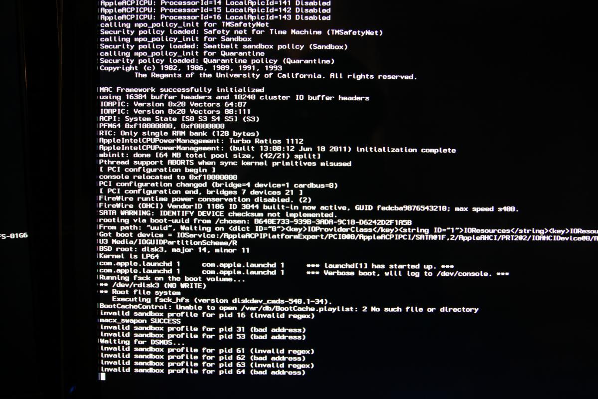

rjosxasus Posted February 20, 2012 Share Posted February 20, 2012 hello all, I just updated from 10.7.2 to 10.7.3 via combo update. Upon restart I cannot boot, and I'm getting this message: Invalid sandbox profile for pid 16 (invalid regex) The message repeats every few seconds, counting up 1 by one forever... see the attached image for clarification. I am running in RAID 0 and haven't had this error before in previous updates. thanks for any ideas. Link to comment https://www.insanelymac.com/forum/topic/276186-raid-0-1073-err-unable-to-open-vardbbootcacheplaylist/ Share on other sites More sharing options...

rjosxasus Posted February 23, 2012 Author Share Posted February 23, 2012 Thank you for the suggestion, Fienx. I tried this, but when i restarted, I get the same errors. I've also tried restoring the Sandbox.kext from 10.7.2, and bootcache.kext. with no luck. Link to comment https://www.insanelymac.com/forum/topic/276186-raid-0-1073-err-unable-to-open-vardbbootcacheplaylist/#findComment-1799697 Share on other sites More sharing options...
rjosxasus Posted February 26, 2012 Author Share Posted February 26, 2012 the problem seems to be that is cannot find the bootcache.playlist. I'm getting BootCacheControl: Unable to open /var/db/BootCache.playlist I have tried the following: -installing the bootcache.kext and sandbox.kext from a working 10.7.2 (did not work) -booting from a backup image, and repairing permissions on the raid volume with Kext Wizard -attempting this bootcachecontrol -f /var/db/bootcache.playlist generate /dev/rdisk0s3 but i get an error saying it cannot find the UUID -in terminal, single user, "chmod -N -R /Volumes" -in disk utility (of the backup image) I tried to verify and repair permissions on the Raid volume, but when i click each button, nothing happens, no progress or anything. anyone with other ideas? thank you Link to comment https://www.insanelymac.com/forum/topic/276186-raid-0-1073-err-unable-to-open-vardbbootcacheplaylist/#findComment-1800853 Share on other sites More sharing options...
