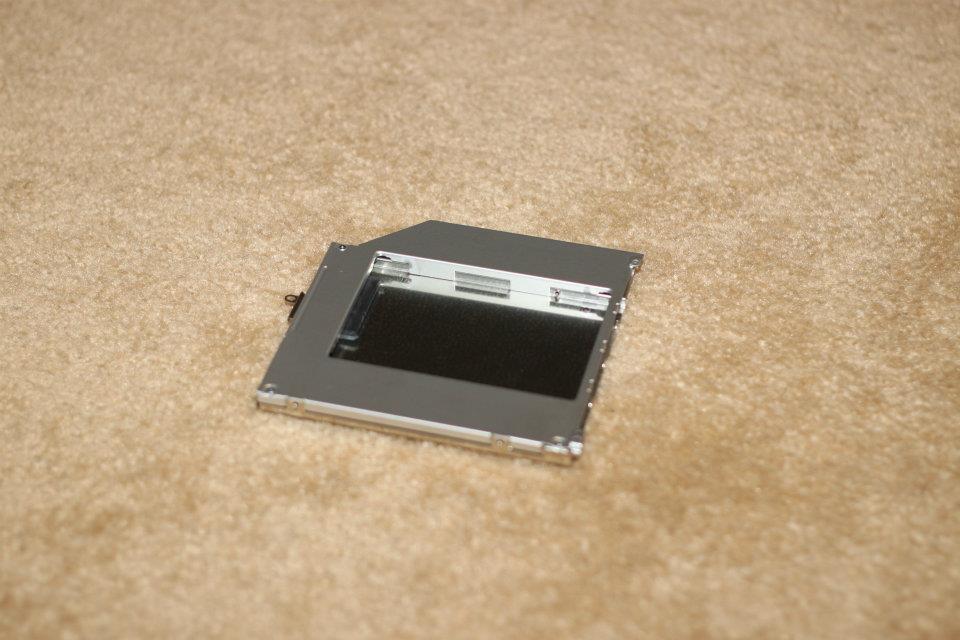

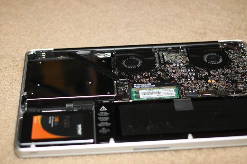

vboyz Posted February 11, 2012 Share Posted February 11, 2012 So I did this and now I have: 1. 120gb Patriot Pyro SSD - primary OS drive 2. 500gb Seagate Momentus XT Hybrid drive - secondary drive 3. Superdrive or optical or CDROM is now GONE - external enclosure on my Macbook Pro mid-2011 model. You need to get this caddy: http://www.newmodeus...products_id=410 The above caddy is the cheapest with good build quality and good for heat dissipation. There is another model named OWC Data Doubler (http://eshop.macsale...ting/DDAMBS0GB/) but I didn't like it because more expensive and made out of plastic, seems flimsy and breakable. Anyway, get one of the caddy and youtube how to replace the superdrive: Voila! Now you have ample of storage space in your MbP. My lappy is flying with all these storage and SSD. I'm loving it. Edit: See screenshot for my final product. Link to comment https://www.insanelymac.com/forum/topic/275764-mini-how-to-put-2nd-hard-drive-in-place-of-optical/ Share on other sites More sharing options...
missingsteve Posted February 11, 2012 Share Posted February 11, 2012 Thank you for your experience. I will make just two important remarks: OWC Data Doubler is made of metal. Additional disk if it is HDD, should be set in place instead of the main SSD. So the SSD-drive should be mounted in the caddy. It's all about - a sudden motion sensor, which is very important for the proper operation of the HDD in a shaking or falling. Link to comment https://www.insanelymac.com/forum/topic/275764-mini-how-to-put-2nd-hard-drive-in-place-of-optical/#findComment-1795341 Share on other sites More sharing options...
ct963 Posted April 15, 2012 Share Posted April 15, 2012 i also removed my disc drive and placed a ssd with a caddy, its best to use the ssd in the caddy in my experience due to no moving parts and heat,its worth it though, my mac 2.26duo boots in 15 seconds, Link to comment https://www.insanelymac.com/forum/topic/275764-mini-how-to-put-2nd-hard-drive-in-place-of-optical/#findComment-1813747 Share on other sites More sharing options...
