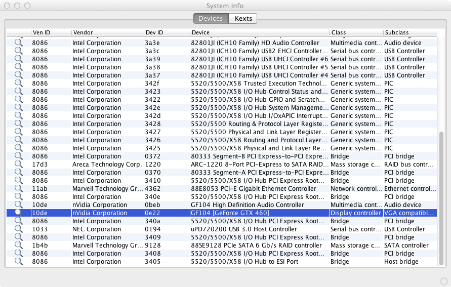

2. Run System Info and search your GPU. Remember "Ven ID" and "Dev ID".
In my case the values are: VenID: 10de | Dev ID: 0e22

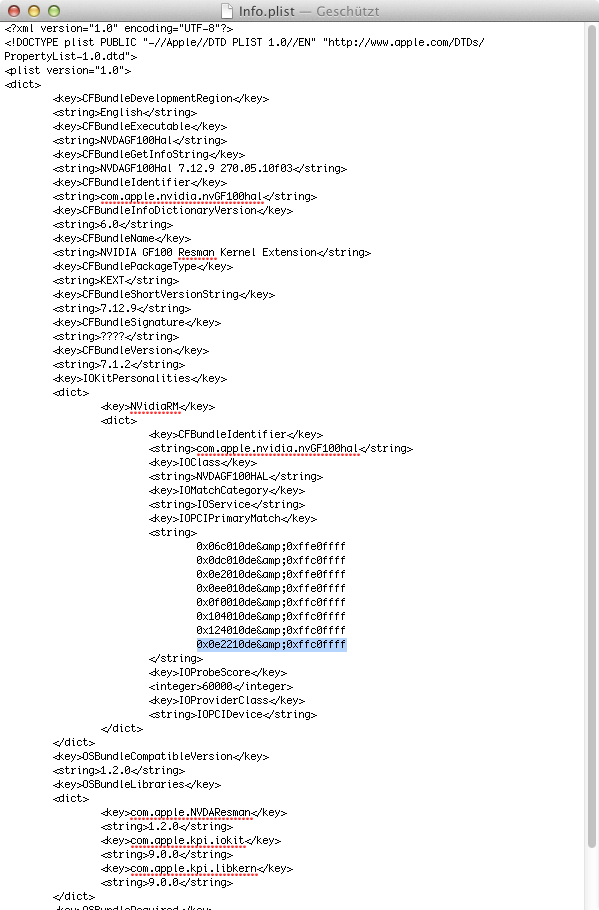

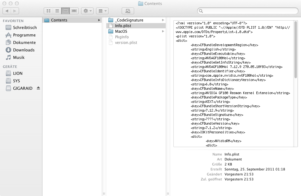

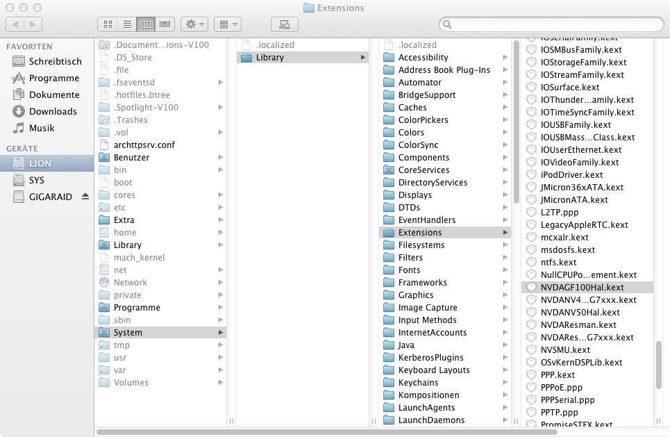

4. Search the file NVDAGF100Hal.kext in System/Libary/Extensions, right click on it and select "Show content". Drag n Drop the Info.plist to your desktop and open the copy with TextEdit.
post-646704-0-66154100-1328371620_thumb.jpegpost-646704-0-44379700-1328371618_thumb.jpeg
5. Now you have to add your GPU's "Ven ID" and "Dev ID" to the string area of IOPCIPrimaryMatch. Just make a new entry below the last one. The entry has to look like this:
0xDevIDVenID&0xffc0ffff
Save the Info.plist and Drag n Drop it back to it's kext and overwrite the original one. Lion will ask for an authentication and your password. Go for it!

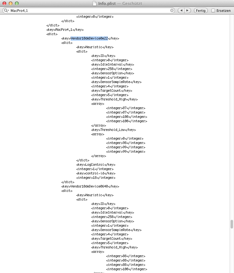

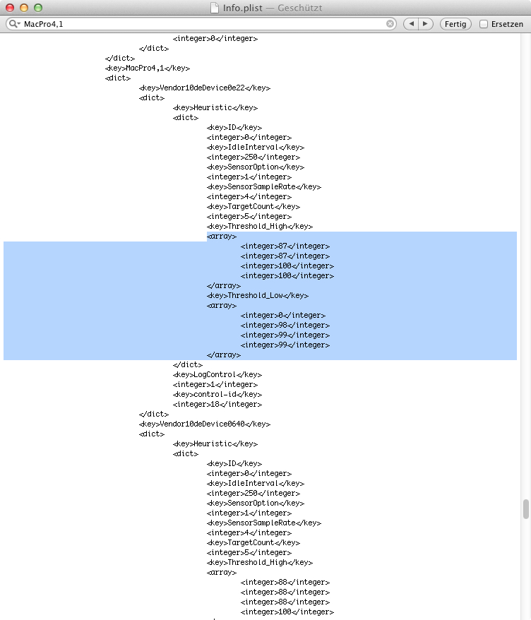

6. Search the File AppleGraphicsPowerManagment.kext in System/Libary/Extensions.
Right click -> Show Content -> Drag n Drop the Info.plist to Desktop -> Open with TextEdit -> In case you are using a MacPro4,1 smbios, search for MacPro4,1. Replace Vendor and Device ID with your values.
<key>VendorVenIDDeviceDevID</key>
Below look for Threshold_High. Edit the entrys like this:
7. Save the file, Drag n Drop it back to AppleGraphicsPowerManagment.kext and overwrite the old one.
