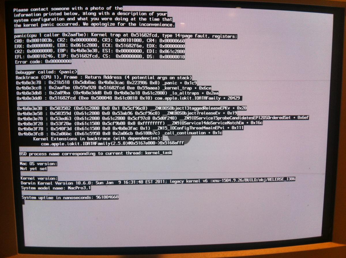

refinery Posted July 4, 2012 Share Posted July 4, 2012 ive been trying for days to get this to work. no matter what, i almost always get a KP on IOATAFamily... i tried removing it from the extensions but then it wont even see the hard drive. sometimes by booting through safe mode i can get past the problem and install OSX, but when i use ###### after the initial install, it either goes into a reboot loop, or it still crashes at the IOATAFamily extension. i would love to get this working. anybody got any tips? I have followed this tutorial *to the letter* and i also used a different distro and had pretty much exactly the same problems, or it would hang in verbose mode after "systemshutdown false" GX620 w/ 3.4ghz Pentium D 4GB RAM 1TB HD Asus DVDRW Asus 8400GS Silent thanks! the two errors i keep getting. please let me know if i need to post more info about my setup. oh, and the only things i have changed in BIOS were to turn off the floppy drive, SATA mode to "combination" and I had to disable "SERR DMI" mode otherwise it wouldnt even get to the bootloader screen. Link to comment https://www.insanelymac.com/forum/topic/275293-guide-1068-on-a-dell-optiplex-gx620/page/2/#findComment-1831254 Share on other sites More sharing options...
Cerastez Posted July 4, 2012 Author Share Posted July 4, 2012 Asus 8400GS Silent Try removing your video card and use the built in video for the installation. Link to comment https://www.insanelymac.com/forum/topic/275293-guide-1068-on-a-dell-optiplex-gx620/page/2/#findComment-1831262 Share on other sites More sharing options...
LatinMcG Posted July 5, 2012 Share Posted July 5, 2012 old voodoohda and u need to patch the ide controler in dsdt for "ioataFamilly panic fix" < google it Link to comment https://www.insanelymac.com/forum/topic/275293-guide-1068-on-a-dell-optiplex-gx620/page/2/#findComment-1831286 Share on other sites More sharing options...

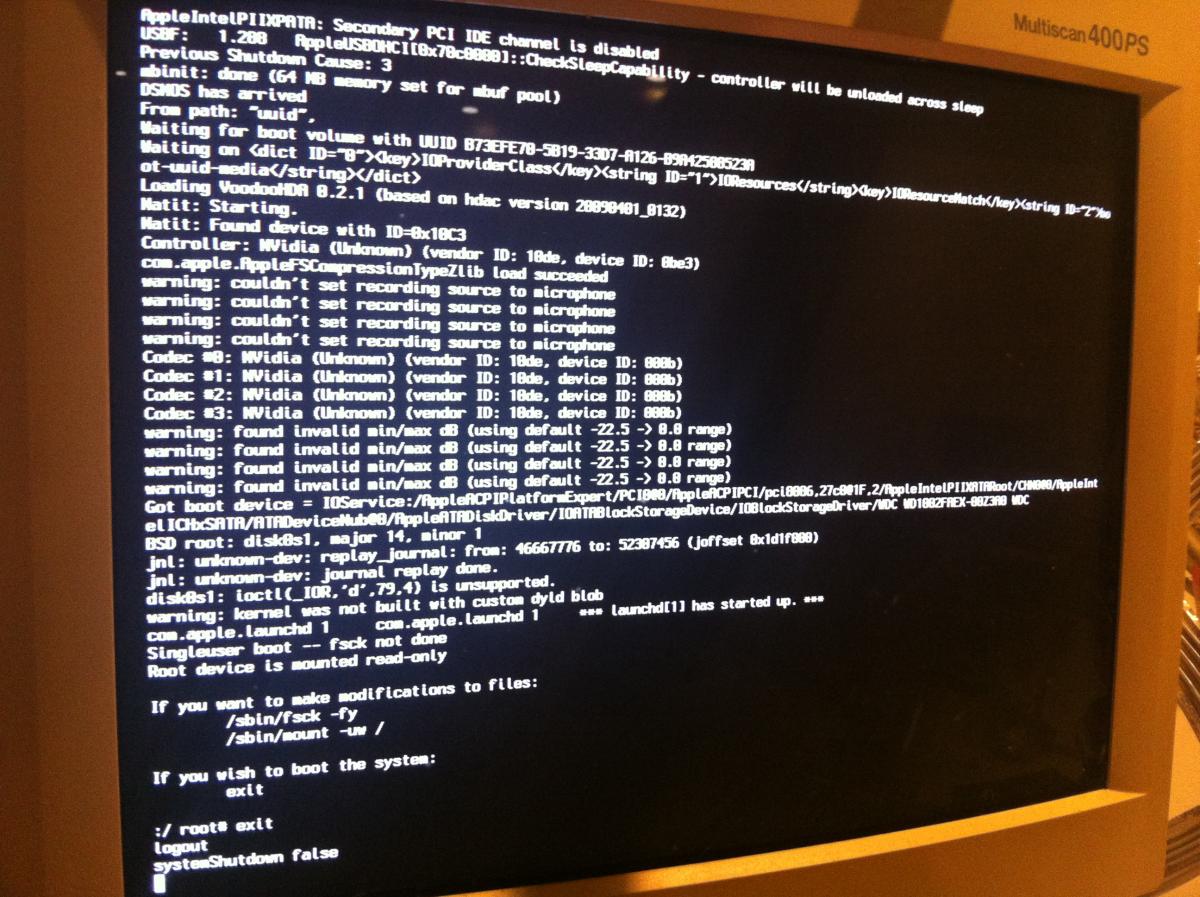

refinery Posted July 6, 2012 Share Posted July 6, 2012 Cerastez - tried that, i get the same errors in the same places. i ended up trying using the nawcom boot cd and was able to get a lot further into the process, but hitting another roadblock. I'm able to get all the way to the part of installing the 10.6.8 combo updater, but without fail, the installer fails with an error about the install failed, contact the manufacturer for details. Ive run repair permissions several times before running this, but it keeps failing at the same point. ive included the console error output: Jul 6 00:24:51 Macintosh installd[253]: Deferred path /usr/bin/mdcheckschema is not in sandbox and will be skipped. Jul 6 00:24:51 Macintosh installd[253]: PackageKit: Shoving /var/folders/zz/zzzivhrRnAmviuee+++++++++++/-Tmp-/PKInstallSandbox-tmp/Root (9 items) to / Jul 6 00:25:10 Macintosh /System/Library/PrivateFrameworks/PackageKit.framework/Resources/shove[281]: Cross device symlink found in shove path, including /private/etc Jul 6 00:25:10 Macintosh /System/Library/PrivateFrameworks/PackageKit.framework/Resources/shove[281]: [source=file] failed _RelinkFile(/var/folders/zz/zzzivhrRnAmviuee+++++++++++/-Tmp-/PKInstallSandbox-tmp/Root/private/etc/php.ini.default, /private/etc/php.ini.default): Directory not empty Jul 6 00:25:11 Macintosh installd[253]: PackageKit: Install Failed: (null)\nError Domain=PKInstallErrorDomain Code=120 UserInfo=0x3426280 "An unexpected error occurred while moving files to the final destination." Underlying Error=(Error Domain=NSPOSIXErrorDomain Code=66 "The operation couldn’t be completed. Directory not empty") {\n NSLocalizedDescription = "An unexpected error occurred while moving files to the final destination.";\n NSUnderlyingError = "Error Domain=NSPOSIXErrorDomain Code=66 \"The operation couldn\U2019t be completed. Directory not empty\"";\n arguments = (\n "-f",\n "-s",\n "/var/folders/zz/zzzivhrRnAmviuee+++++++++++/-Tmp-/PKInstallSandbox-tmp/Root",\n "/"\n );\n} Jul 6 00:25:11 Macintosh Installer[206]: install:didFailWithError:Error Domain=PKInstallErrorDomain Code=120 UserInfo=0xbb8fc10 "An unexpected error occurred while moving files to the final destination." Underlying Error=(Error Domain=NSPOSIXErrorDomain Code=66 "The operation couldn’t be completed. Directory not empty") Jul 6 00:25:11 Macintosh Installer[206]: Install failed: The Installer encountered an error that caused the installation to fail. Contact the software manufacturer for assistance. Jul 6 00:25:12 Macintosh Installer[206]: Entering Summary section Jul 6 00:25:12 Macintosh Installer[206]: Physical Memory Allocation: 301 MB wired, 771 MB trapped, 338 MB active, 371 MB inactive, 2315 MB free, 3024 MB usable, 4096 MB total Jul 6 00:25:12 Macintosh Installer[206]: IFDInstallController 185850 state = 7 Jul 6 00:25:12 Macintosh Installer[206]: Displaying 'Install Failed' UI. Jul 6 00:25:12 Macintosh Installer[206]: 'Install Failed' UI displayed message:'The Installer encountered an error that caused the installation to fail. Contact the software manufacturer for assistance.'. does anyone have any suggestions for how i might get past this? it seems like im so close at this point. i tried using pacifist to install the combo update, but that just made the system unstable and then it wouldnt barely get past the bootloader the next time around before hard KPing. ive made a disk image of the system so i can at least quickly get back to the point of right before the 10.6.8 update is run in case i break something, so feel free to suggest anything. Link to comment https://www.insanelymac.com/forum/topic/275293-guide-1068-on-a-dell-optiplex-gx620/page/2/#findComment-1831547 Share on other sites More sharing options...
LatinMcG Posted July 6, 2012 Share Posted July 6, 2012 dsdt device (PCI0) missing _UID, 0x00 or its wrong 0x04 ? Link to comment https://www.insanelymac.com/forum/topic/275293-guide-1068-on-a-dell-optiplex-gx620/page/2/#findComment-1831587 Share on other sites More sharing options...
Cerastez Posted July 6, 2012 Author Share Posted July 6, 2012 Cerastez - tried that, i get the same errors in the same places. i ended up trying using the nawcom boot cd and was able to get a lot further into the process, but hitting another roadblock. I'm able to get all the way to the part of installing the 10.6.8 combo updater, but without fail, the installer fails with an error about the install failed, contact the manufacturer for details. Ive run repair permissions several times before running this, but it keeps failing at the same point. ive included the console error output: does anyone have any suggestions for how i might get past this? it seems like im so close at this point. i tried using pacifist to install the combo update, but that just made the system unstable and then it wouldnt barely get past the bootloader the next time around before hard KPing. ive made a disk image of the system so i can at least quickly get back to the point of right before the 10.6.8 update is run in case i break something, so feel free to suggest anything. I don't actually know what might be causing this, so I am just going to throw out some random ideas. Take out some of your RAM so that you are under 4GB Re-download the 10.6.8 update. I had been using the same copy for ages and it suddenly stopped working. Apple actually built an expiration date into it! Copy the updater to your hard drive, don't install from a CD or flash drive. If you have a spare hard drive laying around, install 10.6.3 on to it. Boot off your spare hard drive and run the 10.6.8 updater. Select the other hard drive, the one you are not booting off of, and install onto it. Hope that helps Link to comment https://www.insanelymac.com/forum/topic/275293-guide-1068-on-a-dell-optiplex-gx620/page/2/#findComment-1831609 Share on other sites More sharing options...

refinery Posted July 7, 2012 Share Posted July 7, 2012 ok guys, just wanted to give an update. turns out i was using a 10.6.0 iso and not a 10.6.3. I got my hands on 10.6.3 and was able to install successfully. I did have to switch from myHack to Chameleon bootloader, because the system refused to boot unless i used the npci=0x2000 fix. myHack didnt seem to offer any way of specifying that in the bootloader, and it seems like myhack is directly using chameleon now anyway on their newer packages... anyway, Once i did that, it worked fine and i have a bootable system with 10.6.8. however, im still having two issues: 1. audio is not recognized or working (i did install both kexts correctly - ethernet is working fine after the MAC address fix) 2. my video card, while recognized, is not showing any resolutions outside the one specified in the boot.plist. (i understand that's outside the scope of this article)... it shows it as 8400GS, nvidia, even includes the ROM revision... but no other resolutions besides 1028x768... any suggestions on how to fix those two? thanks again for the help!!! this is going great now, just need to fix those two issues and i should be set. Link to comment https://www.insanelymac.com/forum/topic/275293-guide-1068-on-a-dell-optiplex-gx620/page/2/#findComment-1831677 Share on other sites More sharing options...

LatinMcG Posted July 7, 2012 Share Posted July 7, 2012 ok guys, just wanted to give an update. turns out i was using a 10.6.0 iso and not a 10.6.3. I got my hands on 10.6.3 and was able to install successfully. I did have to switch from myHack to Chameleon bootloader, because the system refused to boot unless i used the npci=0x2000 fix. myHack didnt seem to offer any way of specifying that in the bootloader, and it seems like myhack is directly using chameleon now anyway on their newer packages... anyway, Once i did that, it worked fine and i have a bootable system with 10.6.8. however, im still having two issues: 1. audio is not recognized or working (i did install both kexts correctly - ethernet is working fine after the MAC address fix) 2. my video card, while recognized, is not showing any resolutions outside the one specified in the boot.plist. (i understand that's outside the scope of this article)... it shows it as 8400GS, nvidia, even includes the ROM revision... but no other resolutions besides 1028x768... any suggestions on how to fix those two? thanks again for the help!!! this is going great now, just need to fix those two issues and i should be set. i bet device id is 103c .. add it to the info.plist of nvda Link to comment https://www.insanelymac.com/forum/topic/275293-guide-1068-on-a-dell-optiplex-gx620/page/2/#findComment-1831751 Share on other sites More sharing options...
refinery Posted July 8, 2012 Share Posted July 8, 2012 can anybody point me in the way of a clear tutorial on how to do add that to the plist? ive been searching and all the methods that ive found are described very poorly or key details missing. oh and i did get audio working. just installed cerastez' patch again and it started working. weird. Link to comment https://www.insanelymac.com/forum/topic/275293-guide-1068-on-a-dell-optiplex-gx620/page/2/#findComment-1831979 Share on other sites More sharing options...
refinery Posted July 9, 2012 Share Posted July 9, 2012 ok through a lot of experimentation, downloads and various attempts, i was able to get the graphics card working with the card code added to my boot.plist under device_properties and some other hacks. if there's one thing i can share from this experience - make sure you are using a 10.6.3 installation and not a 10.6.0. 10.6.0 wont work. Link to comment https://www.insanelymac.com/forum/topic/275293-guide-1068-on-a-dell-optiplex-gx620/page/2/#findComment-1832054 Share on other sites More sharing options...
