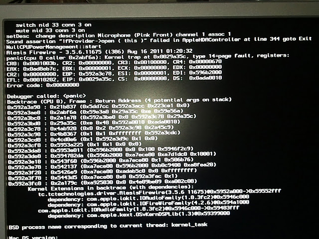

repat Posted January 25, 2012 Share Posted January 25, 2012 I shot myself in the foot, letting updater run the 10.6.8 update. After fixing the SleepEnabler error, I'm also getting an error on the AppleHDAController. I believe this is related to the Alesis FireWire driver that is loaded for my audio mixer. Any help on this would be appreciated. Hardware: Asus P7P55D-E Pro 8GB Memory NV 9500GT using DSDT for this MB Trying to attach a screen pic of errors. Thanks in advance, Pat Link to comment https://www.insanelymac.com/forum/topic/275085-no-boot-after-1068-update-fw-driver-suspected/ Share on other sites More sharing options...
repat Posted January 26, 2012 Author Share Posted January 26, 2012 Deleting the VoodooHDA.kext seemed to do the trick. Sound works fine thru the fw device, thats all I need right now, so another battle for another day. Link to comment https://www.insanelymac.com/forum/topic/275085-no-boot-after-1068-update-fw-driver-suspected/#findComment-1789778 Share on other sites More sharing options...
