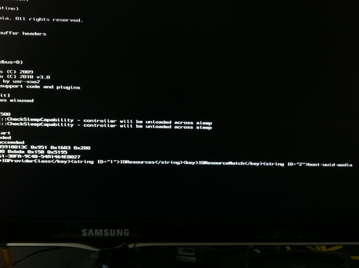

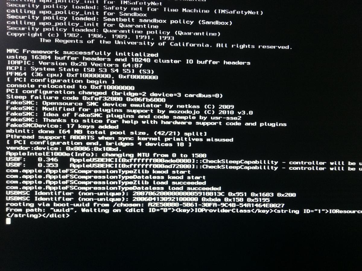

Guilherme Araújo Posted January 24, 2012 Share Posted January 24, 2012 I have a Dell Optiplex 755 (BIOS A21) and I'm having a rough time trying to patch it's DSDT. Whenever I tried, either using a bunch of patches or one at a time, I couldn't boot, always with the error "Still waiting for root device". At last I decided to try with absolutely no patch, just extract, compile and save. Guess what, still have the same error. Now I wonder, is this supposed to happen? I don't think so. Besides, at first compilation there are 4 errors (an dozens of warnings, remarks and optimizations), however DSDT Editor is able to fix these errors. I feel like I'm a dummy on this subject, but I really didn't expect the original DSDT to contain so many errors and warnings. I attached the the extracted DSL file if anyone care to take a look on it. I'm using the latest Chameleon version and I can boot finely if DSDT is disabled. I really look forward to solving this because it might be extremely handful with my "audio via HDMI problem". Original.dsl.zip Link to comment https://www.insanelymac.com/forum/topic/275038-cant-boot-with-dsdt-neither-original-or-patched/ Share on other sites More sharing options...

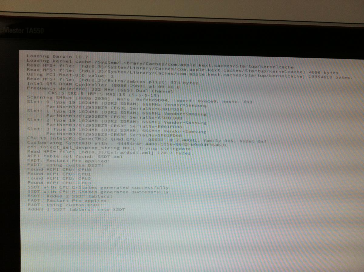

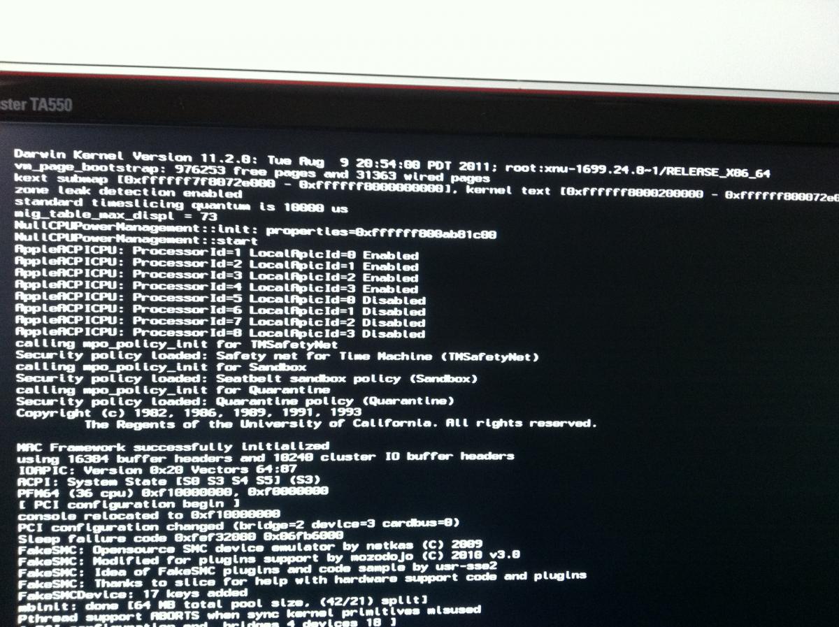

Foxic Posted January 25, 2012 Share Posted January 25, 2012 Try booting with no dsdt, at chameleon enter PCIRootUID=1 -v Post the output Link to comment https://www.insanelymac.com/forum/topic/275038-cant-boot-with-dsdt-neither-original-or-patched/#findComment-1789334 Share on other sites More sharing options...

Foxic Posted January 25, 2012 Share Posted January 25, 2012 Setting the controller to RAID should automatically enable AHCI, so yes enable RAID (but don't setup a RAID array). To post the output, take a photo, unless you can remember an entire screen of jargon accurately Link to comment https://www.insanelymac.com/forum/topic/275038-cant-boot-with-dsdt-neither-original-or-patched/#findComment-1789339 Share on other sites More sharing options...

LatinMcG Posted January 25, 2012 Share Posted January 25, 2012 just the Windows 2001 i see u have usb controler will be unloaded across sleep. EHCI fix. ohh it doesnt have EHCI with address 0x001D0007 or 0x001A0007 the optiplex 745 does have it.. strange! hers a guide http://www.insanelymac.com/forum/index.php?showtopic=255482 Link to comment https://www.insanelymac.com/forum/topic/275038-cant-boot-with-dsdt-neither-original-or-patched/#findComment-1789351 Share on other sites More sharing options...
