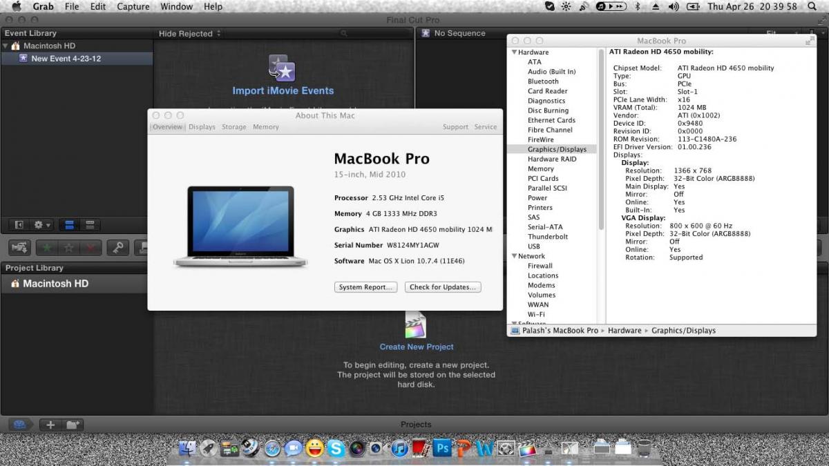

plsh2me Posted April 26, 2012 Share Posted April 26, 2012 11D50 is the same update that Apple today released as final. So these kexts are now official. These drivers are massively enhanced for performance and Apple fixed the garbled graphics after Sleep for "some ATI powered iMacs" - and because these iMacs run the ATI4670 Mobility, the same fixes will work in the Mobility 4650 gpu because they are basically identical. Jan 31, Latest modded Ati Mobility 4650HD kexts : from OSX 10.7.3 FINAL Build 11D50 * can't get this uploaded here.. so this time only available outside of insanelymac ( forgive me, mods ) : http://www.osx86.net...do=file&id=2332 * include modded GraphicsPowermanagement.kexts from 10.7.2 as they are not updated in 10.7.3 use iMac9,1 / 10,1 SMBIOS for native GPU-Energysaver ( then don't use the included AGPM kexts of the pack above , only the ATI kexts and plugins and bundles) or MacBookPro5,1 SMBIOS to activate the Laptop-modded energy-kexts ( recommended if using Core2Duo Laptop ) . ############################################################### Working great on my Laptop , 32/64bit mode; use in 11D42/11D46 OSX 10.7.3 QE/CI with ATY_Init.kext , GraphicsEnabler=NO. DeviceID is 9480 - hexedited for LVDS output, using Ati's Shrike FB ( 1366x768 screen , 15.6 inches ) . Hi, I have updated my OS X on 10.7.4 build 11E46. These kexts are also fully working for 10.7.4. Link to comment https://www.insanelymac.com/forum/topic/274833-ati-4650mobility-lvds-shrike-for-lion-1073-final/#findComment-1816361 Share on other sites More sharing options...
