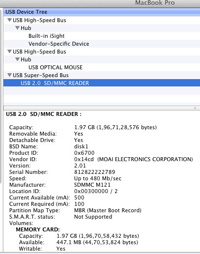

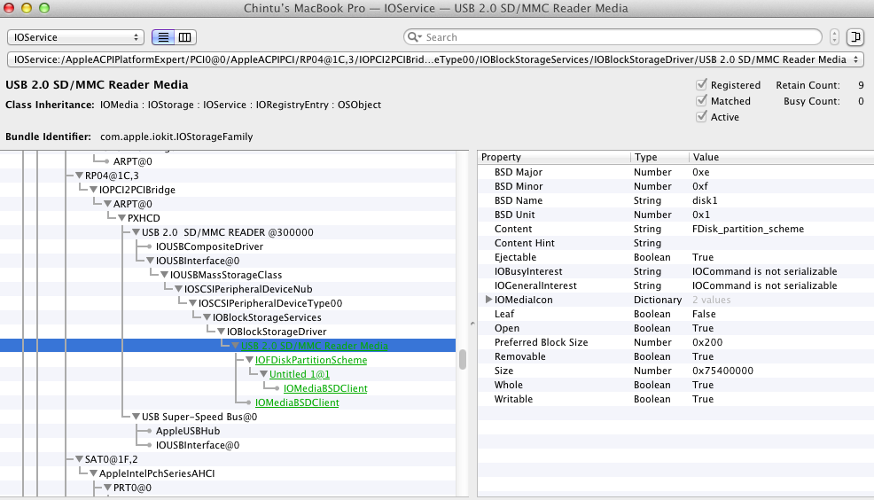

chinmaya__swarup Posted April 27, 2012 Author Share Posted April 27, 2012 @PookyMacMan The devices are being mounted on USB 3 super speed Bus and till the time i am looking in USB EHCI 1c2d controller...!!!! One more problem, the USB2 port is working randomly. Some time it acts normally and USB2 devices are mounted and some doen't work and the system freezes upon plugging a USB2 device. Do you have any idea what is causing the problem..? May be an IRQ conflict....? Link to comment https://www.insanelymac.com/forum/topic/274591-pro-help-required-in-post-installation/#findComment-1816453 Share on other sites More sharing options...

chinmaya__swarup Posted April 30, 2012 Author Share Posted April 30, 2012 still i am not able to understand why it is behaving randomly...? once in 10 attempts a device is being detected.. still trying to understand under what conditions it is working...? it is a USB3 driver problem only......(Renesas USB3). now i am trying to figure-out what condition are making it work. Link to comment https://www.insanelymac.com/forum/topic/274591-pro-help-required-in-post-installation/#findComment-1817074 Share on other sites More sharing options...

chinmaya__swarup Posted May 1, 2012 Author Share Posted May 1, 2012 Update: At last found the working conditions. USB is only working after WAKE from Sleep. Now i am 100% sure it is a DSDT problem and not PXHCD.kext driver problem Link to comment https://www.insanelymac.com/forum/topic/274591-pro-help-required-in-post-installation/#findComment-1817217 Share on other sites More sharing options...
