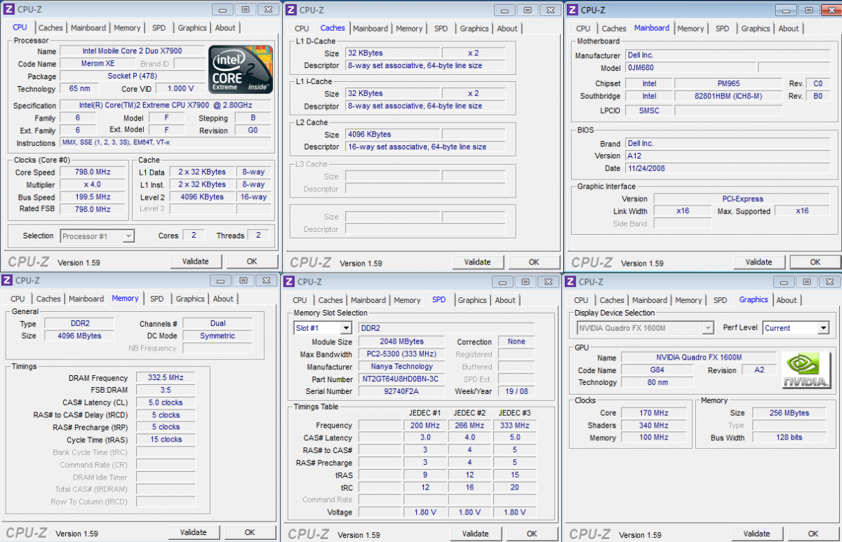

Jongervater Posted December 25, 2011 Share Posted December 25, 2011 He guys I got an old dell precision m6300 and i want to use Lion but it stucks always. I don´t get into installer i have a pic of cpuz i have the intel core2extreme x7900 @ 2,80 ghz (sse 1,2,3,3s) and the mainboard is the intel pm965 i tryed the iatkos lion l2 distri. but i don´t get to the installer it just boot a while with cpus=1 can you help me ? which distri should i take sorry for my bad english Link to comment Share on other sites More sharing options...
