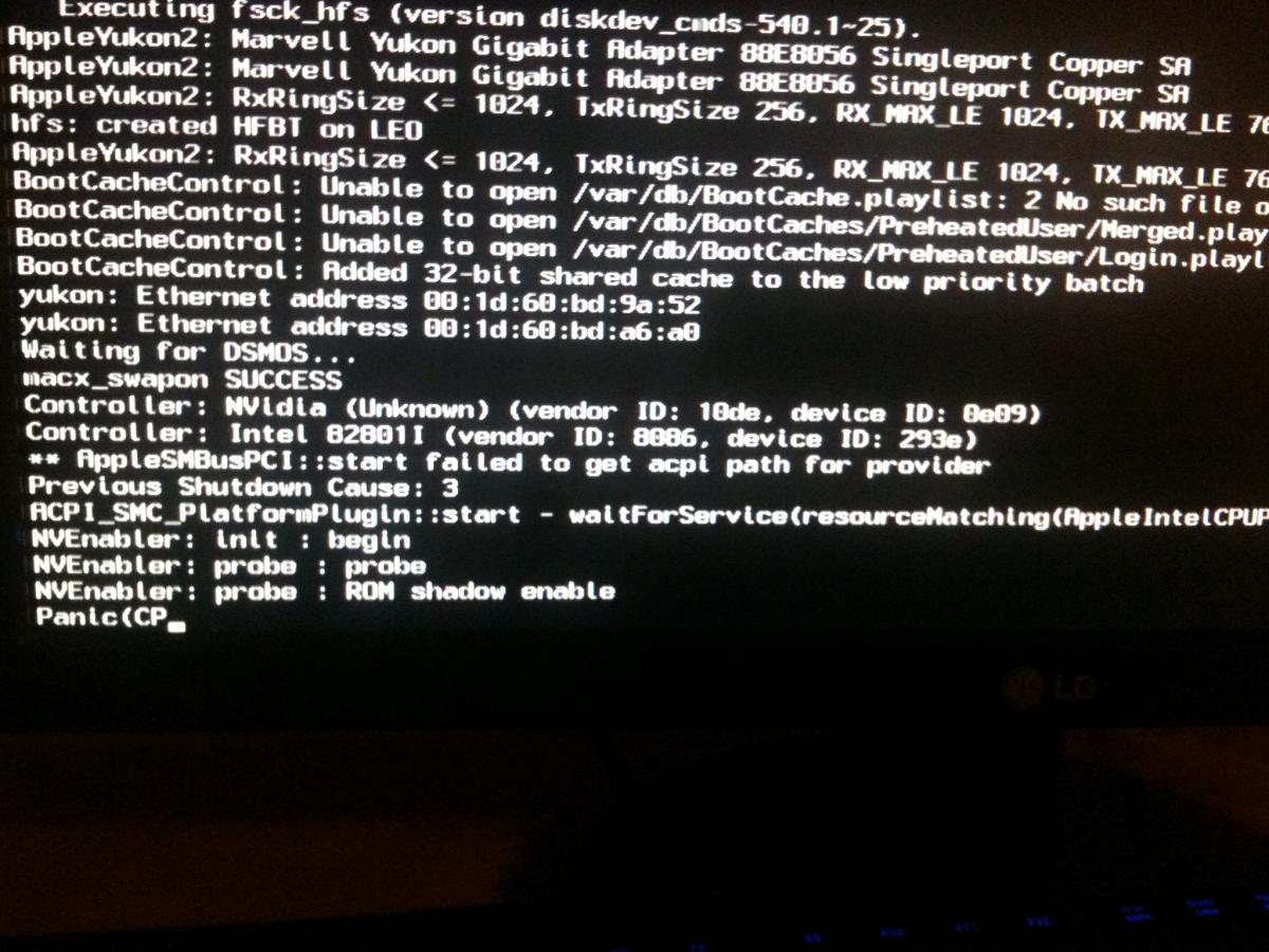

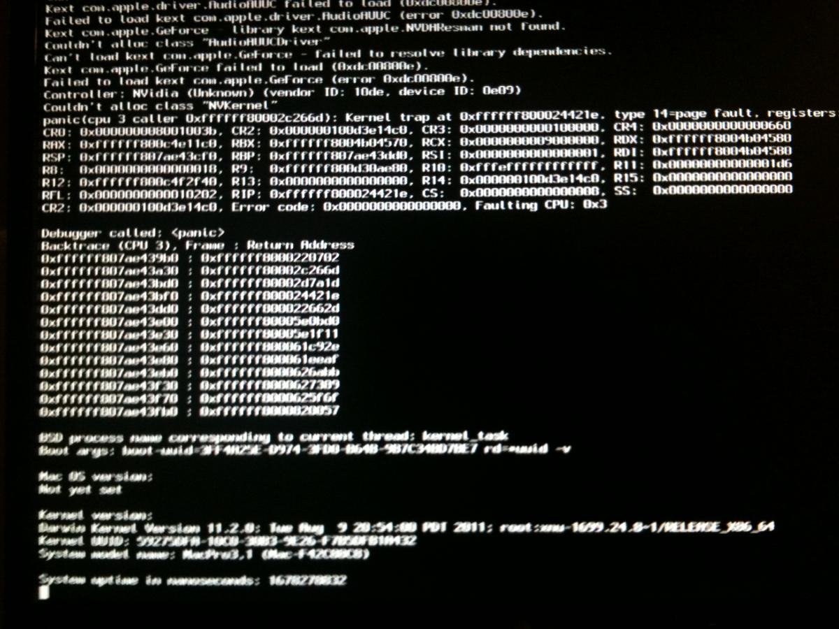

youraa Posted December 18, 2011 Share Posted December 18, 2011 Hi there I have the configuration as in the topic, I install the system and can't boot. I tried in many different ways, using the nvenabler from the vga drivers list, and another time with the nvenabler from the bootlist options, neither work. I think the graphic card is the problem but I'm not sure, any ideas how to solve the problem? I also tried both bootloaders still with no sucess, though I think that chameleon is working better it takes more time during start to crash. Can someone help me? Thx! p.s. I attaching the photo from the crash from bothh bootloaders, the give slightly different info My configuration: Asus maximus x38 4gb ram 800mhz geill black dragon msi gtx580 lightning Intel core 2 quad q9550 2.8@ 3.4Ghz Link to comment https://www.insanelymac.com/forum/topic/273639-iatkos-l2-on-asus-maximus-x38msi-gtx580-lightning-problem/ Share on other sites More sharing options...
Gringo Vermelho Posted December 18, 2011 Share Posted December 18, 2011 NVEnabler is not a driver. Delete NVEnabler.kext, boot with -v and take another photo when it halts/panics. Try booting with -v -x (x is safe mode, like on Windows, sound and video drivers don't load) "NVDAResman not found", "Geforce.kext failed to load" indicate a serious problem. Those are part of the OS X nvidia drivers. Make sure your driver files are unmodified and that all of the nvidia driver kernel extensions have been installed. The main driver for your video card is GF100Hal.kext. This is another great example of why everyone should be using retail install media + boot CD instead of hacked install DVDs. Your installation was done with a hacked install DVD right? Which one? Try not picking anything in the video section when installing. Link to comment https://www.insanelymac.com/forum/topic/273639-iatkos-l2-on-asus-maximus-x38msi-gtx580-lightning-problem/#findComment-1779510 Share on other sites More sharing options...

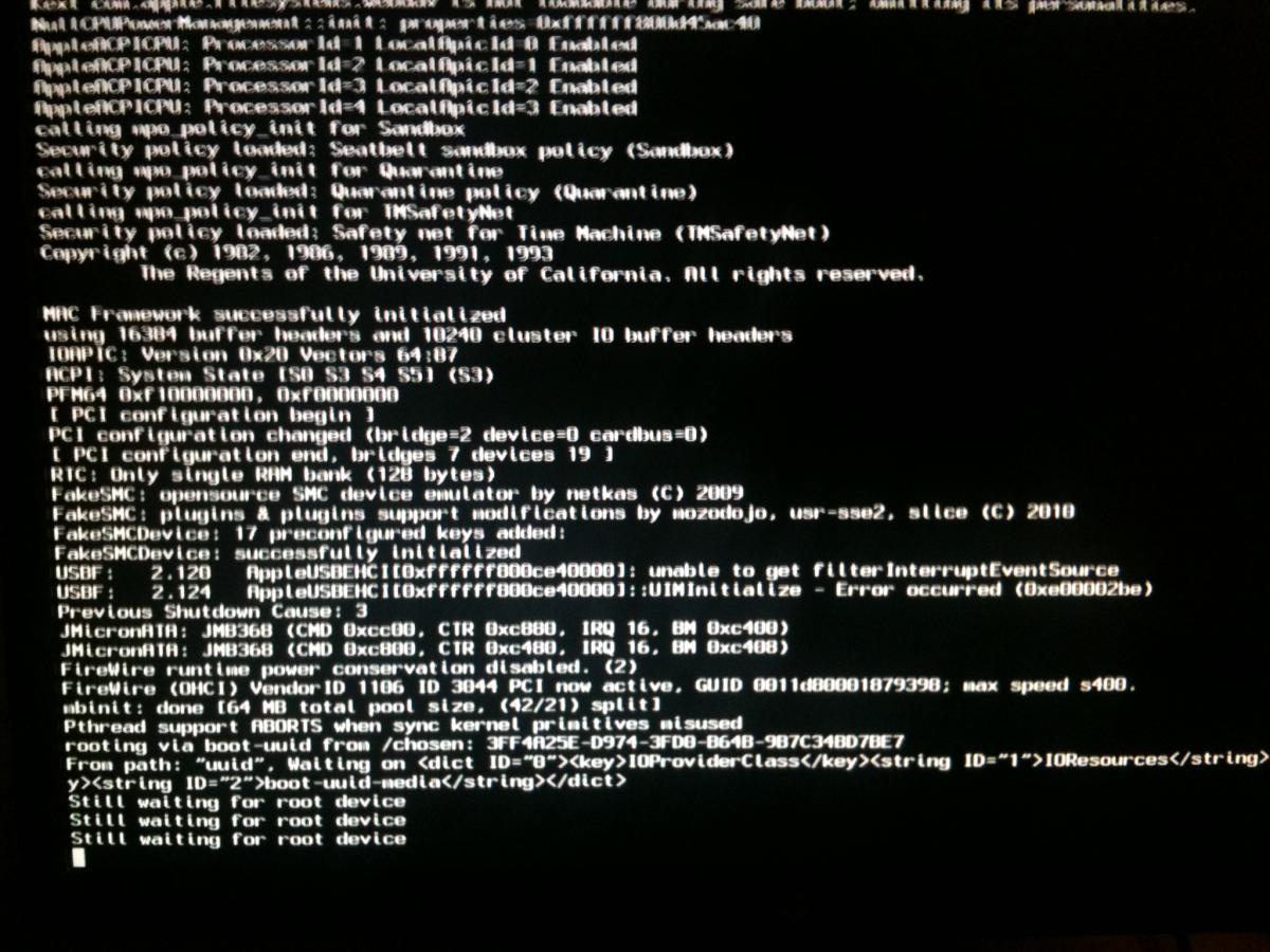

Gringo Vermelho Posted December 18, 2011 Share Posted December 18, 2011 You wouldn't be posting here if you did. "Still waiting for root device" means OS X is not recognizing your SATA controller, which results in OS X not being able to see any of the drives that are connected to it. You can fix this by changing SATA mode to AHCI in the BIOS, or by installing the right driver for your SATA controller in the "customize" section. Make sure that the hard drive you've installed OS X on is connected to the Intel ICHx and not the JMicron SATA controller. Look in your motherboard manual to see which SATA ports belong to which controller. Try disabling the JMicron SATA controller in the BIOS. Lastly, if you have done the above, or if the above does not apply to your situation and you can't get it to boot on the ICHx, connect the OS X drive to a SATA port on the JMicron and see what happens. 1 Link to comment https://www.insanelymac.com/forum/topic/273639-iatkos-l2-on-asus-maximus-x38msi-gtx580-lightning-problem/#findComment-1779552 Share on other sites More sharing options...
