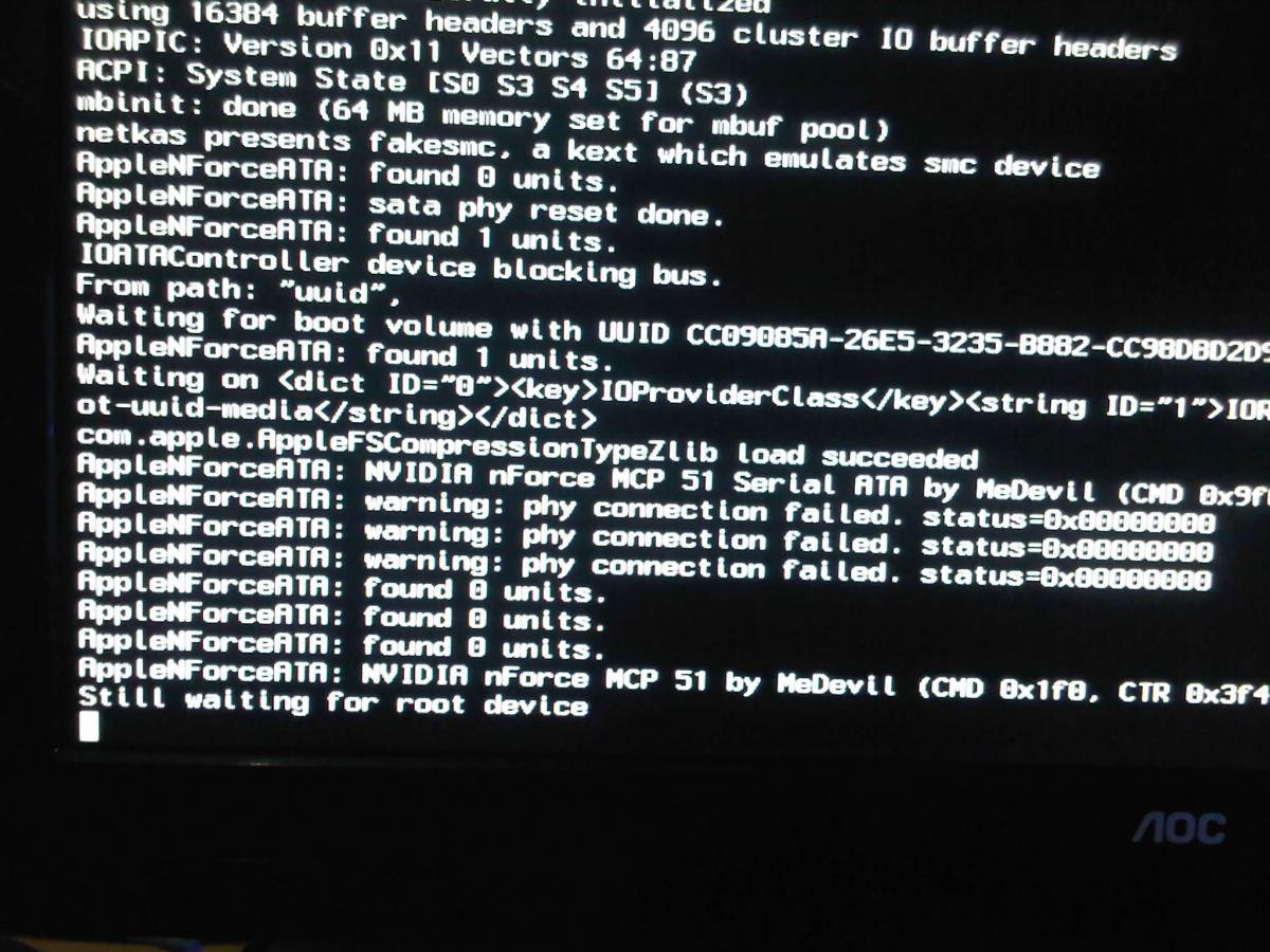

CarlDx Posted December 17, 2011 Share Posted December 17, 2011 This is the spec of my computer: -------------------------------------------------- ------------------------------ -ASUS P5N-D Nvidia nForce 750i SLI -Intel Core 2 Quad CPU (Q6600) 2.40GHz Stock OCZ Gold -2 x 2GB (4GB total) 800 MHz DDR2 SDRAM EVGA NVIDIA GeForce GTX-285 Hitachi 160GB Sata Drive, DVDRW-Lite-ON -------------------------------------------------- ------------------------------ I have the iso: iATKOS (s3 v2) Well, boot from the cd, then press any key and then goes to the screen with the apple and the loading animation, it takes a while. Then an icon appears over the apple like this (/) and remain stopped, until I can hear the hard drive powers down and goes no further. then probed with the commands:-x-v busratio = 20. and then starts to load some files (kext) after finished loading stops and much time standing in a line that says: appleNForceATA: Nvidia nForce MCP 51 ...... then out: "Still Waiting for root device" and is repeated several times .. and it does nothing more ... I did a screen capture which is stopped CarlDx.- Quote Link to comment https://www.insanelymac.com/forum/topic/273619-asus-p5n-d-this-is-i-tried/ Share on other sites More sharing options...

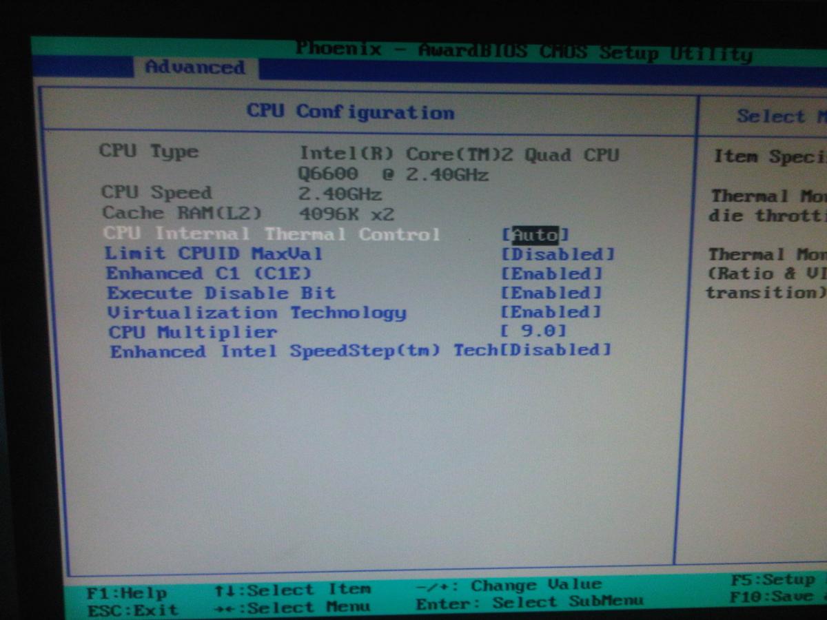

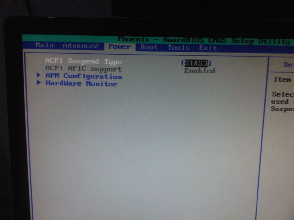

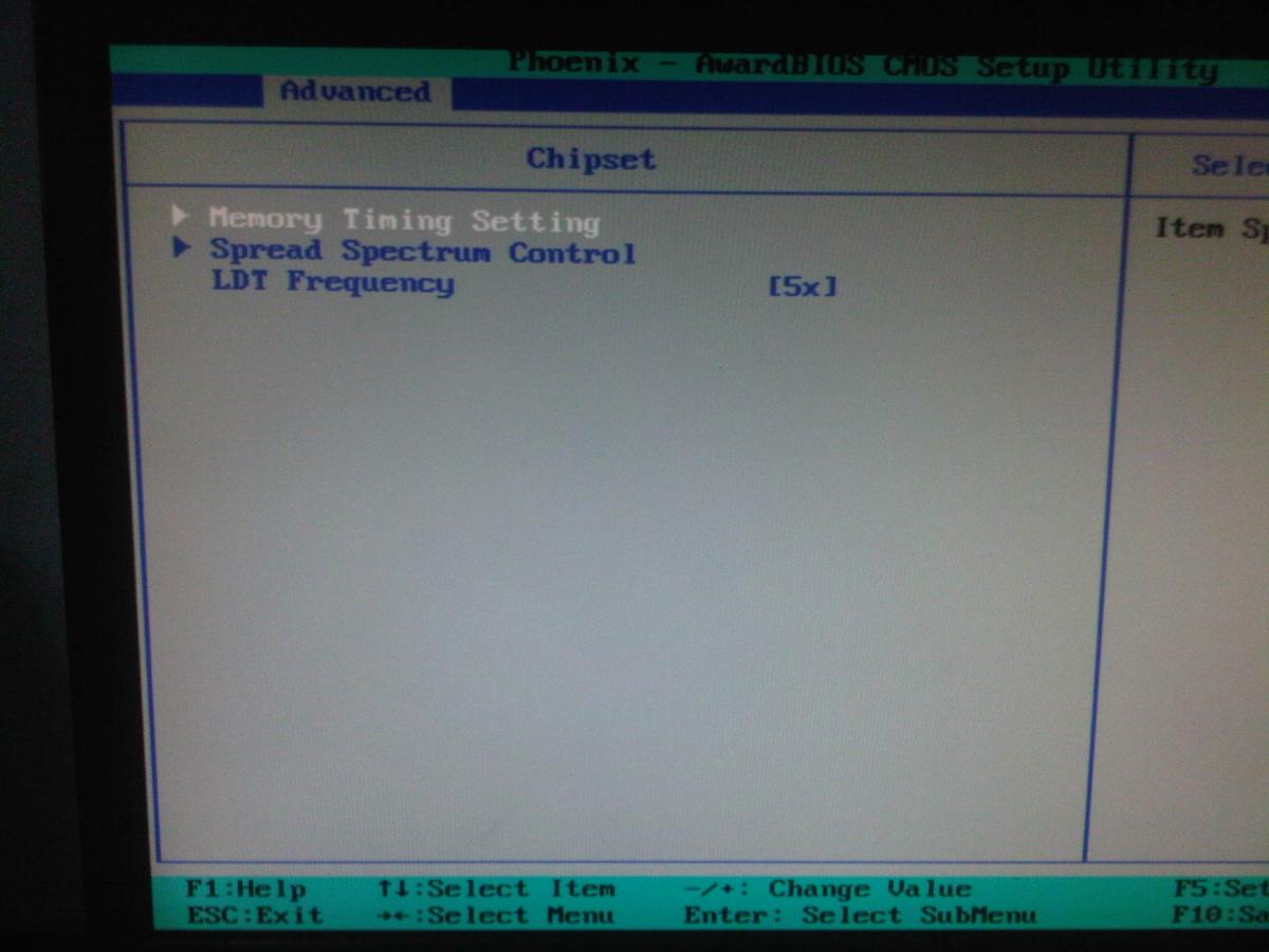

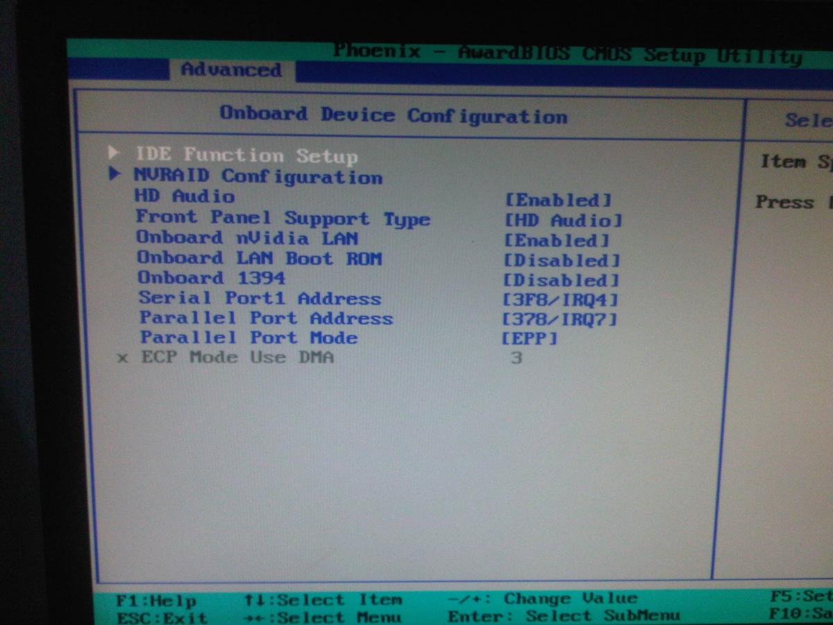

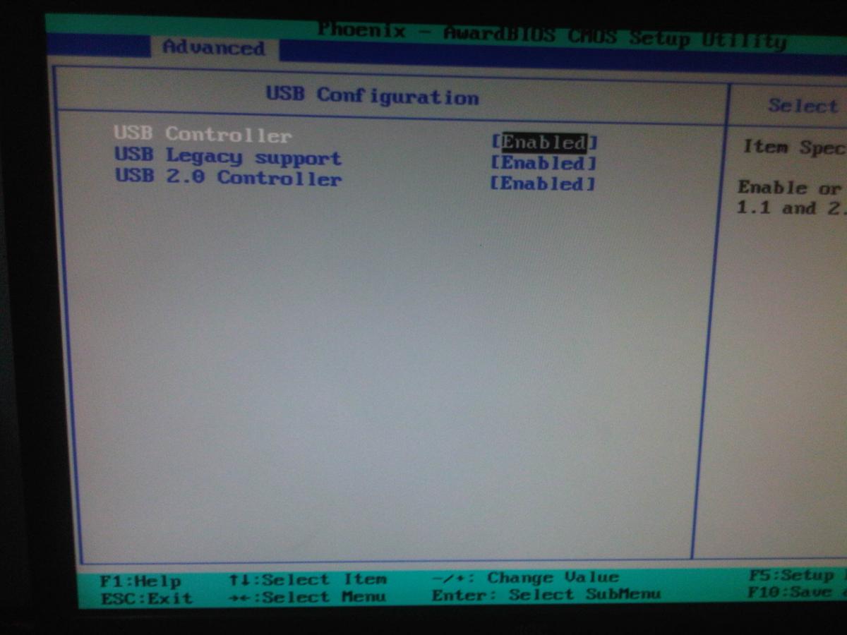

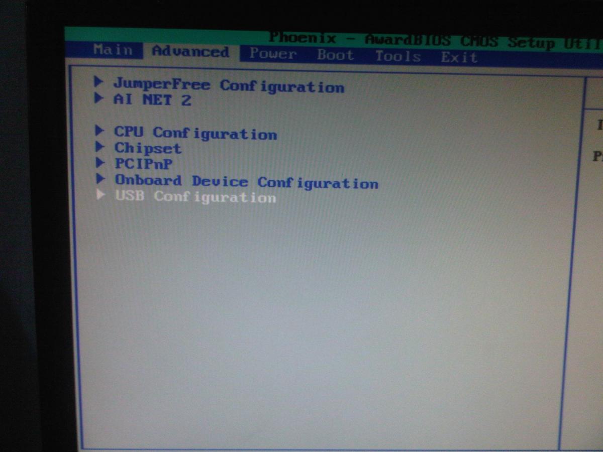

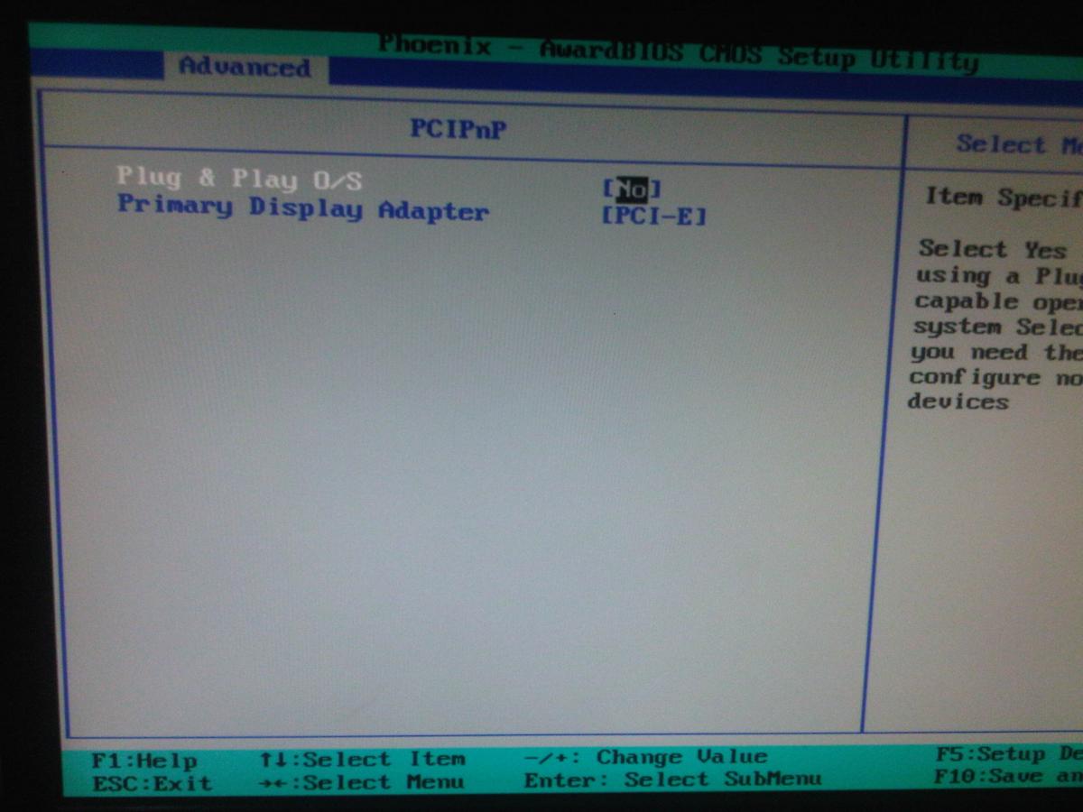

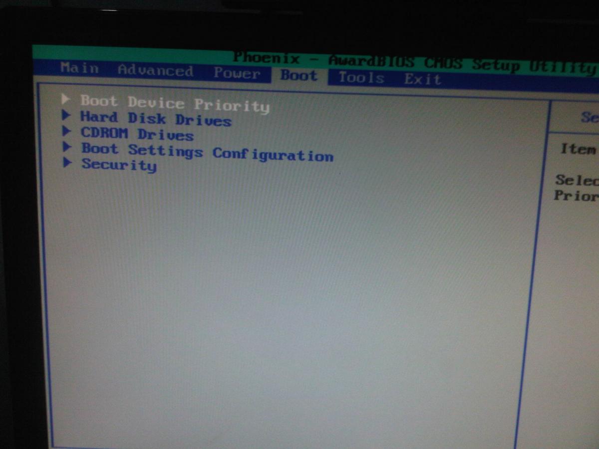

CarlDx Posted December 17, 2011 Author Share Posted December 17, 2011 (edited) that option did not appear in the BIOS settings, I made some screenshots ... Sorry man I'm new in this Edit: I was seaching on google to find why asus P5N-D doesn't appear this option in Bios settings and is because the P5N-D has no AHCI support. Edited December 17, 2011 by CarlDx Quote Link to comment https://www.insanelymac.com/forum/topic/273619-asus-p5n-d-this-is-i-tried/#findComment-1779321 Share on other sites More sharing options...

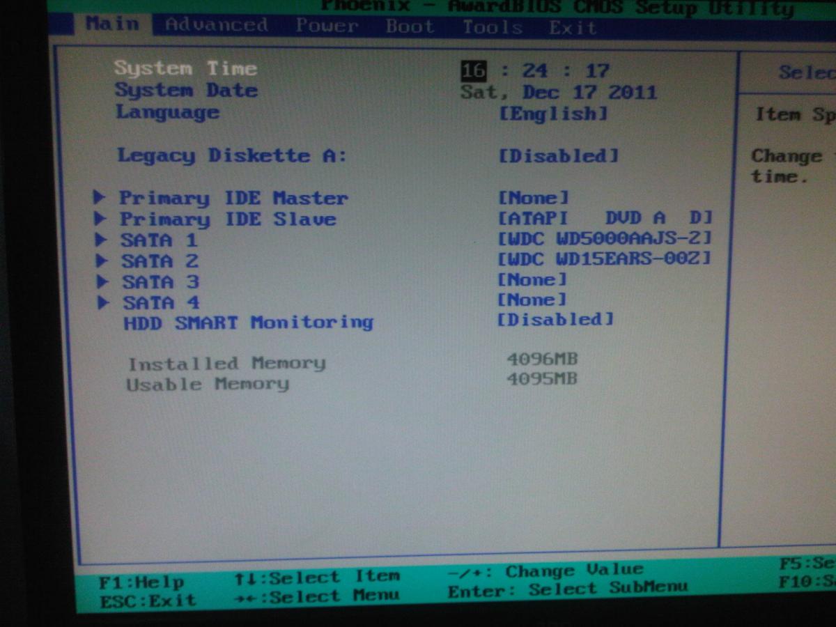

verdant Posted December 18, 2011 Share Posted December 18, 2011 Ideally see my topic nForce OS X Lion (10.7) APP STORE DOWNLOAD INSTALL GUIDE on a Series 6 or 7 nForce chipset / Intel CPU MOBO.......or my topic nForce RETAIL INSTALL GUIDE for Snow Leopard (10.6) on a Series 6 or 7 nForce chipset / Intel CPU MOBO..... Set your BIOS according to my downloadable OS X BIOS settings template for your nForce 750i chipset and set up your IDE DVDRW as Master...... Alternatively, see my iATKOS S3 v2 install guide in my blog....... 1 Quote Link to comment https://www.insanelymac.com/forum/topic/273619-asus-p5n-d-this-is-i-tried/#findComment-1779364 Share on other sites More sharing options...
CarlDx Posted December 18, 2011 Author Share Posted December 18, 2011 Finally I get to install iATKOS (s3 v2) on my pc it seems that the problem was that I had to put DVDRW as master, now the problem is that when I restart shows nothing, and only heard a song, in conclusion, drivers video are the problem, I followed exactly the tutorial you gave me this link (blog) what I can do about it now? sorry for my bad english Quote Link to comment https://www.insanelymac.com/forum/topic/273619-asus-p5n-d-this-is-i-tried/#findComment-1779405 Share on other sites More sharing options...

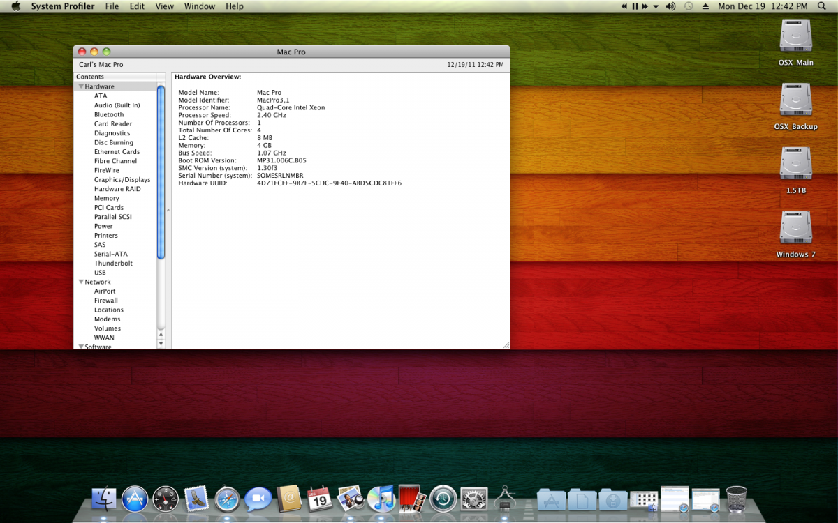

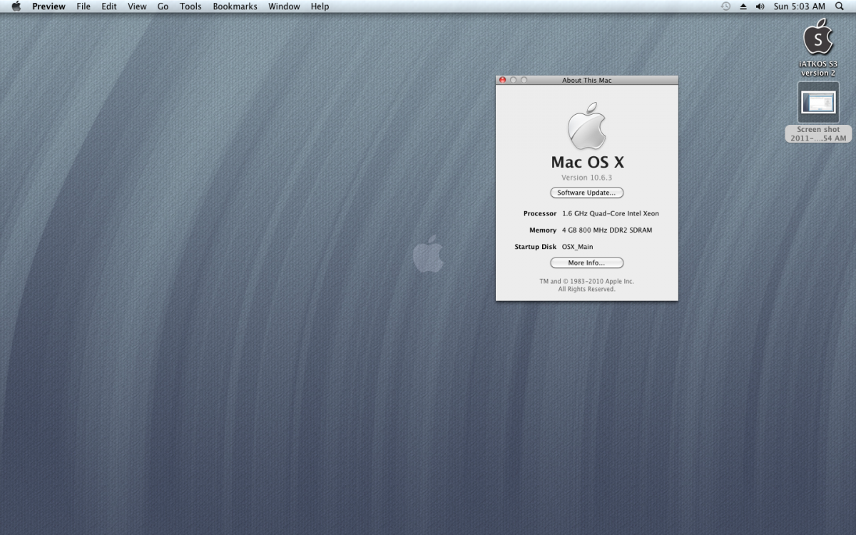

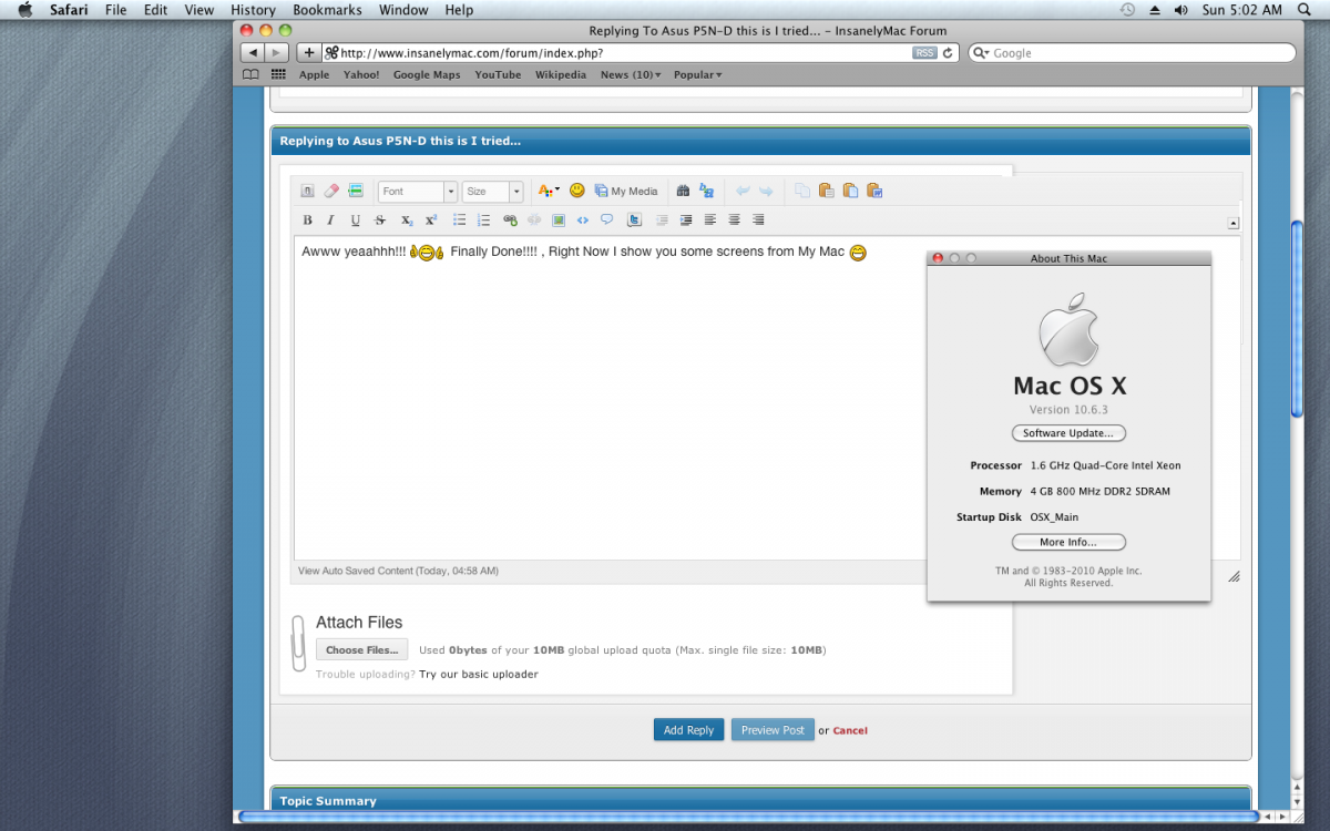

CarlDx Posted December 18, 2011 Author Share Posted December 18, 2011 Awww yeaahhh!!! Finally Done!!!! , Right Now I show you some screens from My Mac Quote Link to comment https://www.insanelymac.com/forum/topic/273619-asus-p5n-d-this-is-i-tried/#findComment-1779412 Share on other sites More sharing options...

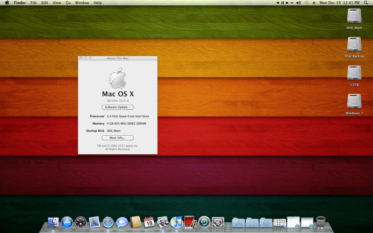

CarlDx Posted December 19, 2011 Author Share Posted December 19, 2011 Thanks a lot mate, successfully Update my mac to 10.6.8 without any inconvenience, the only thing I lack to do, how to put the audio in 5.1 because only is in 2 channels???? I attach some screenshot again... Quote Link to comment https://www.insanelymac.com/forum/topic/273619-asus-p5n-d-this-is-i-tried/#findComment-1779725 Share on other sites More sharing options...
verdant Posted December 19, 2011 Share Posted December 19, 2011 Thanks a lot mate, successfully Update my mac to 10.6.8 without any inconvenience, the only thing I lack to do, how to put the audio in 5.1 because only is in 2 channels???? I attach some screenshot again... See [How To] 5.1 Surround Sound...... :wink2: I have now had to time to check...........I believe your audio chipset is a Realtek ALC883.......so see AppleHDA.kext ALC883 "5.1" Ported to SL.......... 1 Quote Link to comment https://www.insanelymac.com/forum/topic/273619-asus-p5n-d-this-is-i-tried/#findComment-1779821 Share on other sites More sharing options...

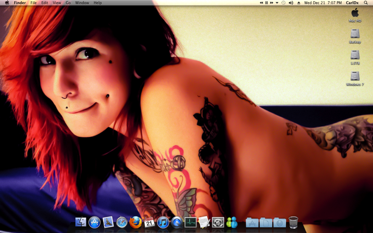

CarlDx Posted December 21, 2011 Author Share Posted December 21, 2011 Oh God, not how to thank you brother .. finally managed to put the audio in 5.1, I am very happy because every day that passes, I am interested in learning more and discover this new world that is for me ... the world of Mac OSX, I feel that me being a noob and become a master in just one week: D thanks for making this possible ... Thanks to InsanelyMac for giving me the support ... here we go another screen Quote Link to comment https://www.insanelymac.com/forum/topic/273619-asus-p5n-d-this-is-i-tried/#findComment-1780376 Share on other sites More sharing options...
