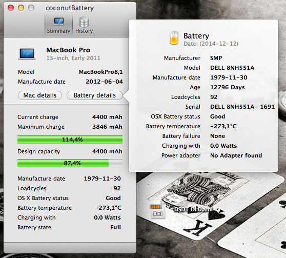

hydra1ysk Posted December 20, 2014 Share Posted December 20, 2014 Hi I'm have a problem with my battery status. I don't know why mavericks show that my battery charge status is in 114%. ¿How i can fix this? I attach my DSDT and IOREG. Tha Greetings dsdt.aml.zip MacBook Pro IOreg.zip Link to comment https://www.insanelymac.com/forum/topic/272459-appleacpibatterymanagerapplesmartbatterymanager-for-lion/page/8/#findComment-2096450 Share on other sites More sharing options...
RehabMan Posted December 20, 2014 Share Posted December 20, 2014 Hi I'm have a problem with my battery status. I don't know why mavericks show that my battery charge status is in 114%. 2014-12-12 19.05.22.png ¿How i can fix this? I attach my DSDT and IOREG. Tha Greetings The problem is in your DSDT. Note that MaxCapacity is 3846, CurrentCapacity is 4400. Current/Max=114%. Is the DSDT you're using patched from your own native DSDT, or have you made the classic mistake of using a DSDT from another computer? Link to comment https://www.insanelymac.com/forum/topic/272459-appleacpibatterymanagerapplesmartbatterymanager-for-lion/page/8/#findComment-2096470 Share on other sites More sharing options...
hydra1ysk Posted December 20, 2014 Share Posted December 20, 2014 The problem is in your DSDT. Note that MaxCapacity is 3846, CurrentCapacity is 4400. Current/Max=114%. Is the DSDT you're using patched from your own native DSDT, or have you made the classic mistake of using a DSDT from another computer? I extract the DSDT in this computer with AIDA in windows. It's my own DSDT native. I follow the guide of this topic, maybe i do something wrong.... Link to comment https://www.insanelymac.com/forum/topic/272459-appleacpibatterymanagerapplesmartbatterymanager-for-lion/page/8/#findComment-2096471 Share on other sites More sharing options...
RehabMan Posted December 20, 2014 Share Posted December 20, 2014 I extract the DSDT in this computer with AIDA in windows. It's my own DSDT native. I follow the guide of this topic, maybe i do something wrong.... Probably you patched it incorrectly then. Or you're using an old battery kext with bugs... Link to comment https://www.insanelymac.com/forum/topic/272459-appleacpibatterymanagerapplesmartbatterymanager-for-lion/page/8/#findComment-2096473 Share on other sites More sharing options...
hydra1ysk Posted December 20, 2014 Share Posted December 20, 2014 Probably you patched it incorrectly then. Or you're using an old battery kext with bugs... I will check my patched again. For the kext, i think maybe this is the problem, because i use an old kext call ACPIBatteryManager. What kext do you recommend me? Link to comment https://www.insanelymac.com/forum/topic/272459-appleacpibatterymanagerapplesmartbatterymanager-for-lion/page/8/#findComment-2096498 Share on other sites More sharing options...
RehabMan Posted December 20, 2014 Share Posted December 20, 2014 I will check my patched again. For the kext, i think maybe this is the problem, because i use an old kext call ACPIBatteryManager. What kext do you recommend me? Current version: https://github.com/RehabMan/OS-X-ACPI-Battery-Driver Link to comment https://www.insanelymac.com/forum/topic/272459-appleacpibatterymanagerapplesmartbatterymanager-for-lion/page/8/#findComment-2096505 Share on other sites More sharing options...
