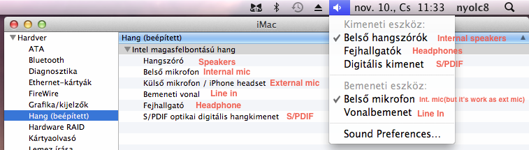

nyolc8 Posted November 10, 2011 Share Posted November 10, 2011 I finally got my alc662 work on Lion 10.7.2, but I have this: In System Profiler, I get all my ports, but in Sound preferences, I got only 5 port and Internal Mic works as external mic (so only the external mic port works). Here's my dsdt HDEF section: Device (HDEF) { Name (_ADR, 0x001B0000) Method (_DSM, 4, NotSerialized) { Store (Package (0x04) { "layout-id", Buffer (0x04) { 0x96, 0x02, 0x00, 0x00 }, "PinConfigurations", Buffer (Zero) {} }, Local0) DTGP (Arg0, Arg1, Arg2, Arg3, RefOf (Local0)) Return (Local0) } } Here's my AppleHDA.kext: AppleHDA.kext.zip (I'm not using any helper kext) How could I get all my ports working from system profiler to sound prefs? Edit: I got headphone autoswitching now, but still don't know how to get front panel mic working. That is an autoswitch-thing too, am I right? Link to comment https://www.insanelymac.com/forum/topic/271923-partly-solvedalc662-works-but/ Share on other sites More sharing options...

nyolc8 Posted November 30, 2011 Author Share Posted November 30, 2011 If I'm using pinconfiguration from my linux dump, there's no working sound ports at all! I'm using pinconfiguration from an old "alc662.kext" file that I found here on insanelymac 1-2 years ago (that kext file was made for exactly the same MB that I have). I tried to add external mic into PathMap section in platforms.xml many ways, there I was able to fix headphone autoswitch, but can't make external (front panel) mic work. Link to comment https://www.insanelymac.com/forum/topic/271923-partly-solvedalc662-works-but/#findComment-1774664 Share on other sites More sharing options...
