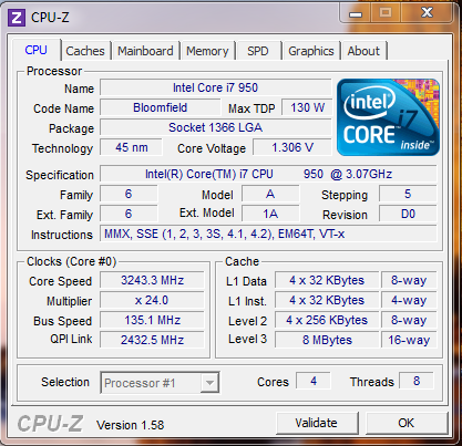

Gringo Vermelho Posted November 8, 2011 Share Posted November 8, 2011 Post a photo of the kernel panic. Boot with -v to see it. You must set GraphicsEnabler=n (and disable/remove any other video card injection method) otherwise you will boot to a black screen. There is no driver support for your video card on Snow Leopard, it will only work in unaccelerated VESA mode and only if you don't use any injection method. On GTX 4xx we can use the Quadro 4000 drivers for Mac but AFAIK those will not work with 5xx cards. The Lion nvidia drivers have support for your card. According to this, your busratio is 24: http://www.insanelymac.com/forum/index.php?showtopic=240542 Link to comment https://www.insanelymac.com/forum/topic/271822-stuck-on-installation-boot-of-leo-106/#findComment-1768844 Share on other sites More sharing options...

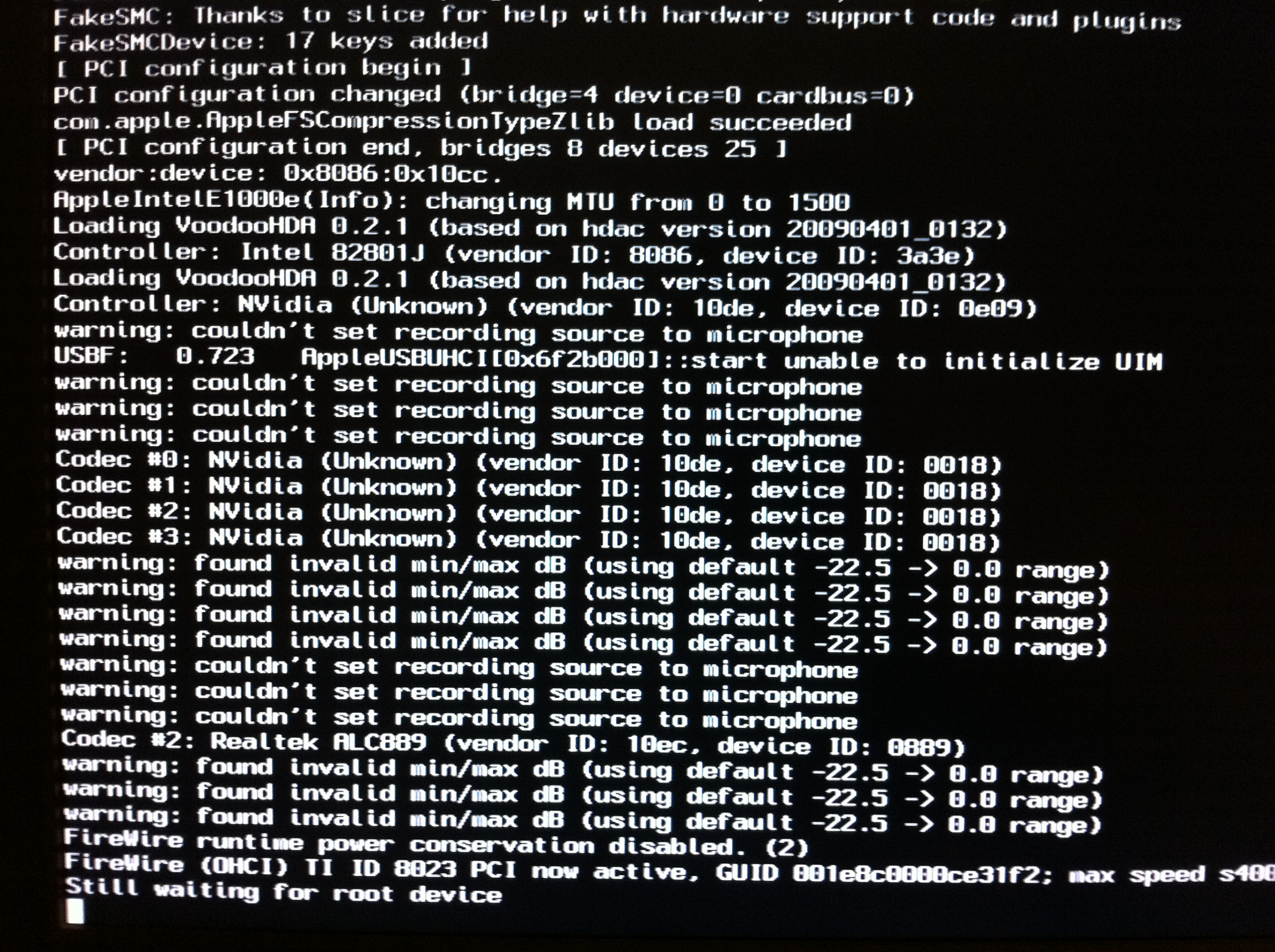

acidtearz Posted November 10, 2011 Author Share Posted November 10, 2011 Post a photo of the kernel panic. Boot with -v to see it. You must set GraphicsEnabler=n (and disable/remove any other video card injection method) otherwise you will boot to a black screen. There is no driver support for your video card on Snow Leopard, it will only work in unaccelerated VESA mode and only if you don't use any injection method. On GTX 4xx we can use the Quadro 4000 drivers for Mac but AFAIK those will not work with 5xx cards. The Lion nvidia drivers have support for your card. According to this, your busratio is 24: http://www.insanelymac.com/forum/index.php?showtopic=240542 now i did boot with: GraphicsEnabler=n busratio=24 -v and thats what i got: Link to comment https://www.insanelymac.com/forum/topic/271822-stuck-on-installation-boot-of-leo-106/#findComment-1769394 Share on other sites More sharing options...
