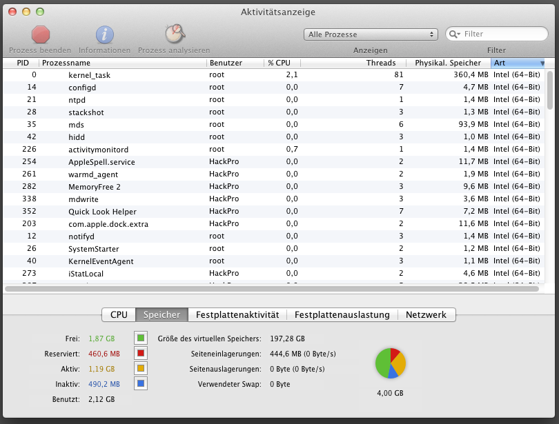

NOAEL Posted October 12, 2011 Share Posted October 12, 2011 hi i have the same problem and in os x lion it is very hard with 4gb ram because i want to use my computer for music production... i have found this Activity Monitor only showing 4GB of 8GB RAM but it did not help me... please can someone tell me how to fix this Link to comment https://www.insanelymac.com/forum/topic/269494-hackintosh-lion-with-more-than-4gb-ram/#findComment-1758855 Share on other sites More sharing options...
