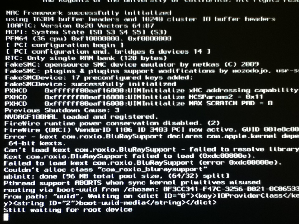

medeirosdez Posted September 26, 2011 Author Share Posted September 26, 2011 Hello there guys! I would first like to thank you all for your support. It was very kind of you to help me like that. Thank you! Now, unfortunately, I only got a dead system after following chinese_spy guidence. I got stuck on a "Still waiting for root device" no matter what boot arguments I used.. "PCIRootUID=1", "-v -f -x", "-v -f -x -s", whatever I tried: "Still waiting for root device" forever. I have backed up the whole disk to another but I'm doubtful on whether it's worth it to retore because it seems I just can't get my computer to run smoothly and with no problems as it runs on Windows 7. I'm planning myself in order to purchase a true Mac as soon as possible. It'll either be a Mac Mini with discrete graphics (HD 6630) or a MacBook Pro 13" (the cheapest). So, what do you think guys? Is that problem easy to be fixed? Can I indeed get a stable and fully functional OSX on my computer? --------------------------------- Notes: I patched AICPM.kext as asked in the topic I created. No errors there. I deleted NullCPM.kext and followed everystep without errors. Booting didn't give me any KP, just got hang at the "Still waiting for root device". This is my sys specs: Intel DP67DE, firmware update 0067 (latest 0070 is unstable here) Intel Core i3 2100 @ 3,1GHz GeiL DDR3-1600 (X.M.P.) 2GB x 4 EVGA nVidia GeForce 560Ti (FPB edition) (dev ID 1200) Creative SoundBlaster X-Fi XtreamMusic (unsuported on OS X) Samsung 320GB 7200rpm HD322GJ x2 in RAID0 (not for OS X) Samsung 500GB 5400rpm HD502HI in AHCI (for OS X) OCZ StealthXtream 2 700W PS Genius SW-HF5.1 4000 HomeTheater Samsung BX2250 (21,5", 1920x1080p, LED monitor) For OS X I would use Realtek 892 integraded codec (with only stereo output and terrible audio input quality). Install method was as follows: Booted PC from [url="http://www.insanelymac.com/forum/topic/279450-why-insanelymac-does-not-support-tonymacx86/"]#####[/url] (25-05-2011) and selected OS X 10.6.3 retail install disk image restored to an USB stick. Had to use "PCIRootUID=1 maxmem=8192 -force64 -v" to get it to boot. (Not possible to boot from burnt DVD in here, it will never be "seen" by [url="http://www.insanelymac.com/forum/topic/279450-why-insanelymac-does-not-support-tonymacx86/"]#####[/url]) Did standard install, rebooted PC with the same arguments, now from Macintosh HD. It's important to note there was NO NEED to disable HT or SpeedStep or C States in firmware configuration, NOR had I to take away extra RAM sticks in order not to go beyond 4GB. After install I deleted ACPI_SMC_PlatformPlugin.kext from within IOPlatformPluginFamily.kext, installed update helper for SandyBridge, ran [url="http://www.insanelymac.com/forum/topic/279450-why-insanelymac-does-not-support-tonymacx86/"]#####[/url], installed Combo 10.6.8 1.1 and selected and installed following patches in [url="http://www.insanelymac.com/forum/topic/279450-why-insanelymac-does-not-support-tonymacx86/"]#####[/url]: - User DSDT (had my own extracted and patched using DSDTSE) - System utils - Intel network drivers - Internal disk patch - FakeSMC - Boot in 64bit and GraphicsEnabler = Yes - PCIRootUID fix - Instant Menu - Latest Chimelera I guess that was all. Rebooted without [url="http://www.insanelymac.com/forum/topic/279450-why-insanelymac-does-not-support-tonymacx86/"]#####[/url] directly into Macintosh HD and everything was working (except audio I didn't want yet). Then I rebooted with another USB stick and OS X Lion ESD.dmg restored unto it and selected it to boot the system with. Installed Lion and no problems yet. Just had to update to latest version, 10.7.1. I edited NV100...kext as explained here and also AGPM.kext. I than ran [url="http://www.insanelymac.com/forum/topic/279450-why-insanelymac-does-not-support-tonymacx86/"]#####[/url] once more and reinstalled everything again just to make sure, in addition to the following: AppleHDA rollback + HDA enabler for 892 + HDA without DSDT (I didn't patch mine for audio). Fix from netkas for OpenCL. Also I added GraphicsEnable with nothing else to boot.apple.. blablabla.. (I don't remember it exactly, that was necessary to get fully working 560Ti). Rebooted and, voalá! I had a completely working system, except for the problems I've mentioned earlier. -------------------------- That's it guys, I wish someone could help!! Bye! I just want to add one more thing: I have followed all steps provided by chinese_spy, all! I did exactly as he said, everything and without any errors. For the AICPM patch I used SpeedSteper from this link I guess. Of course, I downloaded version for Lion 10.7.2 (I was using beta 10.7.2). It gave me no errors on the terminal. Link to comment https://www.insanelymac.com/forum/topic/268720-intels-dp67de-dsdt-and-sleep-that-wont-work/#findComment-1752944 Share on other sites More sharing options...

medeirosdez Posted September 28, 2011 Author Share Posted September 28, 2011 I took a look at both of those dsdts, what I find strange is, where are the CPU definitions? they usually put those right around the top. Post an ioreg please. Scope (_PR) { Processor (P001, 0x01, 0x00000810, 0x06) {} Processor (P002, 0x02, 0x00000810, 0x06) {} Processor (P003, 0x03, 0x00000810, 0x06) {} Processor (P004, 0x04, 0x00000810, 0x06) {} Processor (P005, 0x05, 0x00000810, 0x06) {} Processor (P006, 0x06, 0x00000810, 0x06) {} Processor (P007, 0x07, 0x00000810, 0x06) {} Processor (P008, 0x08, 0x00000810, 0x06) {} Processor (P009, 0x09, 0x00000810, 0x06) {} Processor (P010, 0x0A, 0x00000810, 0x06) {} Processor (P011, 0x0B, 0x00000810, 0x06) {} Processor (P012, 0x0C, 0x00000810, 0x06) {} Processor (P013, 0x0D, 0x00000810, 0x06) {} Processor (P014, 0x0E, 0x00000810, 0x06) {} Processor (P015, 0x0F, 0x00000810, 0x06) {} Processor (P016, 0x10, 0x00000810, 0x06) {} } Uefi hybrid by chance? Real Macbook Air 3,2 dsdt macbookair3.2.dsl.zip Asus P6t Del V2 dsdt P6TDV2_DSDT.aml.zip Hello "camoguy", thank you very much for your support. Yes, this motherboard I'm using is UEFI based, and, booting into Chimelerra is done in LegacyBIOS mode as there is no way to boot it in UEFI mode even if the disk is formated as GUID. I don't know what's wrong but it seems Chimelerra is really a BIOS-based bootloader, like it depends on a BIOS-based system to do its job. Thus, the system recognizes the installed bootloader as BIOS-only and gives me the only choice of booting in LegacyBIOS mode. You see I can boot MS Windows 7 in UEFI mode seemlessly. I have a completely working 100% UEFI Windows 7 install in here. You said there is code missing from my DSDT. Well, I didn't really delete anything from it, I extracted it before even having Chimelerra installed, so I guess it is 100% unchanged from the one in the firmware code. Now, it doesn't mean the code is actually there, its absence may just not affect other systems. I'm now on Windows as I killed my system with previous steps provided by chinese_spy. I do have a backup but using it implies installing the extra harddrive in which the backup is and I'll have to buy myself sometime to do it someday in this week. Is there a way to do what you asked (ioreg output) from Windows? Thanks once more mate! Link to comment https://www.insanelymac.com/forum/topic/268720-intels-dp67de-dsdt-and-sleep-that-wont-work/#findComment-1753960 Share on other sites More sharing options...
