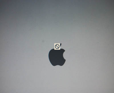

bloodRa1n Posted July 26, 2011 Share Posted July 26, 2011 Hi everybody, I got a problem after iAtkos S3 v2 (Snow Leopard 10.6.3), and I can't get out of it. So the problem is that when trying to load the system (after a successful installation) i see the "forbidden" symbol on the Apple logo, like this: So I tried to start in -v mode and this is what it gives to me, just when it stops loading the system: In BIOS settings I've set AHCI and I disabled all "optional" CPU features (SpeedStep, VanderPool, etc) because before the installation process, with all these features enabled I had a kernel panic just inserting the iAtkos DVD. I really hope you are able to give me a hand and I thank you in advance. P.S.: My HW config it's down in my signature, if you need I can give some more details! Link to comment https://www.insanelymac.com/forum/topic/263598-stuck-after-installation-iatkos-s3-v2/ Share on other sites More sharing options...
magnetique Posted July 28, 2011 Share Posted July 28, 2011 Ciao! What options did you select by the installation? Please try to make a new install without any box checked related to graphic. You will be still able to install your graphic card later, but the priority now is to have a bootable/working system. Next you can try this: on my Asus mainboard I've got this symbol when I've used GUID as partition scheme, it was ok when I've used Master Boot Record (MBR) instead. Link to comment https://www.insanelymac.com/forum/topic/263598-stuck-after-installation-iatkos-s3-v2/#findComment-1724491 Share on other sites More sharing options...

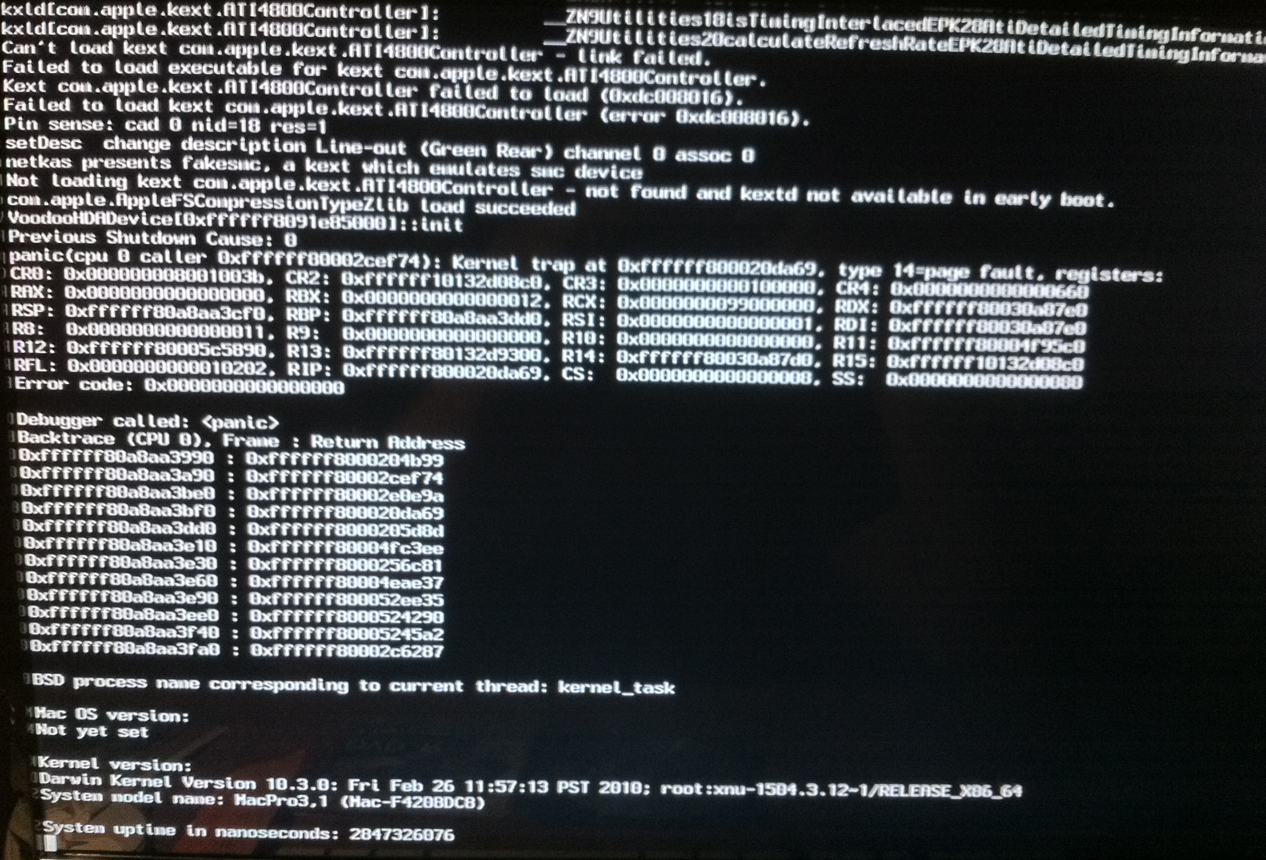

bloodRa1n Posted July 28, 2011 Author Share Posted July 28, 2011 Ciao! What options did you select by the installation? Please try to make a new install without any box checked related to graphic. You will be still able to install your graphic card later, but the priority now is to have a bootable/working system. Next you can try this: on my Asus mainboard I've got this symbol when I've used GUID as partition scheme, it was ok when I've used Master Boot Record (MBR) instead. Ok, I tried to install without any box related to graphics; this way, I get this: BUT I'm able to boot in -x mode, with 1024*768 screen obviously... Now I try the installation one more time, doing what you suggested me... Thank you very much, stay tuned! Link to comment https://www.insanelymac.com/forum/topic/263598-stuck-after-installation-iatkos-s3-v2/#findComment-1724656 Share on other sites More sharing options...
Sotirios Papakonstantinou Posted July 28, 2011 Share Posted July 28, 2011 Apple wants MacOS run only on Apple computers and noteboks, so to make sure you have a "genuine" Mac and not a Hackintosh, they make use of Trusted Platform Module (TPM). This is a hardware signature of the motherboard and if MacOS doesn't find it (or is not fooled) refuses to boot. This means that only very specific hardware combination (chipset, CPU etc) will work without any modification. Most others we need some sort of hacking after installation to make sure we can boot in MacOS. This basically means to modify some specific files (or download versions that match our system) to fool MacOS that we have a real Mac. One of them is the mach_kernel file and another is a special file DSDT that summarises your hardware. If you look at some installation guides you will find more details. At this point you need a working MacOS installation (I used a temporary MacOS 10.5 installation which I deleted once I made 10.6 bootable) where you go to the terminal and type stuff. Maybe you have to make some small partition and install MacOS 10.5 to use it. I don't know if accessing the terminal from the installation DVD-ROM allows you to make the required modifications. Also it is not guaranteed that you will find drivers (kexts) for all your hardware, so some might not work in MacOS (this is very annoying with alternative OSes). Link to comment https://www.insanelymac.com/forum/topic/263598-stuck-after-installation-iatkos-s3-v2/#findComment-1724706 Share on other sites More sharing options...
