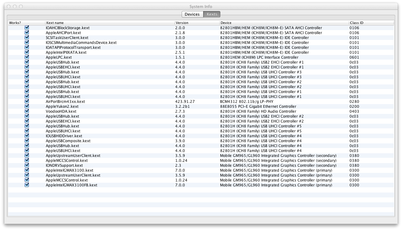

gazzauk71 Posted November 20, 2011 Share Posted November 20, 2011 Hi again. Thanks for the details above. No I've not got into DSDt files yet. So I've done all of mine via kexts. For sleep it the sleepenabler.kext and the apple one from a 10.6 version of OSX together. Its dowloadable from here as sleepenabler lion. Voodoobattery lion on osx86.net is the battery meter kext etc. Than works for me. So you might want to stick that one in. Heres my kexts as loaded by the way. Link to comment https://www.insanelymac.com/forum/topic/262767-mac-os-x-lion-107-golden-master-on-fujitsu-s6410/page/2/#findComment-1772223 Share on other sites More sharing options...

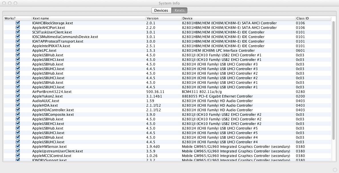

robi62 Posted November 21, 2011 Share Posted November 21, 2011 No, don't use any DSDT files at all. I did that b4 but could not get sleep to work and also I needed dsdt for my applehda kext.... Battery meter is the one with appleacpiplatform kext in it??? Here are my kext I have noticed your yukon is newer where didi u get it from??? Link to comment https://www.insanelymac.com/forum/topic/262767-mac-os-x-lion-107-golden-master-on-fujitsu-s6410/page/2/#findComment-1772314 Share on other sites More sharing options...
gazzauk71 Posted November 22, 2011 Share Posted November 22, 2011 Hi Again. I wish I knew where I found it. It was only on one of the forums. I can send the files to you if you want? I actually read an article on changing kexts to match the cards header e.g. yukon 8E8055 etc, which I did in the kext. I then cut the ionetworkfamily kext down to just the card that I wanted and ran the kext utility and restart... up came the network card etc. I changed my machine yesterday to a apple macbook 5.1 in the smbios via [url="http://www.insanelymac.com/forum/topic/279450-why-insanelymac-does-not-support-tonymacx86/"]#####[/url] 4.1. Wrong move, caused a panic, so had to start with a -x and switch it back.... to 3.1, whoops. Don't know why that happened considering yours is using a 5.1 ? As for battery meter. Yes, its got the appleacpiplatform and voodoobattery in together that worked for me! Link to comment https://www.insanelymac.com/forum/topic/262767-mac-os-x-lion-107-golden-master-on-fujitsu-s6410/page/2/#findComment-1772634 Share on other sites More sharing options...
