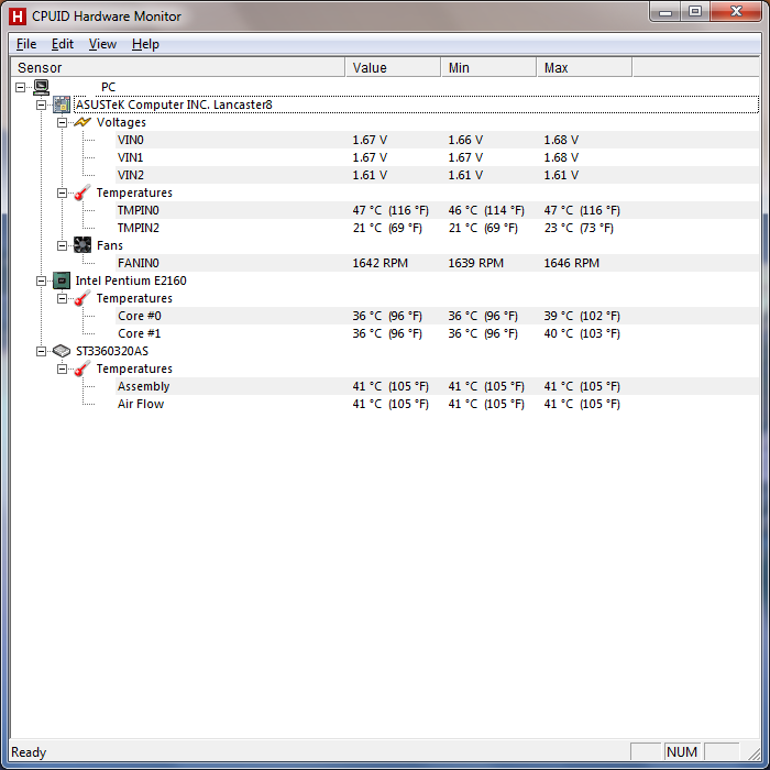

AdnanB Posted July 18, 2011 Author Share Posted July 18, 2011 The FakeSMC.kext on its own serves a different purpose (emulates SMC). The job of displaying temps, fan speed, etc... is done by plugins it has inside (in older versions) or used with it (in newer version plugins may be placed outside FakeSMC.kext but in the same /E/E folder). Older versions (the one with embedded plugins) of FakeSMC.kext used to display more accurate values on my HP notebook. While the newer version gives incorrect values (about 20c more then actual temps are) for CPU temps. I suspect the appropriate plugin is not reporting/reading temps correctly. Different set of plugins might provide different set of information. Be sure to use only the one you really need. If you have Windows installed (Windows Live CD might also work), use HWMonitor application to see what sensors are available on your PC and chose plugins accordingly. I've attached a screenshot Which plugin should I get and how do you install the plugins? Link to comment Share on other sites More sharing options...
3.14r2 Posted July 18, 2011 Share Posted July 18, 2011 IntelCPUMonitor.kext for CPU temps Not sure about other plugins... FakeSMC_SL.zip the latest (ATM) FakeSMC.kext with plugins. Some of them might be useful for your system. Link to comment Share on other sites More sharing options...
AdnanB Posted July 18, 2011 Author Share Posted July 18, 2011 IntelCPUMonitor.kext for CPU tempsNot sure about other plugins... FakeSMC_SL.zip the latest (ATM) FakeSMC.kext with plugins. Some of them might be useful for your system. Did that. Worked like a charm. Temps reported actually. Still can't detect fan but I can live with that! Link to comment Share on other sites More sharing options...
