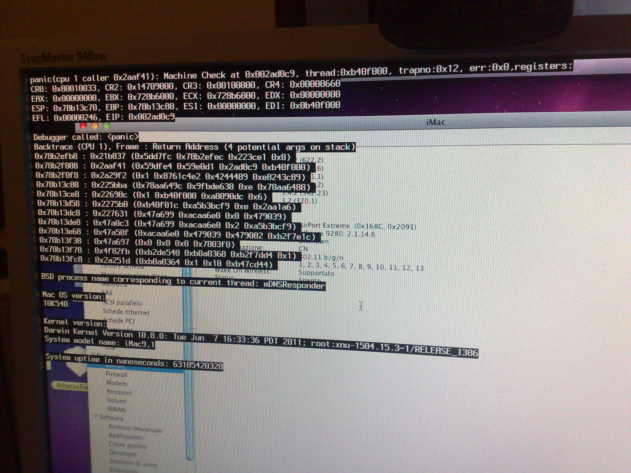

kilian Posted July 13, 2011 Author Share Posted July 13, 2011 perchè hai il kernel 10.3.0 se sei su 10.6.8? dovresti avere il 10.7.0. Usi qualche kernel patchato? Seconda questione, sei sicuro che i venid e devid siano corretti? ciao! per la prima domanda ti rispondo subito:) ho formattato tutto ed ero ancora alla 10.6.3 adesso sto aggiornandola di nuovo alla versione 8 la seconda cosa non ho capito cosa intendi.. scusa EDIT: Aggiungo due foto forse è questo il problema? Link to comment Share on other sites More sharing options...

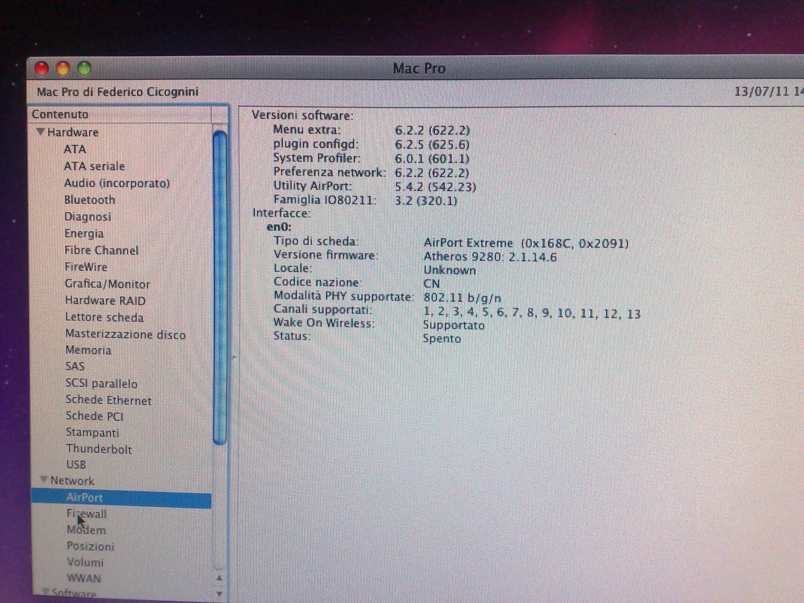

kilian Posted July 14, 2011 Author Share Posted July 14, 2011 OK i've tried, these photos are the result of modding the dsdt with this code I don't have any KP without the card (days ago i've used the Nforcelan.kext without any KP). If i use airport? KP I would like to specify that the system goes into KP only if I open safari MOD #1 I've added this under PCI0 Method (_DSM, 4, NotSerialized) { Store (Package () { "AAPL,slot-name", Buffer (){"AirPort"}, "class-code", Buffer (0x04){0x00, 0x80, 0x02, 0x00}, "device-id", Buffer (0x04){0x24, 0x00, 0x00, 0x00}, "device_type", Buffer (){"AirPort"}, "subsystem-id", Buffer (0x04){0x87, 0x00, 0x00, 0x00}, "subsystem-vendor-id", Buffer (0x04){0x6B, 0x10, 0x00, 0x00}, "vendor-id", Buffer (0x04){0x8C, 0x16, 0x00, 0x00} }, Local0) DTGP (Arg0, Arg1, Arg2, Arg3, RefOf (Local0)) Return (Local0) } MOD #2 Removing the _BBN string in PCI0 my graphic card it's not detected under System Profiler ---> PCI This is AtherosFix.kext: http://www.mediafire.com/?7hbdes8j63fd715 My IOREG: http://www.mediafire.com/?l7mf69gai157lvv The error Unknown locale? Link to comment Share on other sites More sharing options...
LatinMcG Posted July 14, 2011 Share Posted July 14, 2011 i had safari kp and was i believe due to improper smbios.plist model try macMini with the nforce as smbios.plist have u tried i386 instead of x86_64 ? also the code is in wrong spot find hub0 .. then at bottom of its section above last }.. ill fix it in dsdt its 168c,29 in ioreg .firewire is above it. so no kp without card. i think its time to test stability of system without card first.. got lan cable usable for internet? if it comes to it (systemstable without card on lan safari works) id recommend a pci-e to mini pci-e adapter and a compatible card AR5B91 or BCM94321MC .. about $16 on ebay total. have you switched slot of pci card ? sometimes irq conflict ill do this. after seeing dsdt and comparing to imac 9,1 wow what a difference..not like intel chipset standards! (best start looking for a gigabyte mobo if u want 100 % stable) try this.. btw i didnt even see LPCB in the dsdt anywhere. might be renamed and different address. too much stuff is crossed .. pnp of devices is al mixed due to totaly different mobo.. but some things match 100% but i say not enough to get stable system. try this dsdt i removed a lot of useless to mac stuff : LPT1 UART and a few things. leave original working dsdt in /Extra rename to boot.aml in case no good dsdt u can type DTSDT=hd(0,2)/Extra/boot.aml Link to comment Share on other sites More sharing options...

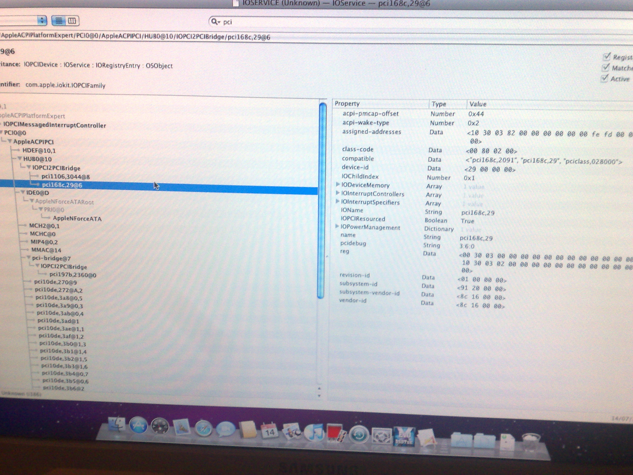

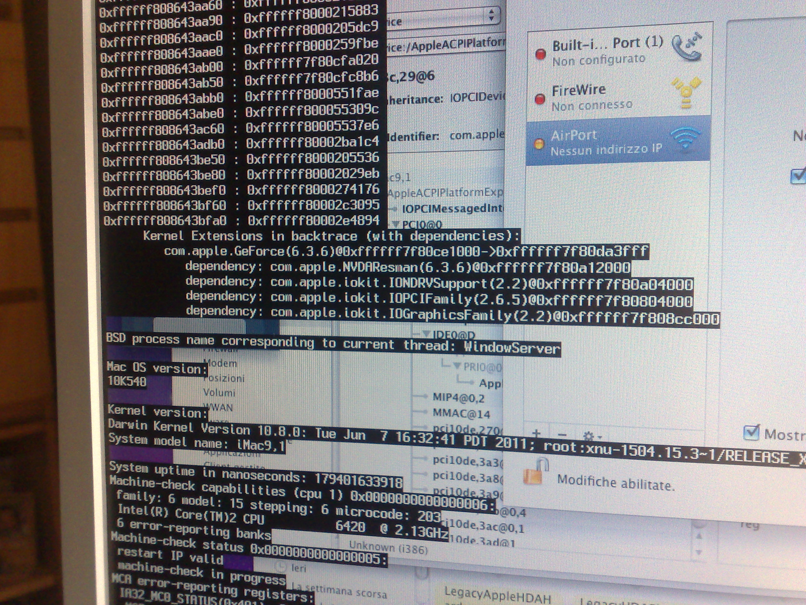

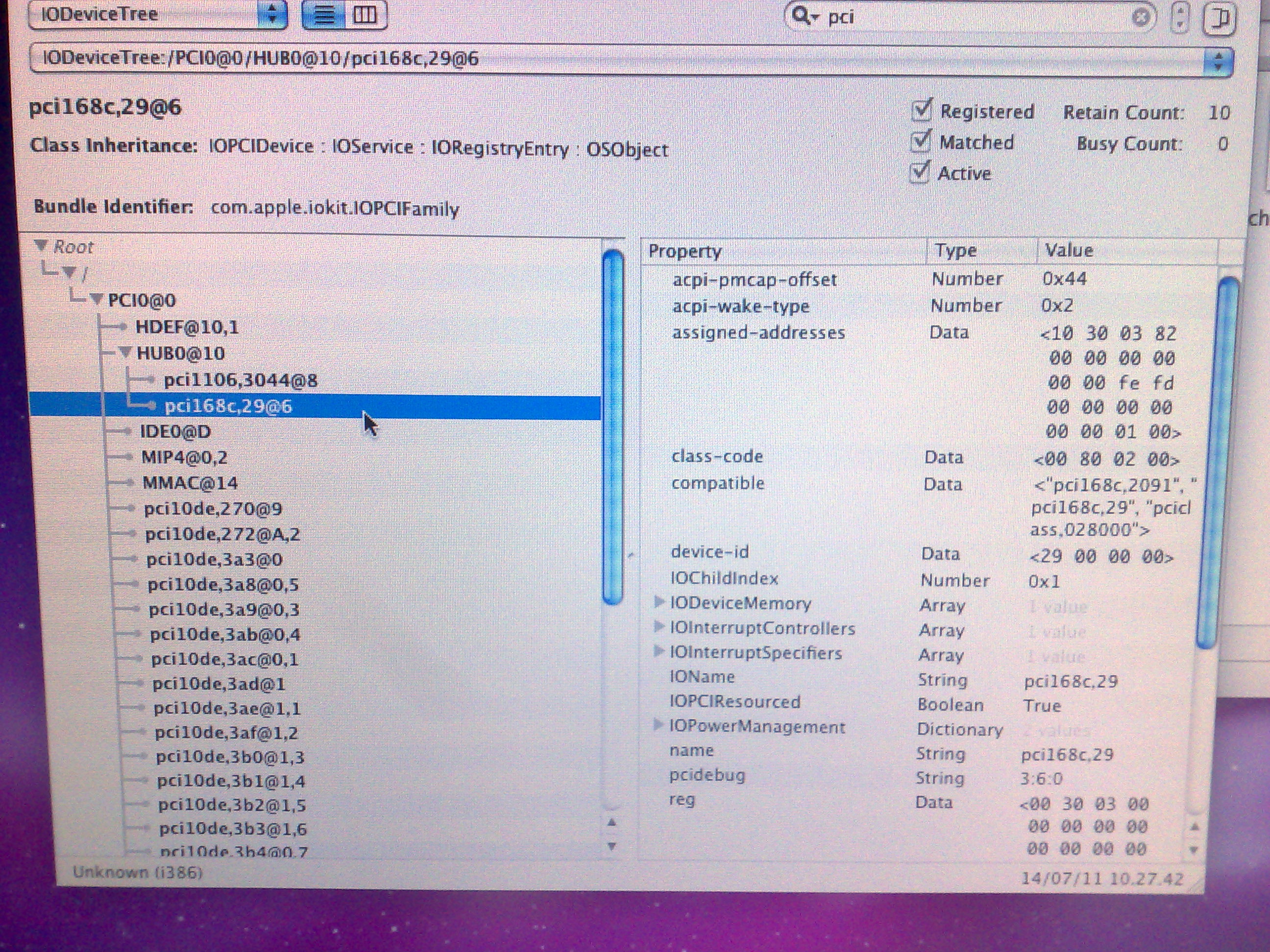

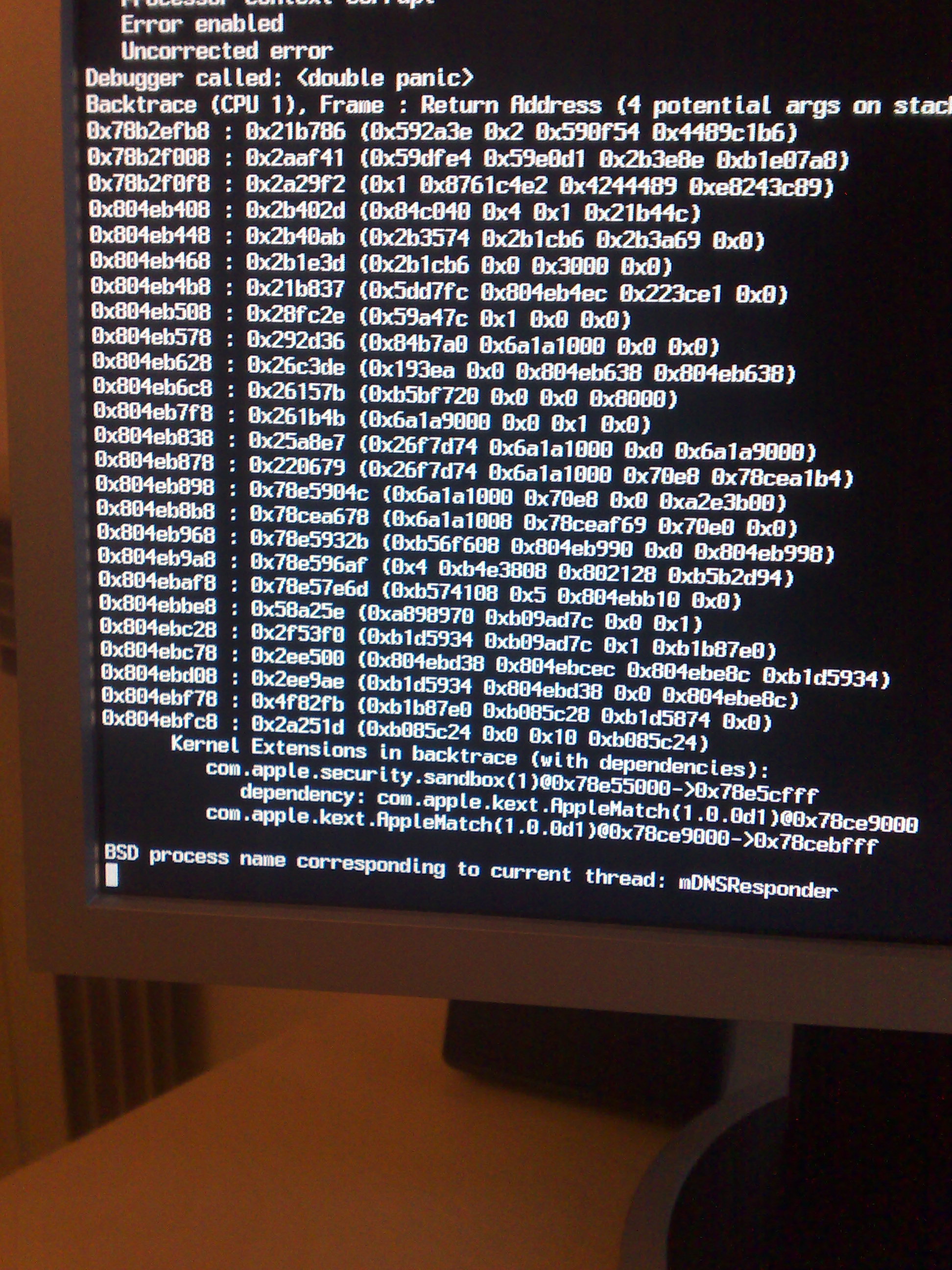

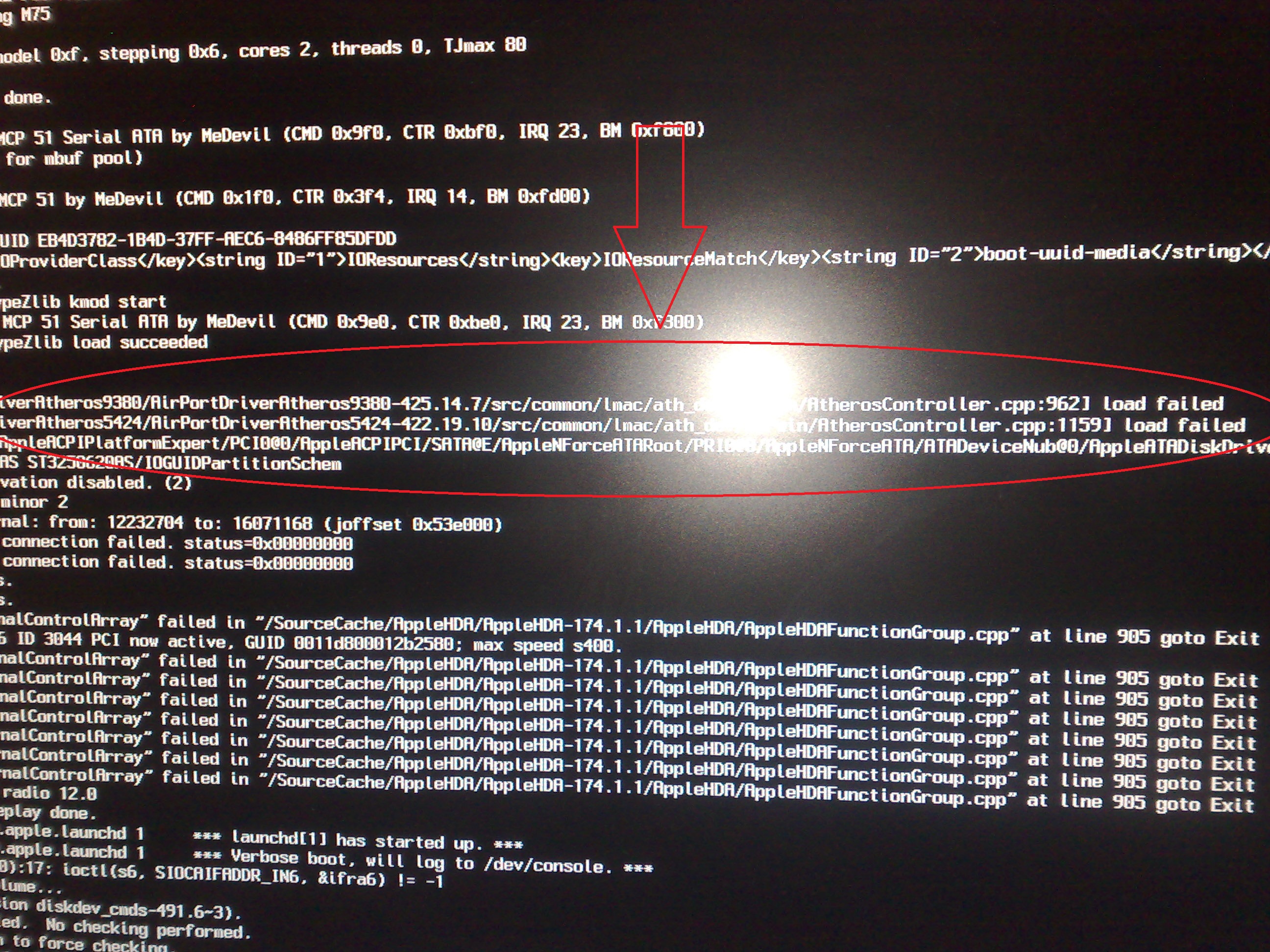

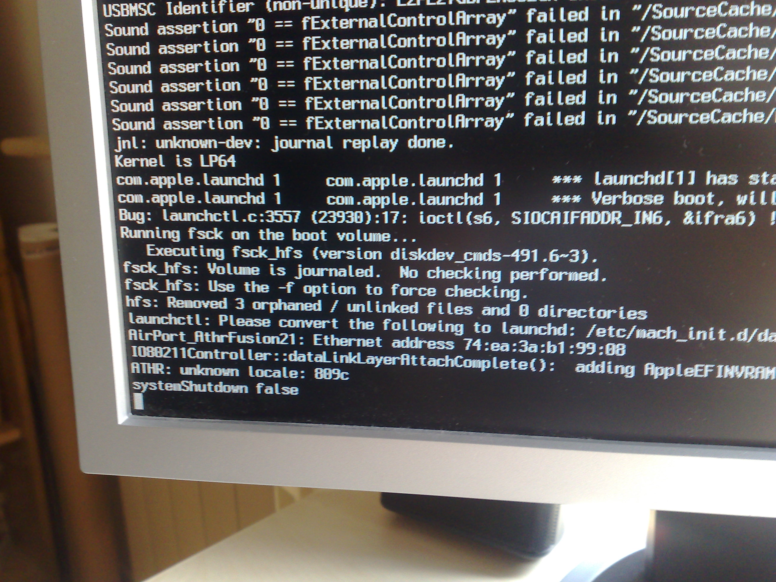

kilian Posted July 14, 2011 Author Share Posted July 14, 2011 Maybe we (you xD) have done something! In System Profiler --> PCI there are 3 devices. Geforce / pci168c,29 / pci(fireware) when i saw that i loud HOORRRAAAAW but still have KP. But these KP seems different i'll posto to you some some photos. Thanks for this, you're are the boss.. indeed! I've found 2 DSDT XP hahahah DSDT (patched: CMOS bug, VMWare Fusion slowness): http://www.mediafire.com/?rxsai2i370a3hy2 DSDT2: http://www.mediafire.com/?avs3d908as964d5 Link to comment Share on other sites More sharing options...
LatinMcG Posted July 14, 2011 Share Posted July 14, 2011 remove atherosfix .. i have to find proper location for the device id of airport. im close. boot -v -x and see if u can remove atherosfix. then reboot and see ioregegexplorer for location see if it changed 168c,24 did u change kernel also ?? dont first pic says mdnsresponder is crash.. likely lan or wireless. Link to comment Share on other sites More sharing options...
kilian Posted July 14, 2011 Author Share Posted July 14, 2011 Yes i writing on Windows, with Macdrive i can remove these kext xP with IO80211 original --> No airport / EDIT: so im going to look if 168c,29 changed to 168c,24? Right? =) Link to comment Share on other sites More sharing options...
LatinMcG Posted July 14, 2011 Share Posted July 14, 2011 Yes i writing on Windows, with Macdrive i can remove these kext xP with IO80211 original --> No airport / EDIT: so im going to look if 168c,29 changed to 168c,24? Right? =) atherosfix remove it..sleep enabler .. also. check bios to make sure hpet is enabled.. disable lan for a test. boot -v -f looking in imac9,1 i see smc-mcp not smc-napa hmm might have to edit the fakesmc i think Link to comment Share on other sites More sharing options...

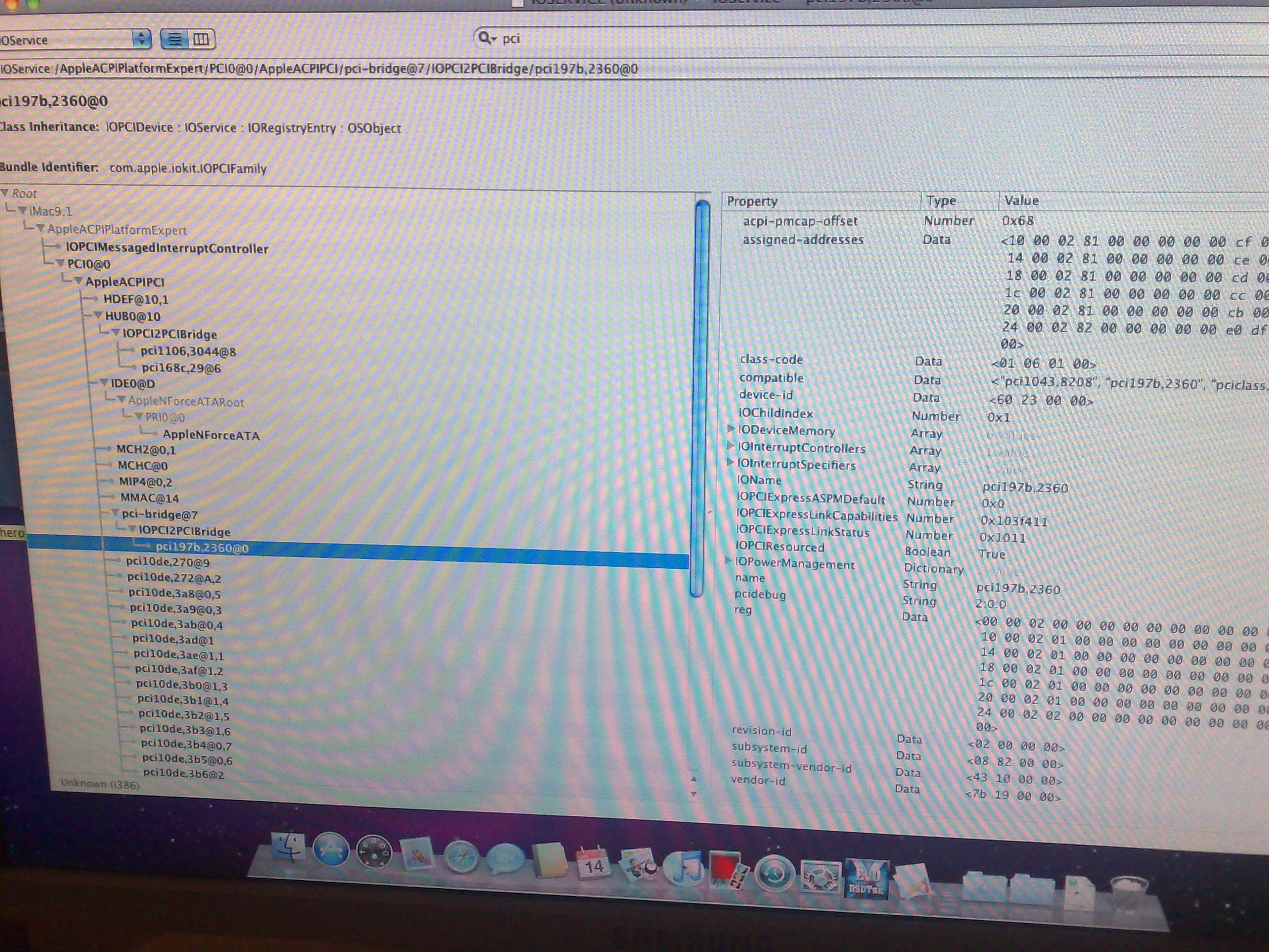

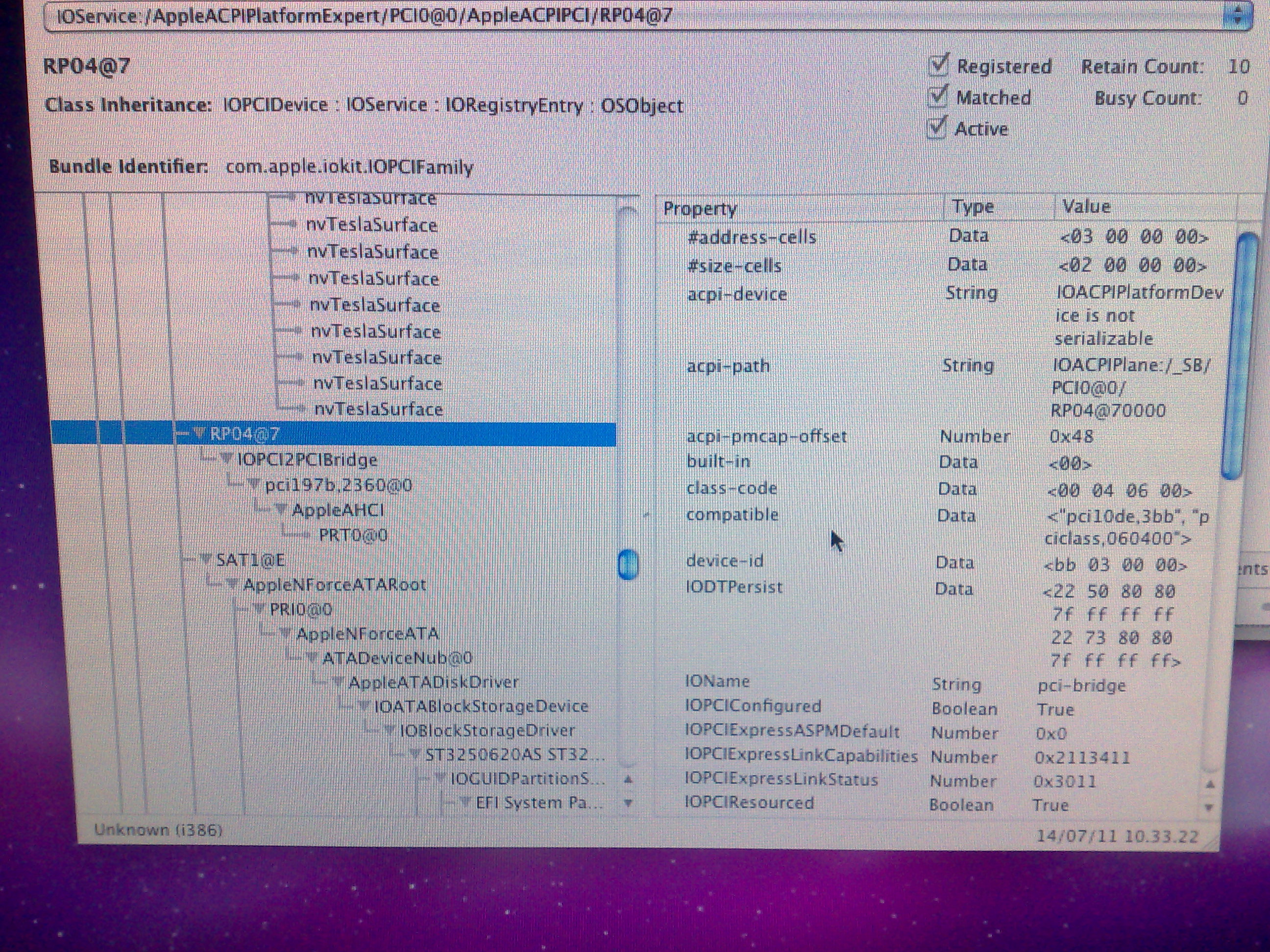

kilian Posted July 14, 2011 Author Share Posted July 14, 2011 Ok ill post to you new IOREG plus 2 photos! I'have saw differences: Like ---> pci.bridge@7 IOSERVICE.zip Link to comment Share on other sites More sharing options...
