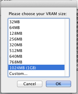

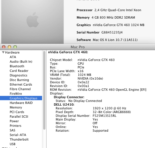

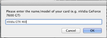

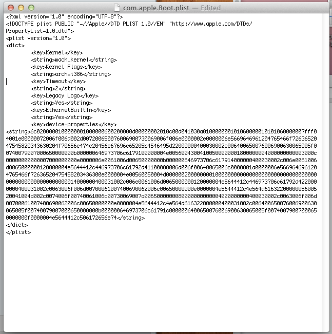

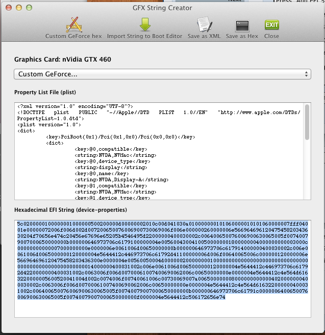

smylee Posted July 11, 2011 Share Posted July 11, 2011 Hi guys. I'v got fully working GTX460 on my Lion GM. All you need is OSX86Tools and 5 minutes of your time. First of all I removed NVEnabler.kext from /System/Library/Extensions/ Then generated string with OSX86Tools Run OSX86Tools Press "Add EFI Strings / Boot Flag" Press "GFX Strings" Press "Custom GeForce hex" Enter "nVidia GTX 460" Choose your VRAM size Choose your outputs configuration Copy Hex EFI String Go to "/Extra" folder, open "com.apple.Boot.plist" and add <key>device-properties</key><string> your hex EFI string here </string> Mine is looking like that Here's my string. string.txt I hope this post was helpful. Link to comment https://www.insanelymac.com/forum/topic/262140-asus-nvidia-gtx460-1gb-fully-working-no-enablersinjectors/ Share on other sites More sharing options...
pmontgomery01 Posted February 9, 2012 Share Posted February 9, 2012 THANK YOU! I tried your efi string and it didn't work but followed your instructions to make my own and it works! Link to comment https://www.insanelymac.com/forum/topic/262140-asus-nvidia-gtx460-1gb-fully-working-no-enablersinjectors/#findComment-1794567 Share on other sites More sharing options...
