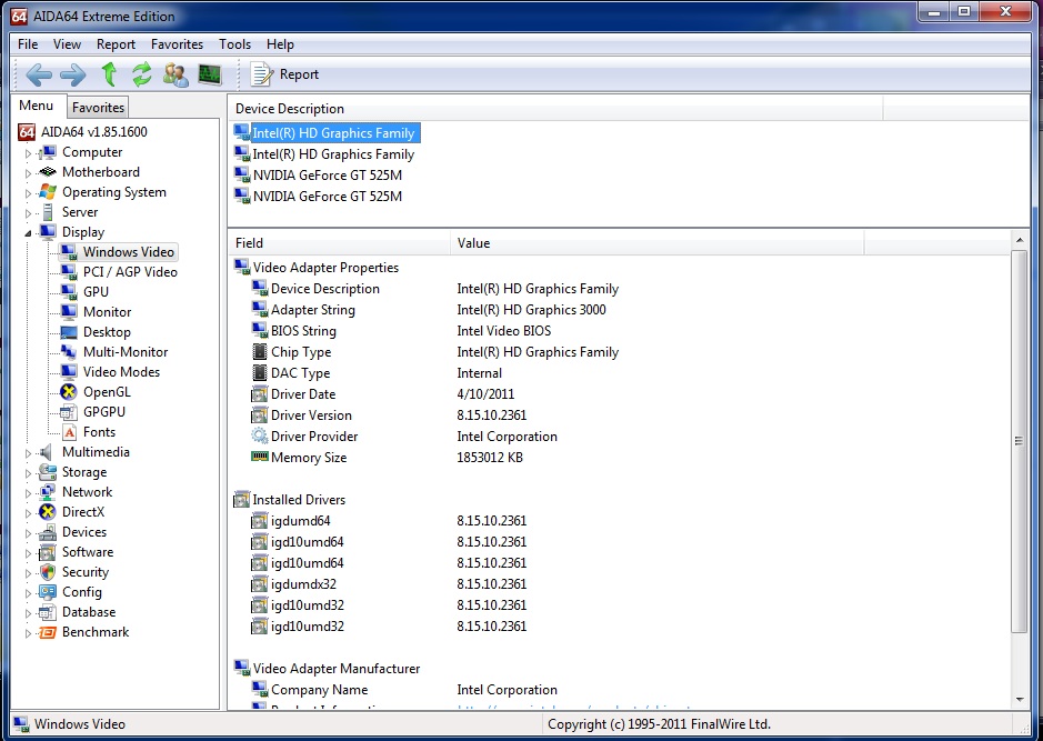

Mohamed Khairy Posted September 3, 2011 Share Posted September 3, 2011 i did some work for graphics this work take much time in doing it i just emulate apple macbookpro 6.1 8.1 8.3 ioregistery till now i just made intel gfx work from dsdt and nvidia card identified but not work till now there are a key that nearly link two gfx card "AAPL00,DualLink", Buffer (0x04) { 0x01, 0x00, 0x00, 0x00 }, this key if i add to igpu screen crash after boot may it need further work on gfx0 but the problem on that ioregestry of macbookpro have not comfortable on reading and comparing any way this is latest dsdt i did contain mald0n fixes atheros fix and intel gfx and work for applehda until we patch applehda i will try to fix nvidia card soon i hope that the problem isn't on driver and on work ido DSDT.aml.zip Link to comment https://www.insanelymac.com/forum/topic/262128-making-a-dsdt-for-dell-inspiron-15r-n5110-sandy-bridge/page/3/#findComment-1743895 Share on other sites More sharing options...

Mohamed Khairy Posted September 5, 2011 Share Posted September 5, 2011 i get a kp with this one. and in -v mode it hangs up, at random places as me too i think we need first to read about nvidia optimus spesically about our cards and see how signal goes to screen ether from intel or nvidia and also see how apple use two cards then we determine what we will do see in this picture there two ports to intel and also two ports to nvidia ithink we have to make anther port to intel on mac so we can use vga and hdmi and then we see what about nvidia if we found that it is useless hopeless we will disable it and save power als this my pc hd5770 ports you can understand Link to comment https://www.insanelymac.com/forum/topic/262128-making-a-dsdt-for-dell-inspiron-15r-n5110-sandy-bridge/page/3/#findComment-1744534 Share on other sites More sharing options...

Mohamed Khairy Posted September 5, 2011 Share Posted September 5, 2011 so, i think, we need to write internal lcd, so it would be recognized by the apple backlight kexts and it would be shown in info, and nvidia will work...i guess read this http://www.nvidia.com/object/LO_optimus_whitepapers.html and see last post here http://www.insanelymac.com/forum/index.php?showtopic=267048 now i am trying to make power management for nvidia card and forget it for ever then i go for editing apple frmbuffer for our laptop ports Link to comment https://www.insanelymac.com/forum/topic/262128-making-a-dsdt-for-dell-inspiron-15r-n5110-sandy-bridge/page/3/#findComment-1744828 Share on other sites More sharing options...
