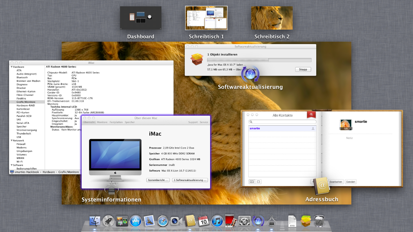

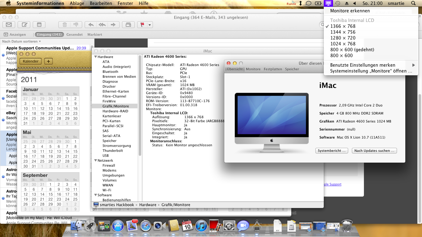

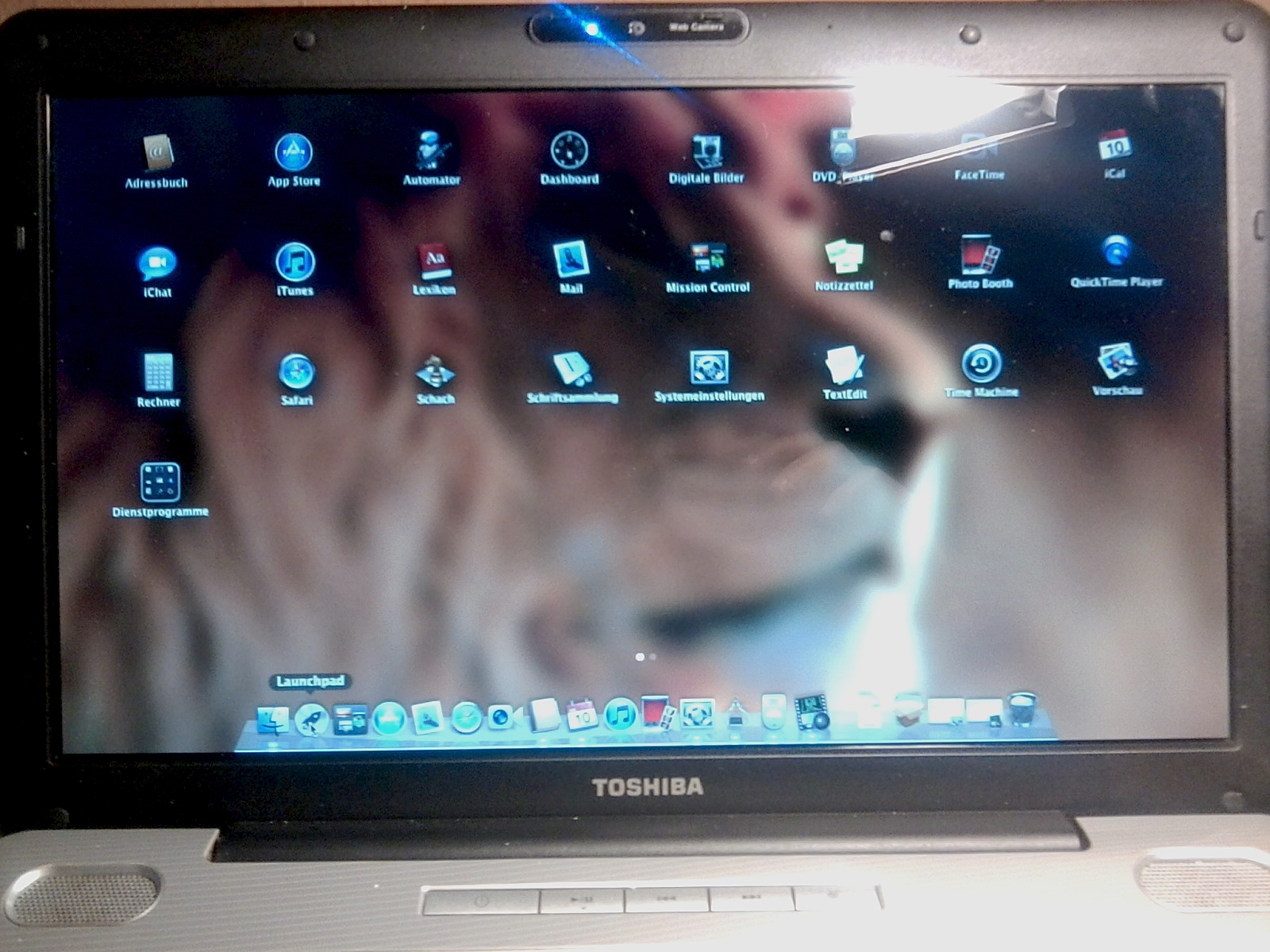

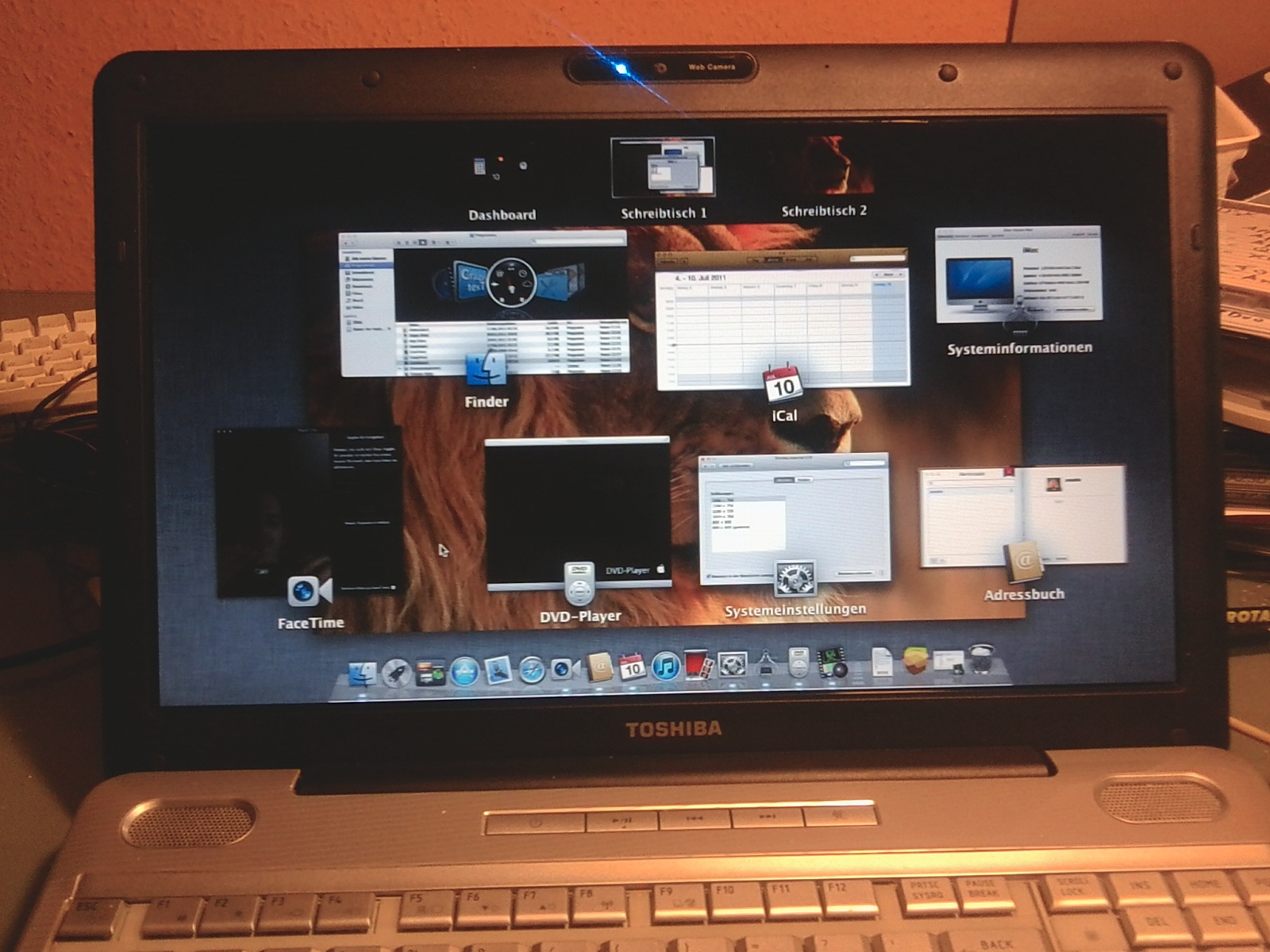

smartie77 Posted July 10, 2011 Share Posted July 10, 2011 NEW : GUIDE + kexts which covers all of the Satellite L500 hardware in Lion : please see this Only useful for ATI RADEON MOBILITY 4650 cards that have device ID of 9480 and use Shrike via LVDS. Confirmed working here QE/CI/OpenGL in a Satellite L500-120 Core2Duo with Phoenix BIOS. 1366x768 , 15.6 inch. THIS IS THE THREAD FOR LION GM ( FINAL ) -- for a QE/CI Snow Leo see my ( kextpack 10.6.8 ) thread here at insanelymac. so also forget about the "experimental" topic I started ( bad kexts and bad overall try and error ) , here is the real deal : ATY_INIT does not (yet) work ( in SL it does ), so back to a booter GraphicsEnabler shrike solution like I used early in SL. remember that Lion is 64bit only and the kexts are meant to used that way - make sure arch=x86_x64 is in boot.plist. You need the following packs, it contains everything needed . - device ID 9480 ( mobility 4650 / 70 ) ATI version 7.2.9 kexts and plugin,bundles from Lion Final ( GM ). They are prehexedited to output to LVDS using Shrike Framebuffer. VGA and HDMI out should also work. NEW LION ATI 7.2.9 LVDS 4650m kexts including plugins and bundles modded for Shrike LVDS,VGA and HDMI 4650mobilityLION_GM_ATI_ver7.2.9_KEXTS_put_in_S.L.E..zip Optional but very useful : For future OSX updates ( 10.7.1 and so on ) you can make the hex patching yourself and no longer need to put 9480 device ID into the kexts - put this LegacyATI4600controller.kext inside /Extra/Extensions and run the included script after each time Apple updates the ATI kexts . For the script to work correctly you must open it one time with textedit and replace the name of Harddisk partition to your name that you use in OSX . - credits to User akbarmoradi for this, is his work :No_Update_Pain.zip - ATI 4650 ROM, this goes in /Extra together with SMBIOS.plist and boot.plist ( all included ) EXTRA.zip - Special build of Lion compatible Chameleon, this is needed to make use of GraphicsEnabler=Yes ( Shrike FB forced on boot) , included a prefpane so you can edit the boot file via Systemsettings. shrike.boot Installer + prefpane : BOOT.set.graphicsenabler_yes.zip - Lion compatible kextutility : Kext_Utility.app.v2.5.0b.Lion.ready.jackieboy8.zip I can proudly say that cam twist works, so the UVC internal webcam can still be used in Photobooth ( amazing new effects ! ) and FaceTime/Quicktime etc. Also a Logitech C310 worked instantly on Lion. basically its all the same like in SL : put stuff in /extra, put ATI kexts ( and maybe the others ) in /S/L/E and repair permissions with the new kextulity. Remember to install the chameleon package inside, this will update also your boot file in / . SMBIOS 9,1 - 10,1 and 11,1 make sure that Fanspeed of 4650m gnu will work correctly. At the moment I use 11,1. In SL 9,1 worked best. Must try which is best for your CPU+GPU combination. Notes about some "strange things" : Scrolling in Lion is upside down ( must get used to it, it is annoying to me ) , and widgets have no ripple effect anymore - thats normal - because Dashboard is now no overlay but part of spaces/missioncontrol ) .. :-) You can see the difference if QE/CI is enabled, better : you feel it and will just know if it is on or not. The transparent menubar is maybe the only visual sign to show you it is on. With QE/CI everything is smooth as butter, without it is choppy,slow and jerky.. Also : the new version feature in Textedit.app ( which invokes a 3d time-machine like view ) won't work without QE/CI. Photobooth also needs QE/CI for its effects. DVDplayer of course,too. Notice : If the scrolling is so annoying like to me , please install "Scroll Reverser" for OSX, its freeware and works without reboot, can launch hidden on login = Old Snow Scrolling back again. My external Sitecom Wifi stick which uses Ralink kext and utility still works, installer of 10.6 used. Same true for Realtek R1xxx LAN card, also no problem. So I would say most kexts from SL can still be used, as long as they are fully 64bit aware. Link to comment https://www.insanelymac.com/forum/topic/262030-lion-kextpack-ati-4650mobility-9480-device-id-toshiba/ Share on other sites More sharing options...

smartie77 Posted July 10, 2011 Author Share Posted July 10, 2011 hi smartie77 what is the problem that you have with lion before and how you fix it?thanks Well my first Lion experiment just went totally wrong, I cannot recall why . I have been back to Snow in the meantime and installed Lion just this morning new to look again. Your ATY_init will not load in Lion, therefore the shrike booter is needed like I did first also with Snow. Also - I don't know for what reason the ATIRadeonX2000.kext from my first Lion install missed the plugin + bundles. Now on my installation of today they appeared in /S/L/E. I hex edited ATI4600controller for Shrike+LVDS ( just like your script does ), plus also VGA and HDMI out , based on my connectors. I did the 10029480 device inside plists of 4600controller and x2000 kext. Booted with this chameleon version here in x64 mode, GraphicsEnabler=Yes and the rom file in /Extra -- now working. Solution with ATY_Init for Shrike would be easier, but I don't see why your kext not loads. In SL it is working. But the effect is the same : QE/CI .. the main thing :-P Link to comment https://www.insanelymac.com/forum/topic/262030-lion-kextpack-ati-4650mobility-9480-device-id-toshiba/#findComment-1712214 Share on other sites More sharing options...
