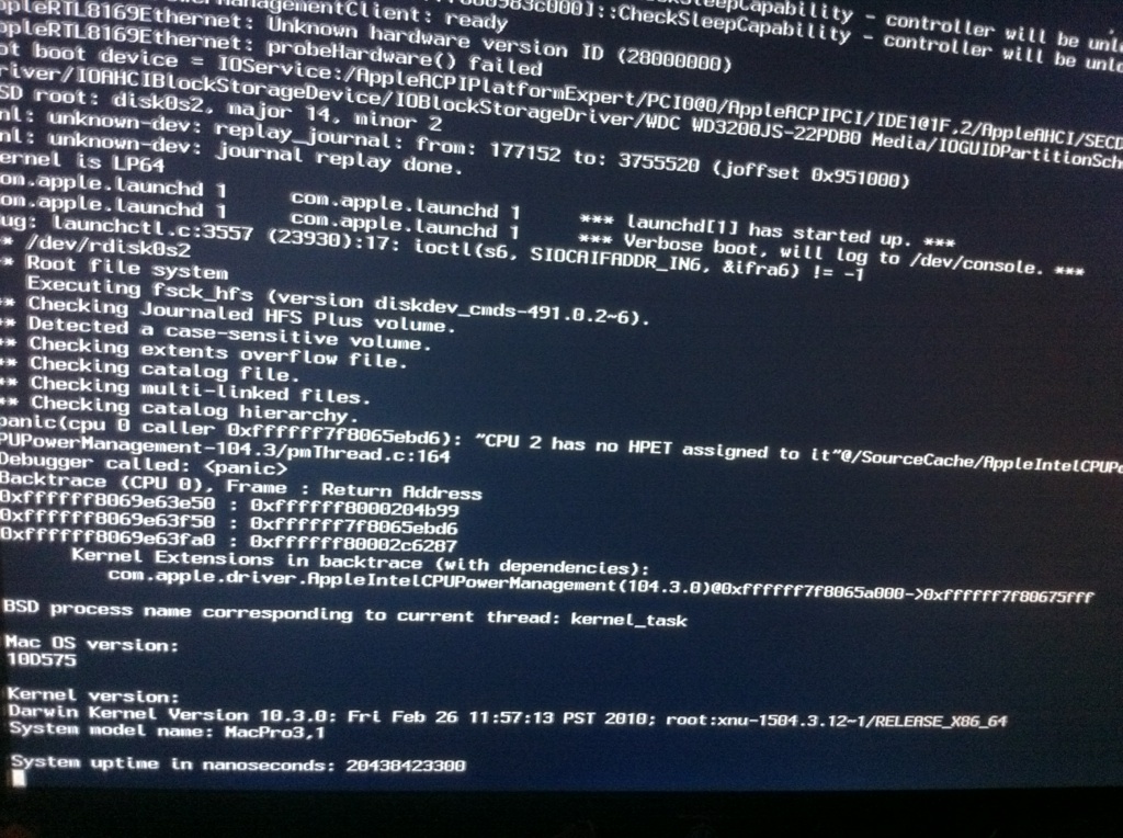

XeoDee Posted June 22, 2011 Share Posted June 22, 2011 So, this is the screen I get using Cham 2 RC 5 (Used the auto install from this forum) Im assuming something on the bios isn't correct. I can't even boot it using -v -x, however, [url="http://www.insanelymac.com/forum/topic/279450-why-insanelymac-does-not-support-tonymacx86/"]#####[/url] disk works fine with no -v or -x. Not sure why the boot hangs and stops here, perhaps some one with more knowledge can explain the kernel panic. GA-P43-ES3G [F12] Hardware Overview: Model Name: Mac Pro Model Identifier: MacPro3,1 Processor Name: Quad-Core Intel Xeon Processor Speed: 2.67 GHz Number Of Processors: 1 Total Number Of Cores: 4 L2 Cache: 8 MB Memory: 4 GB Bus Speed: 1.07 GHz Boot ROM Version: [url="http://www.insanelymac.com/forum/topic/279450-why-insanelymac-does-not-support-tonymacx86/"]#####[/url].tonymacx86.com Link to comment https://www.insanelymac.com/forum/topic/259972-boot-issues-cham-2-rc-5-osx-1063/ Share on other sites More sharing options...
Gringo Vermelho Posted June 22, 2011 Share Posted June 22, 2011 Enable HPET in the motherboard BIOS. Link to comment https://www.insanelymac.com/forum/topic/259972-boot-issues-cham-2-rc-5-osx-1063/#findComment-1701821 Share on other sites More sharing options...

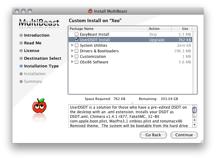

XeoDee Posted June 24, 2011 Author Share Posted June 24, 2011 This actually was already enabled. I did however resolve the problem by using [url="http://www.insanelymac.com/forum/topic/279450-why-insanelymac-does-not-support-tonymacx86/"]#####[/url]. I must have installed the DSDT wrong. GA-P43-ES3G dsdt.aml These settings. Link to comment https://www.insanelymac.com/forum/topic/259972-boot-issues-cham-2-rc-5-osx-1063/#findComment-1702445 Share on other sites More sharing options...
