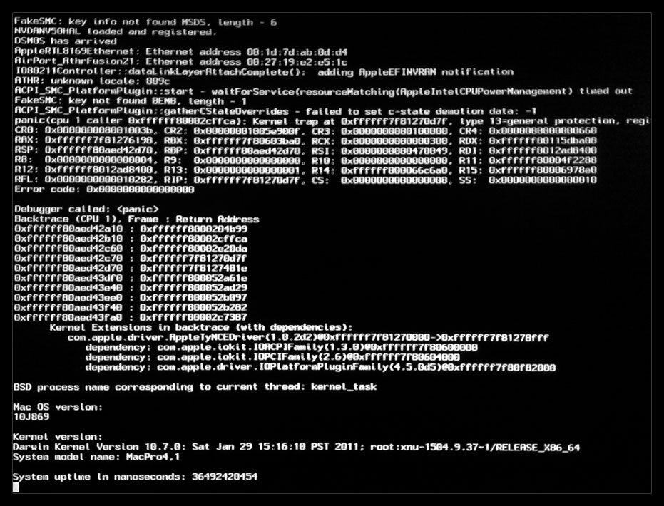

zalev Posted June 17, 2011 Share Posted June 17, 2011 Hi, Just updated the Chameleon using the [url="http://www.insanelymac.com/forum/topic/279450-why-insanelymac-does-not-support-tonymacx86/"]#####[/url] 3.7 and SL 10.6.7 won't boot It probably has something to do with the SMC. What steps should I take? Thanks in advance! Link to comment https://www.insanelymac.com/forum/topic/259574-kernel-panic-after-chameleon-update/ Share on other sites More sharing options...
ifrit05 Posted June 17, 2011 Share Posted June 17, 2011 I think you have to delete the AppleTyMCEDriver.kext from your /System/Library/Extensions/ folder. Link to comment https://www.insanelymac.com/forum/topic/259574-kernel-panic-after-chameleon-update/#findComment-1699407 Share on other sites More sharing options...
LatinMcG Posted June 17, 2011 Share Posted June 17, 2011 yea i had a similar on once. the fakesmc is bad. try a different version ... try dated 14.05.2011 Revision 493. Made by moodojo Release_10.6_rev493.zip ( 301.07K ) check that u dont have it 2 times. . /Extra and /System/Library/Extensions .. i only use it in /S/L/E atheros unknown locale 809c ?? hmm. helps if u post what mobo and video chip it is (or laptop model) and install method/ source used. found a post from u stating its p35-ds3L. are u using a dsdt ? but sounds like u picked wrong stuff in [url="http://www.insanelymac.com/forum/topic/279450-why-insanelymac-does-not-support-tonymacx86/"]#####[/url]. Link to comment https://www.insanelymac.com/forum/topic/259574-kernel-panic-after-chameleon-update/#findComment-1699411 Share on other sites More sharing options...
zalev Posted June 17, 2011 Author Share Posted June 17, 2011 I think you have to delete the AppleTyMCEDriver.kext from your /System/Library/Extensions/ folder. that solved the problem! booted successfully what is this kext responsible for? are there any negative aspects of having this removed from the system? Link to comment https://www.insanelymac.com/forum/topic/259574-kernel-panic-after-chameleon-update/#findComment-1699421 Share on other sites More sharing options...

ifrit05 Posted June 17, 2011 Share Posted June 17, 2011 ...what is this kext responsible for? are there any negative aspects of having this removed from the system? "Nehalem [Core i] ECC RAM support, could be used for more, will have to explore more. Problem with SMBIOS's identifying model as MacPro4,1, if so then make sure to delete AppleTyMCEDriver.kext, not needed for 90% of systems anyway." Here is a list of some kexts on Apple systems and what they are for: http://www.projectosx.com/forum/index.php?showtopic=102 Link to comment https://www.insanelymac.com/forum/topic/259574-kernel-panic-after-chameleon-update/#findComment-1699558 Share on other sites More sharing options...
