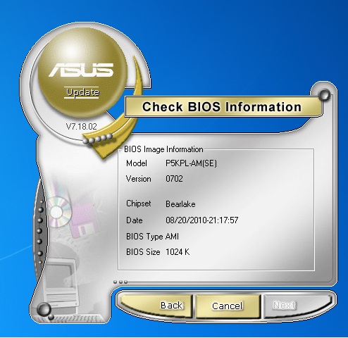

CratchNL Posted June 5, 2011 Author Share Posted June 5, 2011 Hi, this are the specs: Motherbord: ASUS P5KPL-AM(SE) Bios version: 0702 And i didn't use dsdt (i didnt know what it was but i looked it up and i didnt use it) Link to comment https://www.insanelymac.com/forum/topic/258380-mac-1067-and-realtek-rtl8102ertl8103e-no-internet/#findComment-1693114 Share on other sites More sharing options...
