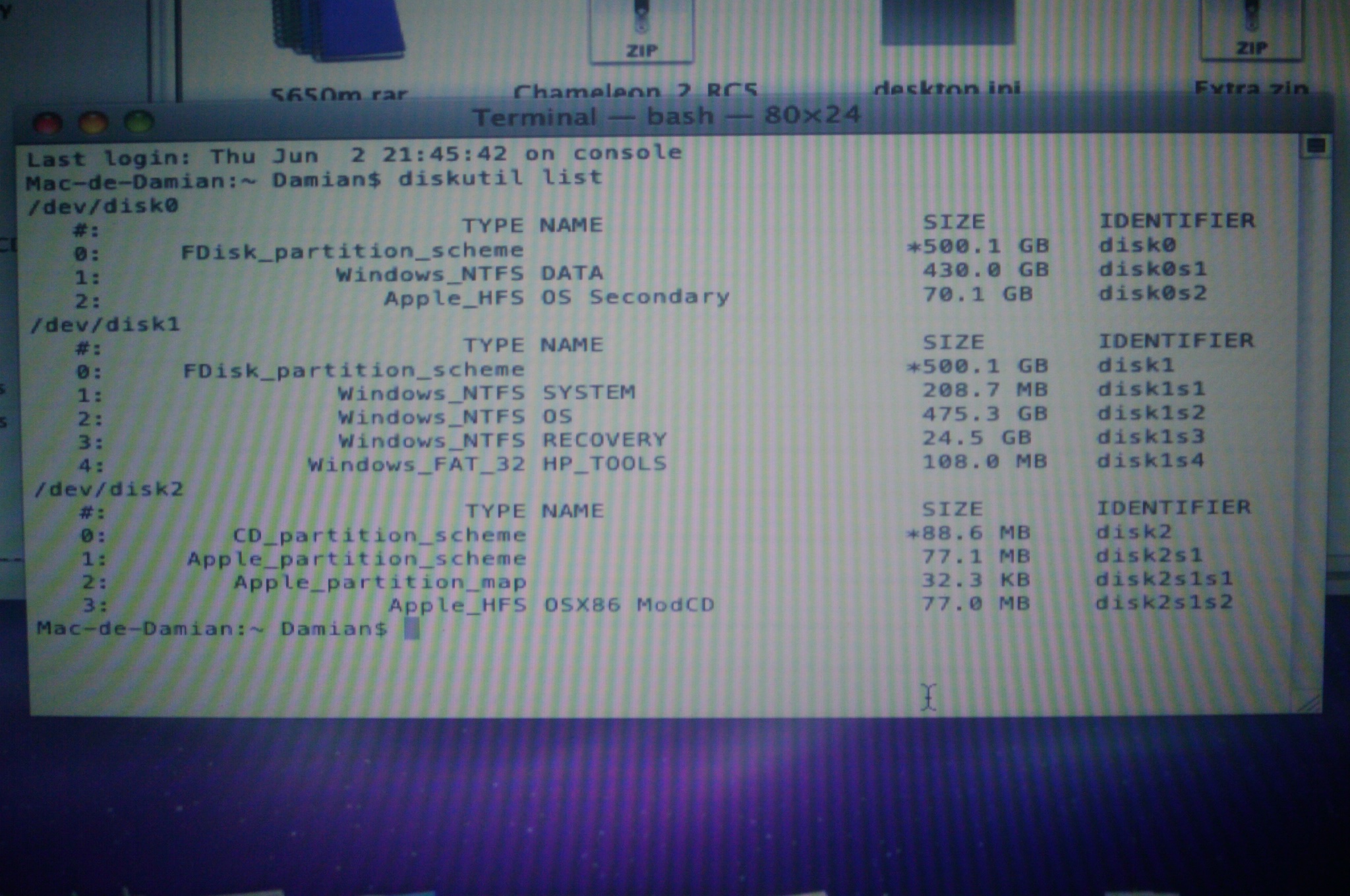

demian12 Posted June 3, 2011 Author Share Posted June 3, 2011 here a screenshot of Listing w7 in installed in: Windows_NTFS OS, IDENTIFIER: disk1s2 SL in installed in: Apple_HFS OS Secondary, IDENTIFIER:disk0s2 Link to comment Share on other sites More sharing options...
Gringo Vermelho Posted June 3, 2011 Share Posted June 3, 2011 If I'm reading it right, the drive you have installed Snow Leopard on doesn't have a Windows installation, just an NTFS data partition, right? Is it an external drive connected via USB? Can your laptop boot from USB? If you don't know, try a bootable flash drive. If so, this means you can safely install Chameleon to it without having to worry about Windows at all. Then just plug it in and boot from it when you want to run OS X. It's the easiest way and less prone to cause trouble than installing Chameleon to your Windows drive. This might not be an option for you but I would repartition and format the external drive to GPT using Disk Utility so that you can install retail OS X. Retail will not install to an MBR drive unless you modify some files in the installer packages. Apple's Disk Utility cannot create NTFS partitions but you could leave the data partition as FAT32 and then convert it to NTFS in Windows. Link to comment Share on other sites More sharing options...
demian12 Posted June 3, 2011 Author Share Posted June 3, 2011 name='Gringo Vermelho' date='Jun 3 2011, 05:17 AM' post='1692203']If I'm reading it right, the drive you have installed Snow Leopard on doesn't have a Windows installation, just an NTFS data partition, right? if, where the snow leopard installed, there is nothing inside. only mac os (with register) and NTFS with MBR mode Is it an external drive connected via USB? Can your laptop boot from USB? If you don't know, try a bootable flash drive. no, all partitions are shown, they are one HDD If so, this means you can safely install Chameleon to it without having to worry about Windows at all. Then just plug it in and boot from it when you want to run OS X. It's the easiest way and less prone to cause trouble than installing Chameleon to your Windows drive. This might not be an option for you but I would repartition and format the external drive to GPT using Disk Utility so that you can install retail OS X. Retail will not install to an MBR drive unless you modify some files in the installer packages. Apple's Disk Utility cannot create NTFS partitions but you could leave the data partition as FAT32 and then convert it to NTFS in Windows. being only one HDD, no way to make a dual boot? Link to comment Share on other sites More sharing options...
Gringo Vermelho Posted June 3, 2011 Share Posted June 3, 2011 no, all partitions are shown, they are one HDD I don't understand. Your diskutil list output shows exactly two 500 GB hard drives and a CD. being only one HDD, no way to make a dual boot? Yes it's possible but I can't help you with that. Link to comment Share on other sites More sharing options...

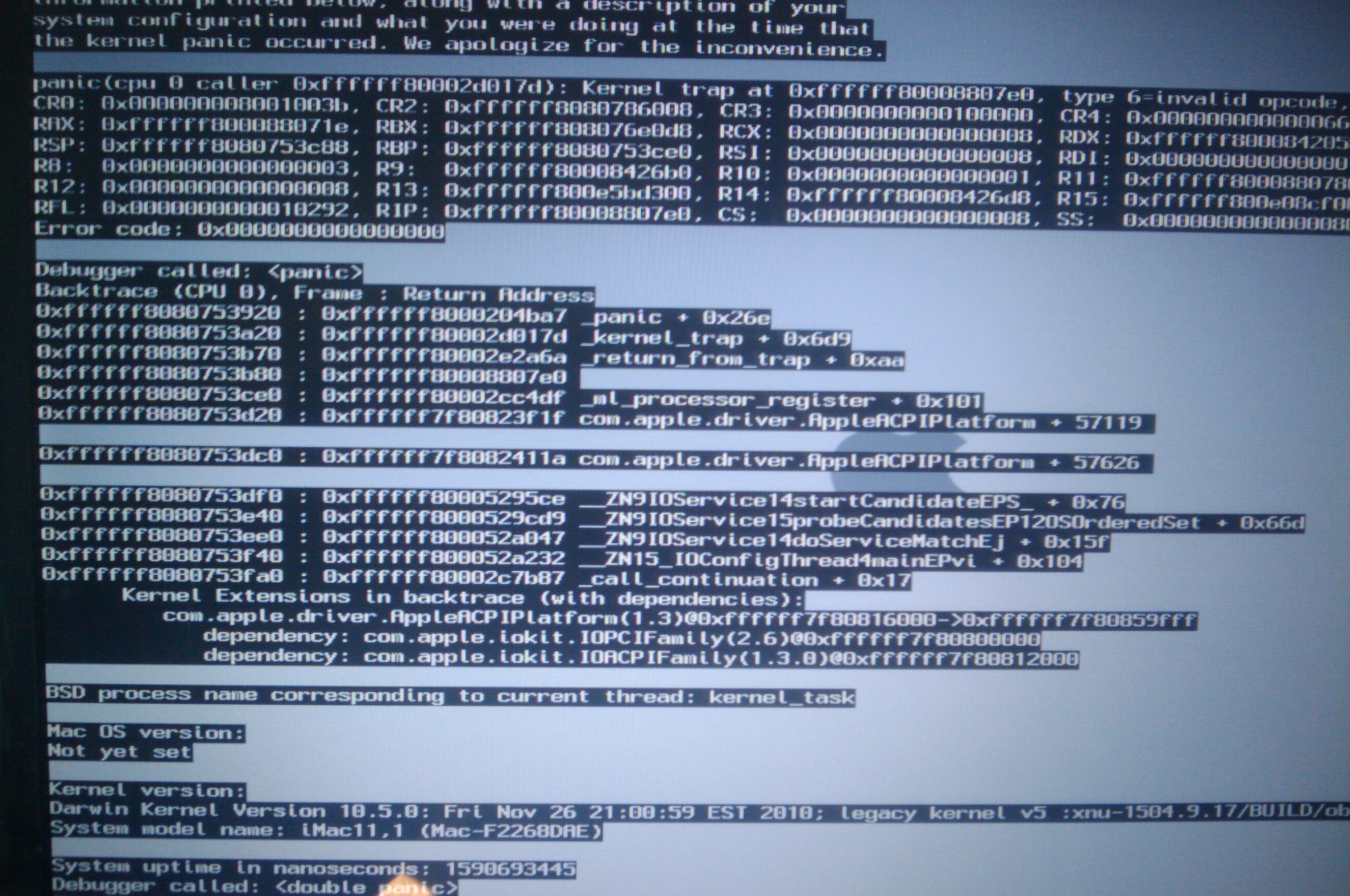

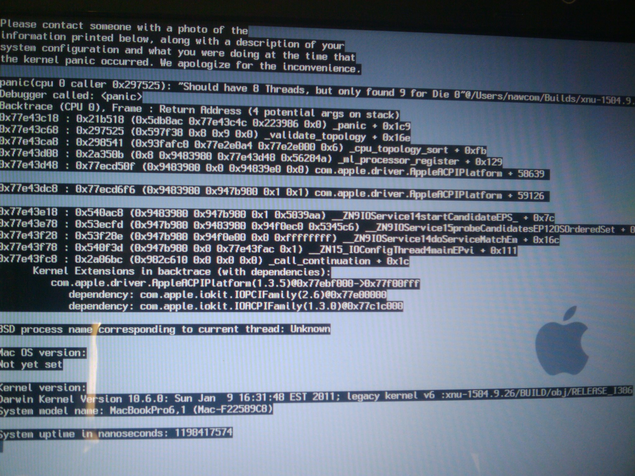

demian12 Posted June 3, 2011 Author Share Posted June 3, 2011 last consultation, may differ from this capture, if it's a kext problem or something mac system, or is it a problem that the boot partition not detected? PD:I do not mind loading mac os x from cdboot, but it is possible to load the kexts from the cd? Link to comment Share on other sites More sharing options...
Gringo Vermelho Posted June 3, 2011 Share Posted June 3, 2011 last consultation, may differ from this capture, if it's a kext problem or something mac system, or is it a problem that the boot partition not detected? Kernel panic in IOPCIFamily.kext, hardware/ACPI issue probably, has nothing to do with booting or partitions, you're already booting at this point. You're using a desktop Mac model identifier (iMac11,1) on a laptop. You should be using a laptop model identifier. Google/forum search smbios.plist for more information. PD:I do not mind loading mac os x from cdboot, but it is possible to load the kexts from the cd? Yes of course, otherwise boot CDs would not be very useful. Your boot CD is already loading kexts. Look inside preboot.dmg/initrd.img on the boot CD. If you want to learn more about the structure of a boot CD and which files are required, find a guide on how to make one. There are several out there. I have one posted over on the VoodooProjects forum. Link to comment Share on other sites More sharing options...

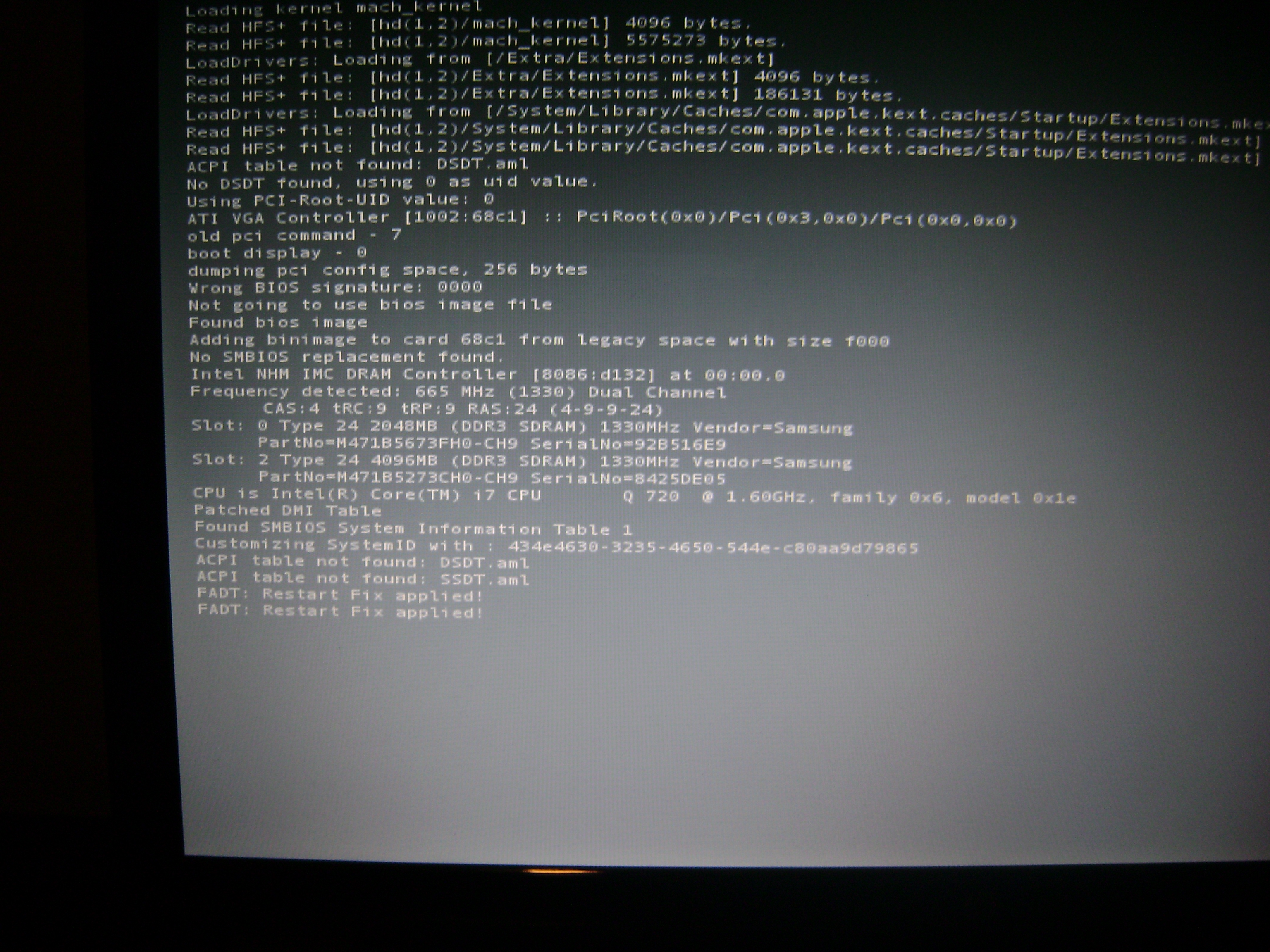

demian12 Posted June 3, 2011 Author Share Posted June 3, 2011 Well, after checking that the dual boot working, wipe the mac partition and install again. now when trying to boot mac os x (with chameleon), loading for a moment, loads the apple logo and restarts the pc. :S edit: here a screenshot of the boot from the disk, before rebooting automatically. at the top of the screen lacks this list of commands: *Read HFS+ file: [hd91,20/system/library/CoreServices/SystemVersion.plist] 475 bytes. *Hibernate image is too old by 14011 seconds. Use ForceWake=y to override *Loading Darwin 10.6 *Continuous capture here Link to comment Share on other sites More sharing options...
Gringo Vermelho Posted June 4, 2011 Share Posted June 4, 2011 All of those messages are from the Chameleon bootloader, at that point OS X hasn't started to load yet. I don't see anything wrong except it's bitching about your video card a bit. But I don't know if any of it is important, I don't know anything about ATI cards, sorry. Also "no smbios replacement found" means you have no smbios.plist in /Extra. Chameleon will set its own default values when no smbios.plist is found but those are not always the best for your hardware. My advice still stands, Google/forum search smbios.plist for more information. Chameleon is loading an Extensions.mkext from your extra folder. What's in it? What chipset (southbridge) does your laptop have? You might need to add drivers or patches for it to /Extra/Extensions in order for OS X to boot. It's difficult to help without more information, your screenshot does not give any clues about why it would restart during the boot process. Can you boot in safe mode? Try booting with -v -x and if you can get in then run console.app and look at kernel.log and system.log for clues. Link to comment Share on other sites More sharing options...

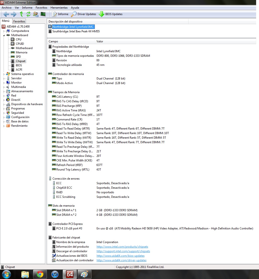

demian12 Posted June 4, 2011 Author Share Posted June 4, 2011 name='Gringo Vermelho' date='Jun 4 2011, 06:44 AM' post='1692638']All of those messages are from the Chameleon bootloader, at that point OS X hasn't started to load yet. I don't see anything wrong except it's bitching about your video card a bit. But I don't know if any of it is important, I don't know anything about ATI cards, sorry. Also "no smbios replacement found" means you have no smbios.plist in /Extra. Chameleon will set its own default values when no smbios.plist is found but those are not always the best for your hardware. My advice still stands, Google/forum search smbios.plist for more information. well, now enclose some screenshots with all the information. I hope that this can give me an idea of how to setup: smbios.plist Chameleon is loading an Extensions.mkext from your extra folder. What's in it? In Extensions.mkext: Found 11 kexts: /Volumes/OS Secondary/Extra/Extensions/AppleACPIPS2Nub.kext - com.yourcompany.driver.AppleACPIPS2Nub (1.0d1) /Volumes/OS Secondary/Extra/Extensions/ApplePS2Controller.com.kext - com.apple.driver.ApplePS2Controller (1.1) /Volumes/OS Secondary/Extra/Extensions/ApplePS2Controller.kext/Contents/Plugins/ApplePS2Keyboard.kext - com.apple.driver.ApplePS2Keyboard (1.2) /Volumes/OS Secondary/Extra/Extensions/ApplePS2Controller.kext/Contents/plugins/ApplePS2Mouse,kext - com.apple.drover.applePS2Mouse (1.2) /Volumes/OS Secondary/Extra/Extensions/fakesmc.kext - org.netkas.fakesmc (2.0) /Volumes/OS Secondary/Extra/Extensions/IOAHCIBlockStorageInjector.kext - org.chameleon.plist.IOAHCIBlockStorageInjector (1.1.1) /Volumes/OS Secondary/Extra/Extensions/IONetworkingFamily.kext - com.apple.iokit.IONetworkingFamily (9.9) /Volumes/OS Secondary/Extra/Extensions/IONetworkingFamily.kext/Contents/Plugins/RealtekRTL81xx.kext - com.Inx2mac.driver.RealtekRTL81xx (0.0.67) /Volumes/OS Secondary/Extra/Extensions/NullCPUPowerManagement.kext - org.tgwbd.driver.NullCPUPowerManagement (1.0d2) /Volumes/OS Secondary/Extra/Extensions/TotallyFixStillWaiting.kext - com.objection.TotallyFixStillWaiting.smith@@ (1.0) /Volumes/OS Secondary/Extra/Extensions/VoodooBattery.kext - com.superhai.driver.VoodooBattery (1.3.3) PD: in /system/library/extensions/ there are 175 kext, is it normal? What chipset (southbridge) does your laptop have? You might need to add drivers or patches for it to /Extra/Extensions in order for OS X to boot.It's difficult to help without more information, your screenshot does not give any clues about why it would restart during the boot process . look at the attached screenshots Can you boot in safe mode? Try booting with -v -x and if you can get in then run console.app and look at kernel.log and system.log for clues. does not start, loads a kext list, about 4 or 5 pages, and restarts Link to comment Share on other sites More sharing options...
