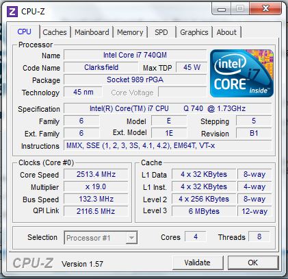

ifrit05 Posted May 27, 2011 Share Posted May 27, 2011 Download and install cpu-z. Run it and take a picture of the main window. (CPU info/details list.) To understand what VT-x is, read this page on Wikipedia about VT-x/AMD-V. Link to comment Share on other sites More sharing options...
jianh Posted May 27, 2011 Author Share Posted May 27, 2011 Download and install cpu-z. Run it and take a picture of the main window. (CPU info/details list.) To understand what VT-x is, read this page on Wikipedia about VT-x/AMD-V. Here it is Link to comment Share on other sites More sharing options...
ifrit05 Posted May 27, 2011 Share Posted May 27, 2011 Ok, so it does support VT-x. Go into your BIOS and see if it's disabled somewhere. Link to comment Share on other sites More sharing options...
