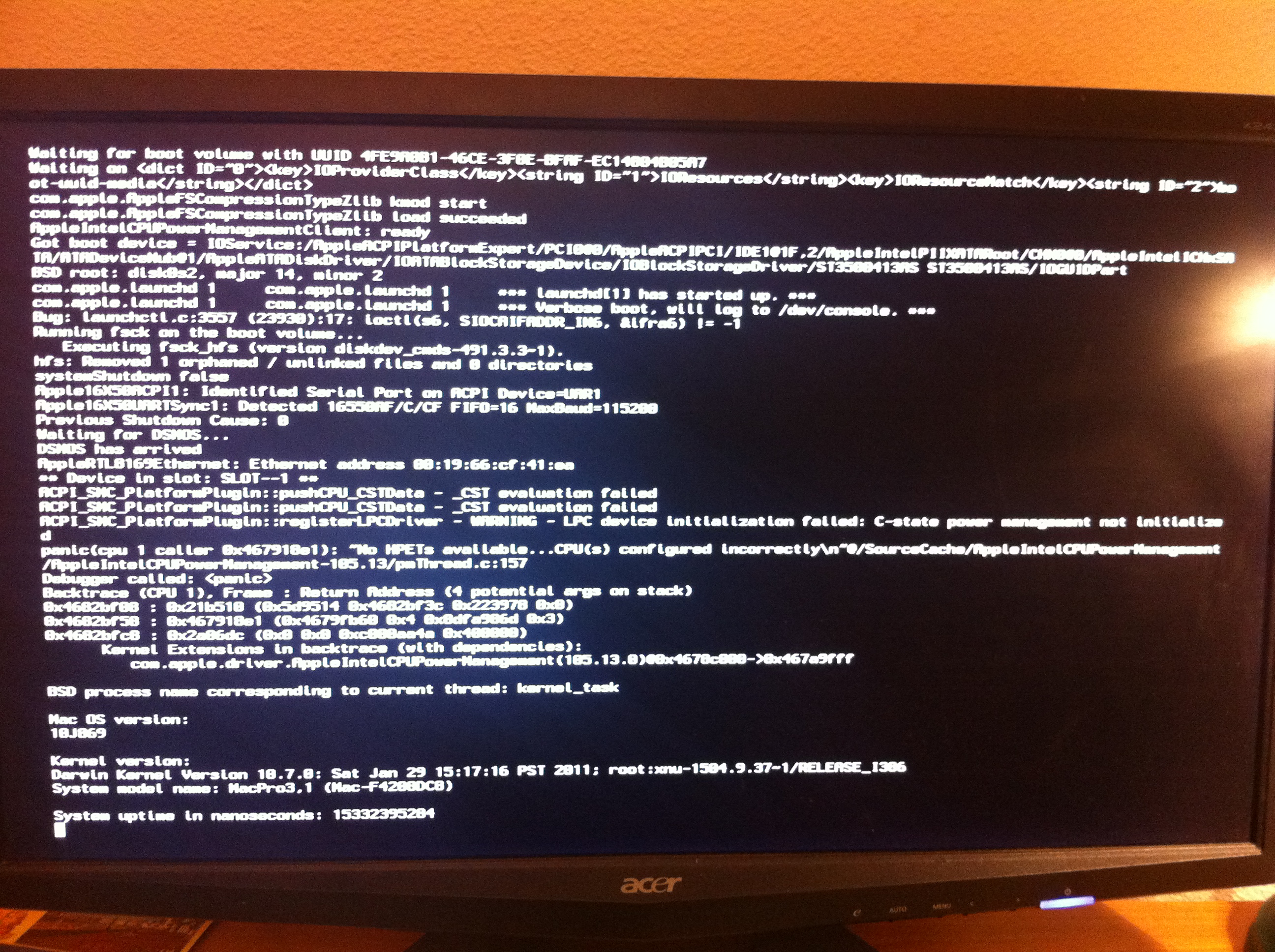

ldiqual Posted May 24, 2011 Author Share Posted May 24, 2011 I followed these steps: - Removed EvOreboot and Disabler - Extracted dsdt.aml to /Extra folder - Installed Chameleon RC5 from here - Added the four lines you indicated I get a kernel Panic with the following content: This happens even if I disable USBLegacy in BIOS Settings, or use USBLegacyOff=Yes in bootloader options. If I restore Disabler.kext, everything is ok. Any idea ? Thank you very much for your great help ! Link to comment https://www.insanelymac.com/forum/topic/257729-ich7-usb-conflict-on-asrock-g31m-s/#findComment-1688168 Share on other sites More sharing options...
MaLd0n Posted May 24, 2011 Share Posted May 24, 2011 I followed these steps:- Removed EvOreboot and Disabler - Extracted dsdt.aml to /Extra folder - Installed Chameleon RC5 from here - Added the four lines you indicated I get a kernel Panic with the following content: This happens even if I disable USBLegacy in BIOS Settings, or use USBLegacyOff=Yes in bootloader options. If I restore Disabler.kext, everything is ok. Any idea ? Thank you very much for your great help ! HPET enable in bios? Use Lizard http://www.insanelymac.com/forum/index.php...st&id=86246 look it Link to comment https://www.insanelymac.com/forum/topic/257729-ich7-usb-conflict-on-asrock-g31m-s/#findComment-1688179 Share on other sites More sharing options...

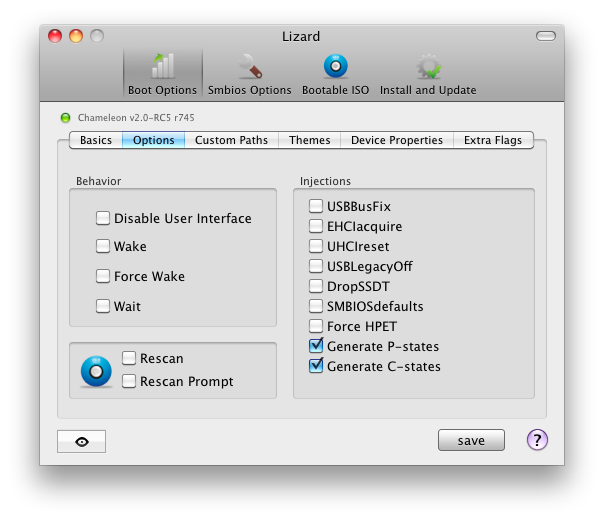

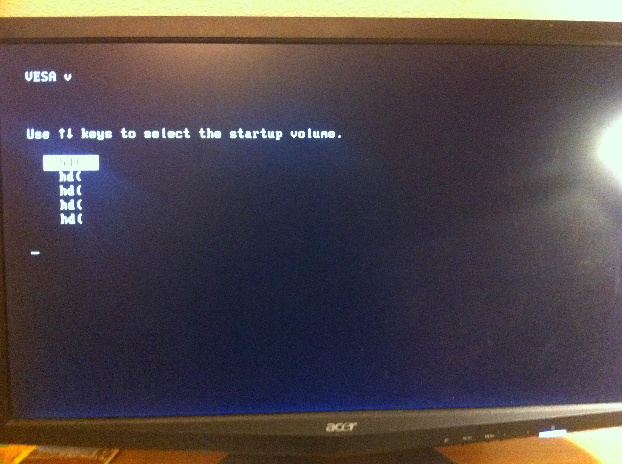

ldiqual Posted May 24, 2011 Author Share Posted May 24, 2011 Oh, sorry, I forgot to enable HPET in BIOS. Now, OSX boots with the new DSDT, but only when LegacyUSB is disabled in BIOS. When it isn't, i get a really weird Chameleon: I tried to enable the two options in Lizard, but it doesn't change anything (as I suppose they are boot options, it's normal). Any chance to get it boot with USBLegacy enabled in BIOS ? Again, thanks for everything ! Link to comment https://www.insanelymac.com/forum/topic/257729-ich7-usb-conflict-on-asrock-g31m-s/#findComment-1688200 Share on other sites More sharing options...
MaLd0n Posted May 24, 2011 Share Posted May 24, 2011 Any chance to get it boot with USBLegacy enabled in BIOS ?Again, thanks for everything ! :S I have no idea try with USBBusFix=Yes Link to comment https://www.insanelymac.com/forum/topic/257729-ich7-usb-conflict-on-asrock-g31m-s/#findComment-1688205 Share on other sites More sharing options...
