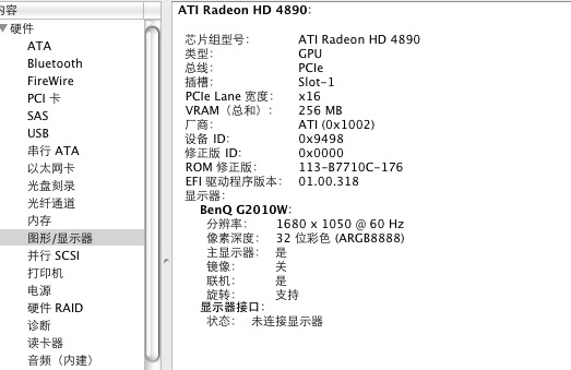

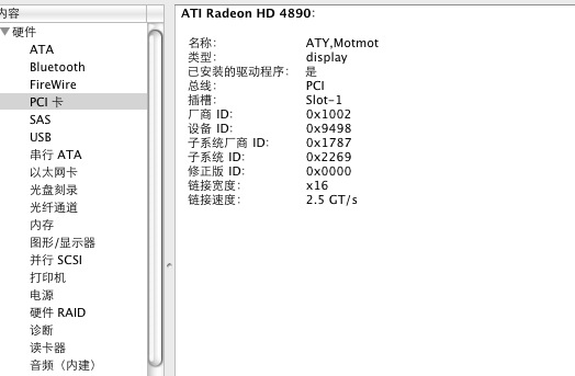

px1396 Posted May 22, 2011 Share Posted May 22, 2011 Hi,All, My Graphic Card is Dataland ATI HD4650.I made the DSDT.AML file by Using iDSDT w/ Motherboard BIOS & Graphic Card BIOS File. Now the Card was ident identifed as ATI HD 4890, Resolution & QE/CI is OK, But I can only get the image through a DVI2VGA connector from DVI Port, So What is the matter and How can I Get the image from DVI Port without a DVI2VGA Connector? Thanks a lot!! Link to comment https://www.insanelymac.com/forum/topic/257581-help-a-wrong-identification-of-ati-ht4650/ Share on other sites More sharing options...
smartie77 Posted May 22, 2011 Share Posted May 22, 2011 Hi,All, My Graphic Card is Dataland ATI HD4650.I made the DSDT.AML file by Using iDSDT w/ Motherboard BIOS & Graphic Card BIOS File. Now the Card was ident identifed as ATI HD 4890, Resolution & QE/CI is OK, But I can only get the image through a DVI2VGA connector from DVI Port, So What is the matter and How can I Get the image from DVI Port without a DVI2VGA Connector? Thanks a lot!! try a different framebuffer, i.e shrike instead of motmot Link to comment https://www.insanelymac.com/forum/topic/257581-help-a-wrong-identification-of-ati-ht4650/#findComment-1687054 Share on other sites More sharing options...
plsh2me Posted May 24, 2011 Share Posted May 24, 2011 try a different framebuffer, i.e shrike instead of motmot Same problem here. I have tried Linearburn's new beta4, no result. I have the Radeon HD 550v (id- 1002_9480 subsys- 0447). smartie77 Could you provide a different framebuffer.... Link to comment https://www.insanelymac.com/forum/topic/257581-help-a-wrong-identification-of-ati-ht4650/#findComment-1688151 Share on other sites More sharing options...

ytrox Posted May 25, 2011 Share Posted May 25, 2011 usually your card doesn't use motmot. you can do a couple of things: remove your viedeo.rom and any dsdt injection (if there are); use kabyl boot and change AtiConfig to peregrine or shrike (they are the standard framebuffers for this card); change bootloader; Link to comment https://www.insanelymac.com/forum/topic/257581-help-a-wrong-identification-of-ati-ht4650/#findComment-1688321 Share on other sites More sharing options...
