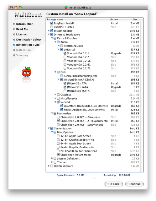

tepaks Posted August 19, 2011 Share Posted August 19, 2011 Hi Guys, So far I had no success with any boot CD and retail DV combination. Only distro that partially works with my T3-P5G965 was hazard 10.6.6i. but only in 32bit mode. I've treed both original and pached bios, same difference. I've treed to replicate yours methods but this is what i got using AHCI bios + [url="http://www.insanelymac.com/forum/topic/279450-why-insanelymac-does-not-support-tonymacx86/"]#####[/url] + retailDVD + [url="http://www.insanelymac.com/forum/topic/279450-why-insanelymac-does-not-support-tonymacx86/"]#####[/url] + DSDT.aml I can't get it to boot without CD. With CD, it boots to 32bit mode, everithing works except onboard VGA (1024x768 only) Without CD it stops at [ PCI configuration begin ] Can You please provide more details of your method? T3-P5G965 Core2DUO 4Gb RAM SATA DVD/RW/DL SATA HDD nVidia 8400GS 512 PCIe EDIT: I've finally got it fully working in 64bit mode with official ASUS BIOS; x86 mod boot CD; retail 10.6 DVD; nVidia 8400GS; 10.6.8 Combo; Realtek cardreader fix and edited NVDANV50Hal.kext n.b. it also works with ATI 4650 HD and modded kexts but HD performance is poor with full HD content Link to comment https://www.insanelymac.com/forum/topic/256977-asus-terminator-t3-p5g965-working-dsdt/#findComment-1737028 Share on other sites More sharing options...
