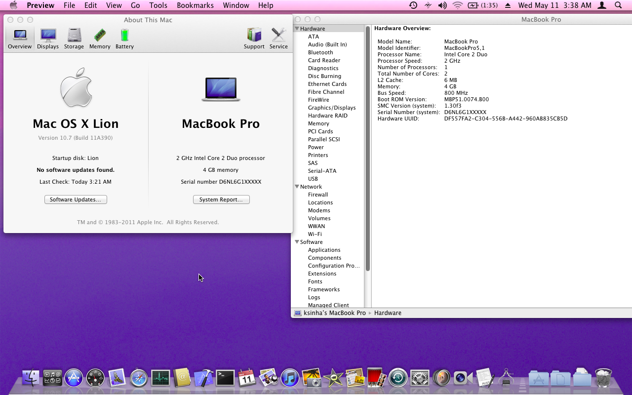

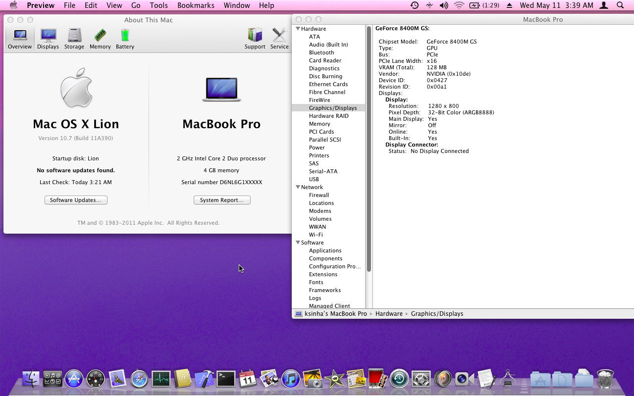

charlie565 Posted May 10, 2011 Share Posted May 10, 2011 I have a Dell Optiplex 755 PC running OS X 10.6.x for while now with the following hardware content: Processor: Q6600 RAM: 4GB PC2 5300 Graphics: Nvidia GeForce 8400GS 512MB HDD: 320 GB Segate , 200 GB Seagate, 1 TB Seagete Before we go further I'd like to underline: Have tested Mac OS X on a PC hardware first by a downloaded version to make sure it works, than I bought a legal copy of 10.5 Leopard and a 10.6 Snow Leopard later on from Apple. I will do the same as soon as the 10.7 Lion retail version is available in store. If you find Mac OS X useful on your PC, please buy it. It costs "a massive amount of" £26.00, which is just a fracture of a Windows' price. When Lion Developer Preview 2 has appeared on torrent sites, I decided to give it a go on my Optiplex 755 Hackint0sh. As I've been reading this forum for quite a long time now to get various OS X versions installed on my PC hardware and enjoyed all the benefits of this amazing forum, I thought it's time to contribute something towards this enthusiastic community. Ingredients for the successful 10.7 Lion installation: Any type of a basic Hackint0sh or a Mac for no more than to prepare a USB install drive. Mac OS X 10.7 Lion DP 2.dmg USB drive at least 8GB Chameleon 2 RC3 r658 install package (see attachment) Modified Chameleon boot file for Lion by Netkas (see attachment) /Extra folder from 10.6.7 system with minimal kext requirements (see attachment)Including:/Extra/com.apple.Boot.plist/Extra/Extensions.mkext/Extra/smbios.plist/Extra/Extensions/ElliottForceLegacyRTC.kext/Extra/Extensions/EvOreboot.kext Kext files required by Optiplex 755 in /System/Library/Extensions/ (see attachment)Including:fakesmc.kextIntel82566MM.kext for the on board network cardNVEnabler64.kext for Nvidia cards above than GeForce 8xxx modelsVoodooHDA.kext for the on board audio card The /Extra/com.apple.Boot.plist file will call a 64bit kernel, therfore all the kext files used and the Extensions.mkext file are 64bit versions. Please note, that 10.7 Lion supports only 64 bit kernel in native mod at the moment. You can force to boot in 32 bit mode by arch=i386 boot flag in Chameleon's command line. However, it could lead to a kernel panic. Than let's cook: You can't install Lion from a DVD on a PC, because the setup boot process wants to start the BaseSystem.dmg file as a secondary boot process from the DVD and it is not supported by Chameleon boot loader at the moment. We need to prepare a USB install drive Open 'Mac OS X 10.7 Lion DP 2.dmg', it opens 'Mac OS X Install ESD' virtual disk Open 'BaseSystem.dmg' from here, it opens 'Mac OS X Base System' virtual disk Create a GUID partition on your USB install drive Restore 'Mac OS X Base System' to a USB drive - called 'Lion_Setup' in this guide From the restored USB drive delete /System/Installation/Packages alias Copy /Volumes/Mac OS X Install ESD/Packages/ to /Volumes/Lion_Setup/System/Installation/ Install Chameleon_2_RC3_r658.pkg on the 'Lion_Setup' drive - credit goes to the Chameleon Team for their fantastic boot loader, many thanks for it.Replace the boot file by the 'Modified Chameleon boot file for Lion by Netkas' - of course credit goes to Netkas (brilliant job again, thanks) Copy the content of 'Extra_minimal_gx755.zip' to 'Lion_Setup', keep the original /Extra/Themes/ folder untached Copy the content of 'GX755.zip' to the 'Lion_Setup' drive Install 10.7 Lion on your hard drive Boot into 'Lion_Setup' and perform the install. Create a new GUID partition for the operating system - called 'LION' in this guide. At the end of the install you have 10s to get into Utilities>Terminal. If you are too slow, let the system to restart. After restart, boot into the USB install drive again and open terminal cp -R /Volumes/Lion_Setup/GX755/Kext/* /Volumes/LION/System/Library/Extensions/ chmod -R 755 /Volumes/LION/System/Library/Extensions chown -R root:wheel /Volumes/LION/System/Library/Extensions Reboot your computer. Select Lion_Setup as a boot device, press F8 to select boot partition, select the newly installed LION partition to boot with -v boot flag. Complete the initial setup and enjoy the view of 'Fuji Yama' Post Install Procedure Install /Lion_Setup/GX755/Chameleon 2 RC3.pkg on LION partition Open Terminal and type: sudo su and enter your root password After that:cp -R /Volumes/Lion_Setup/GX755/Extra/* /Volumes/LION/ cp /Volumes/Lion_Setup/boot /Volumes/Lion Partition/ chmod -R 755 /Volumes/LION/Extra chown -R root:wheel /Volumes/LION/Extra Reboot - probably your PC won't reboot properly yet. When your monitor goes to sleep mod, switch the computer off. It won't happen again because /Extra/Extensions/EvOreboot.kext will sort it out in the future. Please note that the first Lion boot process probably has reset your BIOS settings so set the floppy disk seek, speedstep and processor virtualization settings back. It won't be reset again because the /Extra/Extensions/ElliottForceLegacyRTC.kext will stop the BIOS reset in the furure. Reboot, put a happy face on and enjoy your new Mac OS X 10.7 Lion Unfortunately I couldn't get sleep mod working so this is still an outstanding issue. I tried to use SleepEnabler.kext from 10.6.7 with various boot flags (pmVersion=0 or pmVersion=21 etc.) causing kernel panic. Any idea is more than welcome in relation to a working sleep mod. Chameleon_2_RC3_r658.pkg.zip Extra.zip boot.zip GX755.zip Link to comment https://www.insanelymac.com/forum/topic/256798-107-lion-dp2-on-a-dell-optiplex-755/ Share on other sites More sharing options...
