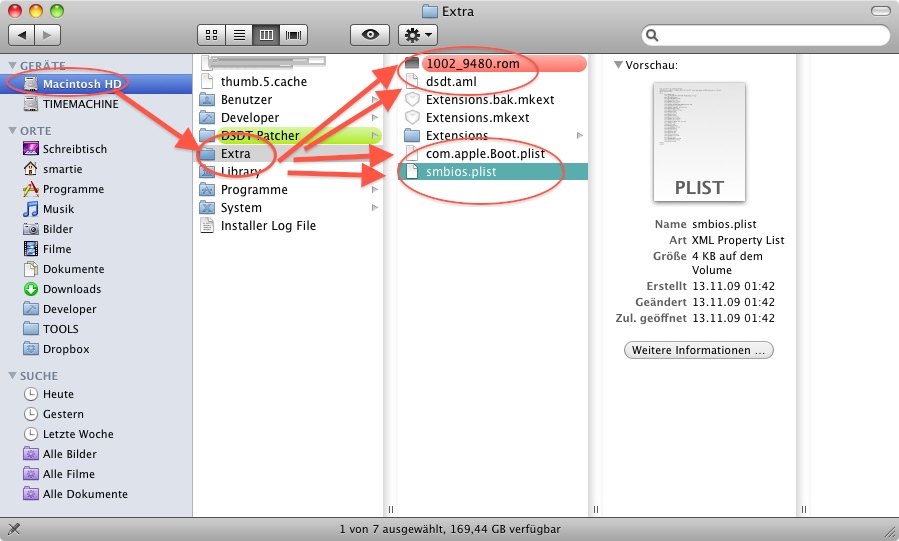

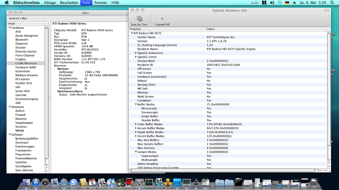

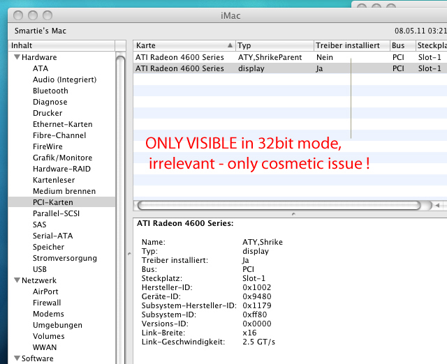

smartie77 Posted May 8, 2011 Share Posted May 8, 2011 !! UPDATED AGAIN 25.june 11 --> for 10.6.8, newer kexts -- please go HERE : 10.6.8 Toshiba 4650 mobility topic ( only this for future ) the following is outdated , only for 10.6.7 : . THIS IS FOR GETTING THE INTERNAL LVDS SCREEN WORKING WITH Quartz,Core Image and accelerated OpenGL on a Toshiba with 15,6 inch "Truebrite" Display and a 4650 mobility radeon REMOVE RADEONHD.kext / RADEONDUMP from Dong before or it wont work ! I don't have external Monitors to test and I don't care about that ability. In 32bit Mode PCI Cards will errorly show "ATY,shrike parent = NO Drivers Installed" in Sysprofiler, this is only optical. Everything works : full resolution, change, ripple effects, DVD player, Front Row, Screensavers, Transparent Menubar, ilife 11, Photoshop CS5, Poser 8/Pro and all other 3D,QE/CI stuff. In 64bit mode everything in System Profiler is correct showing. I must have spoiled something will hexediting, but it is no issue at all, cause it works, therefore I wont tinker with it again. If these kexts work not for you I am sorry, for me they do. Only trying to help out. MY Hardware : Mobility 4650 HD , 1GB RAM DEVID 9480. 1366x768 internal LVDS, Toshiba Satelleite L500 Model late 2009. Phoenix BIOS v2.10. Software : 10.6.6 or 10.6.7 will accept the kexts, just replace them in S/L/E and repair perms. Software like Photoshop will tell you that it uses 4670 ATI openGL which is correct. Framebuffer is SHRIKE. No "green apple" or other color distortions. ( calibrate your display later with OSX ). MacModel used in SMBIOS.plist is imac11,1 ( 9,1 and 10,1 should also do fine, they all feature 9480 cards, see "MacTracker" from the Appstore.Has all Macs data ). This is important for having the Fan / Clock Gating in the Card working correctly. Modes are handled inside a AppleGraphicsPowermanagement.kext in S/L/E. If imac 11,1 ( or other model with a Mobility Radeon ) is found then the powersaver features of the card are enabled by OSX. No Magic, just choose a mac model that fits your hardware halfway. You need to put : boot file in / ( that is your ROOT folder for the boot drive.. and this is "Chameleon" itself, just added 9480 ATI model as supported ) rom file in /Extra edit your apple.com.boot.plist in /Extra so that it reads : GraphicsEnabler=Yes UseAtiRom=Yes boot either with arch=i386 or arch=x86_x64. the included Atiframebuffer,Ati4600Controller,Atisupport,AtiRadeonX2000.kext and all the X2000 Bundles are ALL you need in S/L/E . You can delete all other Ati kexts ( optionally ). BOOT FILE boot.zip ROM of a 4650 card EXTRA.zip ATI KEXTS modded for 4650, 10.6.6/10.6.7 compatible FOR 10.6.8 kexts see link on top to updated topic ! ATImobility4650kexts.zip technical background : I put DevIDs of 1002 (ATI) 9480 ( = 46xx radeon family ) in both Ati4600Controller.kext and AtiRadeonX2000.kext I hexedited Atiframebuffer this way for making it work with Shrike on LVDS: x86 00037298 02 00 00 00 40 00 00 00 09 01 00 00 12 00 00 07 x86_x64 00010F80 02 00 00 00 40 00 00 00 09 01 00 00 12 00 00 07 Link to comment https://www.insanelymac.com/forum/topic/256569-1068-update-toshiba-4650mobility-32-64-bit-sl-internal-1366x768/ Share on other sites More sharing options...

smartie77 Posted May 18, 2011 Author Share Posted May 18, 2011 New Youtube - Presentation of my Folders,boot and smbios plists. Here I show my folders,files and kexts. I hope this answers everything.. also always have a look into the Notebook Section of my postings , some people are only looking there. Link to comment https://www.insanelymac.com/forum/topic/256569-1068-update-toshiba-4650mobility-32-64-bit-sl-internal-1366x768/#findComment-1685457 Share on other sites More sharing options...
Guest NotebookMan Posted May 19, 2011 Share Posted May 19, 2011 Could you please attach your smbios.plist? please add your solution to http://www.insanelymac.com/forum/index.php?showtopic=253132 Link to comment https://www.insanelymac.com/forum/topic/256569-1068-update-toshiba-4650mobility-32-64-bit-sl-internal-1366x768/#findComment-1685820 Share on other sites More sharing options...
smartie77 Posted May 19, 2011 Author Share Posted May 19, 2011 Could you please attach your smbios.plist? please add your solution to http://www.insanelymac.com/forum/index.php?showtopic=253132 <?xml version="1.0" encoding="UTF-8"?> <!DOCTYPE plist PUBLIC "-//Apple//DTD PLIST 1.0//EN" "http://www.apple.com/DTDs/PropertyList-1.0.dtd"> <plist version="1.0"> <dict> <key>SMbiosvendor</key> <string>Apple Inc.</string> <key>SMbiosversion</key> <string>IM111.88Z.0034.B00.0910301727</string> <key>SMbiosdate</key> <string>11/06/2009</string> <key>SMboardmanufacturer</key> <string>Apple Computer, Inc.</string> <key>SMboardproduct</key> <string>Mac-F2268DAE</string> <key>SMfamily</key> <string>iMac</string> <key>SMmanufacturer</key> <string>Apple Inc.</string> <key>SMproductname</key> <string>iMac11,1</string> <key>SMserial</key> <string>W88033AKY51</string> <key>SMsystemversion</key> <string>1.0</string> <key>SMUUID</key> <string>C0CE2600-93D7-3B41-843A-4D7C8E2C12E2</string> <key>SMcputype</key> <string>1281</string> <key>SMmemtype</key> <string>24</string> <key>SMmemspeed</key> <string>1333</string> <key>SMmemmanufacter</key> <string>Apple Computer Inc.</string> <key>SMmemserial</key> <string>100000000</string> <key>SMmempart</key> <string>1</string> </dict> </plist> Link to comment https://www.insanelymac.com/forum/topic/256569-1068-update-toshiba-4650mobility-32-64-bit-sl-internal-1366x768/#findComment-1686036 Share on other sites More sharing options...

plsh2me Posted June 26, 2011 Share Posted June 26, 2011 For full graphics support with QE/CI/openGL the following must be loaded and present in Systemprofiler : ATI4600Controller.kext ATIRADEONX2000.kext ( and the X2000 bundles and plugins, but they are not listed there ) ATISUPPORT.kext ATIframebuffer.kext AppleGraphicsPowermanagement.kext AppleGraphicsControl.kext Thank you for your quick reply. All the kexts are presents in the list. I repaired the disk parmission & reboot, no change !!! What can I do? Thank you. Link to comment https://www.insanelymac.com/forum/topic/256569-1068-update-toshiba-4650mobility-32-64-bit-sl-internal-1366x768/#findComment-1703824 Share on other sites More sharing options...
smartie77 Posted June 27, 2011 Author Share Posted June 27, 2011 .. Thank you for your quick reply. All the kexts are presents in the list. I repaired the disk parmission & reboot, no change !!! What can I do? Thank you. can you run frontrow.app and DVDPlayer.app ? Do you have CoverFlow in iTunes ? can you open jpgs in Preview.app ? Take screenshots with grab.app ? get the ripple effect when you launch new widgets from dashboard ? Switching between user accounts is a blue cube that turns sides ? those above all work only with QE/CI. The rest of OSX mostly works without it. How do you feel that QE/CI is not working .. ? if the kexts are loaded, you should have.. strange .. Is the BIOS.rom file using the name "1002_9480.rom" ( you must not rename it ! ) and sits in /Extra ? Is the com.apple.boot.plist having the string "UseAtiBios=Yes" or "UseAtiVideoBios=Yes" in it ? "GraphicsEnabler = YES" ? Have you RadeonHD.kext or RadeonPCIdump.kext in /S/L/E or in /Extra/Extensions ? If so remove it, repair permissions. It conflicts with the Ati.kexts Have you tried booting in 32bit mode ( com.apple.boot.plist : arch=i386 instead of x64_x86 ) and tried if this happens then too ? Link to comment https://www.insanelymac.com/forum/topic/256569-1068-update-toshiba-4650mobility-32-64-bit-sl-internal-1366x768/#findComment-1704118 Share on other sites More sharing options...

smartie77 Posted June 28, 2011 Author Share Posted June 28, 2011 That's great !!!! It works !!!!Now, what can I do for get QE/CI ? try to use my rom file in /extra for one boot and give it a try. backup yours outside of /Extra. If boot does not work, boot with -s -x GraphicsEnabler=No UseAtiBios=No , then make the mac HD accesible with mount -uw / navigate to the Extra folder with cd /Extra rm 1002_9480.rom ( delete my rom ) cp /Backupfolder/1002_9480.rom /Extra ( copy your rom with same name back to /Extra) shutdown -r now reboots and uses again your rom. else I cannot help much. You said you have a total different machine, only the GPU is the same. That's ok, but it could be that your laptop can not use Shrike FB or that the connector pins are not the same as in Toshiba. If that's the case you must edit your own Framebuffers. Link to comment https://www.insanelymac.com/forum/topic/256569-1068-update-toshiba-4650mobility-32-64-bit-sl-internal-1366x768/#findComment-1704805 Share on other sites More sharing options...
