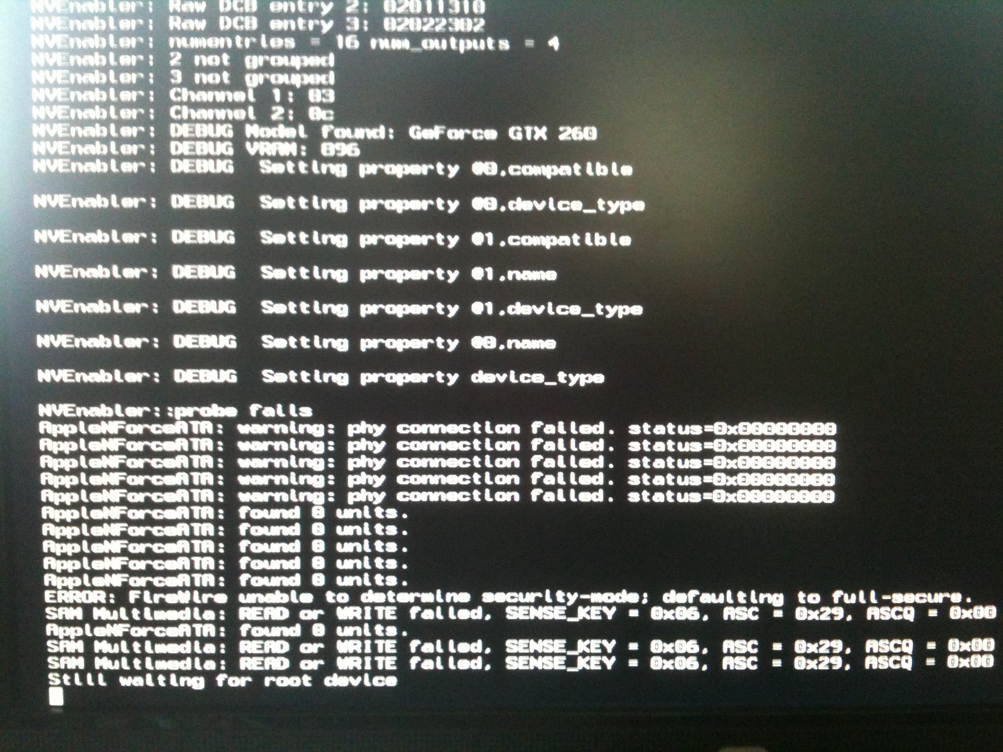

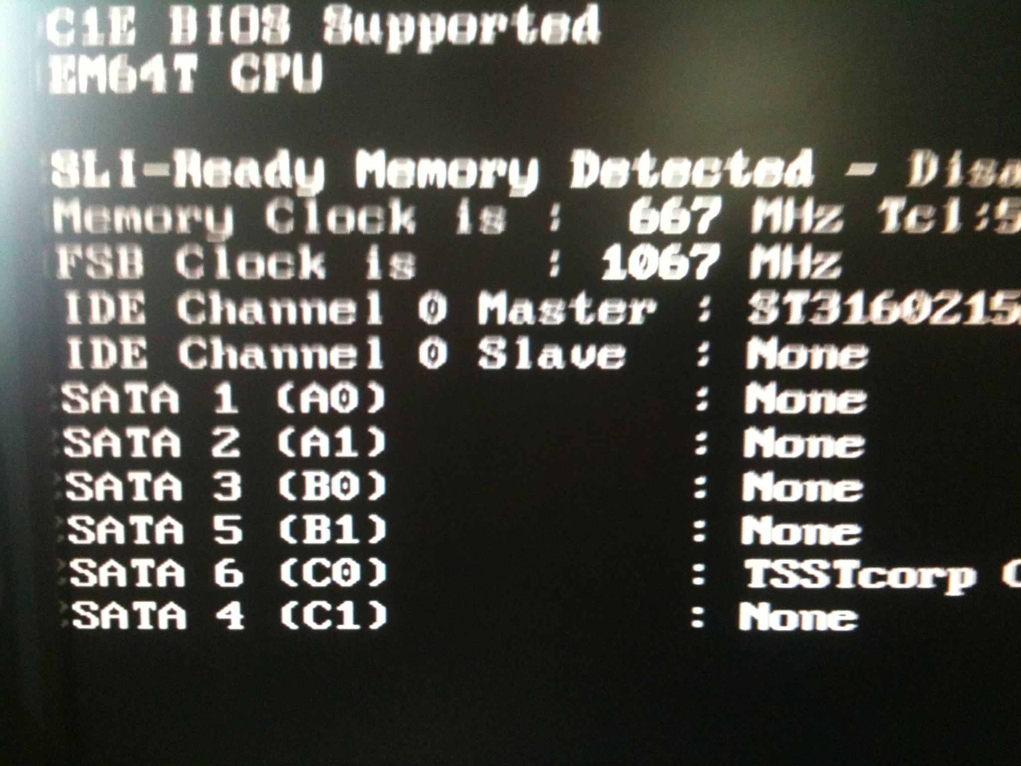

aquadog Posted April 21, 2011 Share Posted April 21, 2011 HI Thanks for help in advance! my PC mobo xfx 680i LT SLi (default settings) 4KG ddr2 ram intel core 2 duo E7200 running at stock speed (just to get rid of any possible errors) gtx 260 palit sonic sata dvd rom raid sata configuration (disconnected during installation) 160GB ata IDE hdd all for my mac Right I am trying to install mac os x snow leopard 10.6.3 using iaktos s3 v2 shouldn't be a problem as I did read plenty about installation on my nforce board and people managed it. I cant even get to installation process as I am greeted by apple screen of death. I tried using -f -v -x -v etc but they all came to the same problem STILL WAITING FOR ROOT DEVICE right I have only one hdd (during the installation to stop any unwanted errors) and I made sure that the hdd is configured as master by jumpers and everything! So Im stuck here and have no idea what to do next. Also Im sorry if this topic has been discussed earlier. I will ad pictures of the what was on the screen after using -v function Link to comment https://www.insanelymac.com/forum/topic/255348-still-waiting-for-root-device/ Share on other sites More sharing options...
verdant Posted April 23, 2011 Share Posted April 23, 2011 Get or borrow a IDE DVDRW to do the installation and connect it as Master (see post #1 in topic link below) with the IDE HDD as Slave.........or try installing OS X to an external USB HDD and then cloning that volume onto your SATA HDD......and use AppleNForceATA_TEST.kext in /S/L/E with your SATA DVDROM.......I assume you have set up your BIOS correctly according to my BIOS template for 680i downloadable from post #1 of my nForce Pre-Series 7 topic here....? Link to comment https://www.insanelymac.com/forum/topic/255348-still-waiting-for-root-device/#findComment-1673661 Share on other sites More sharing options...

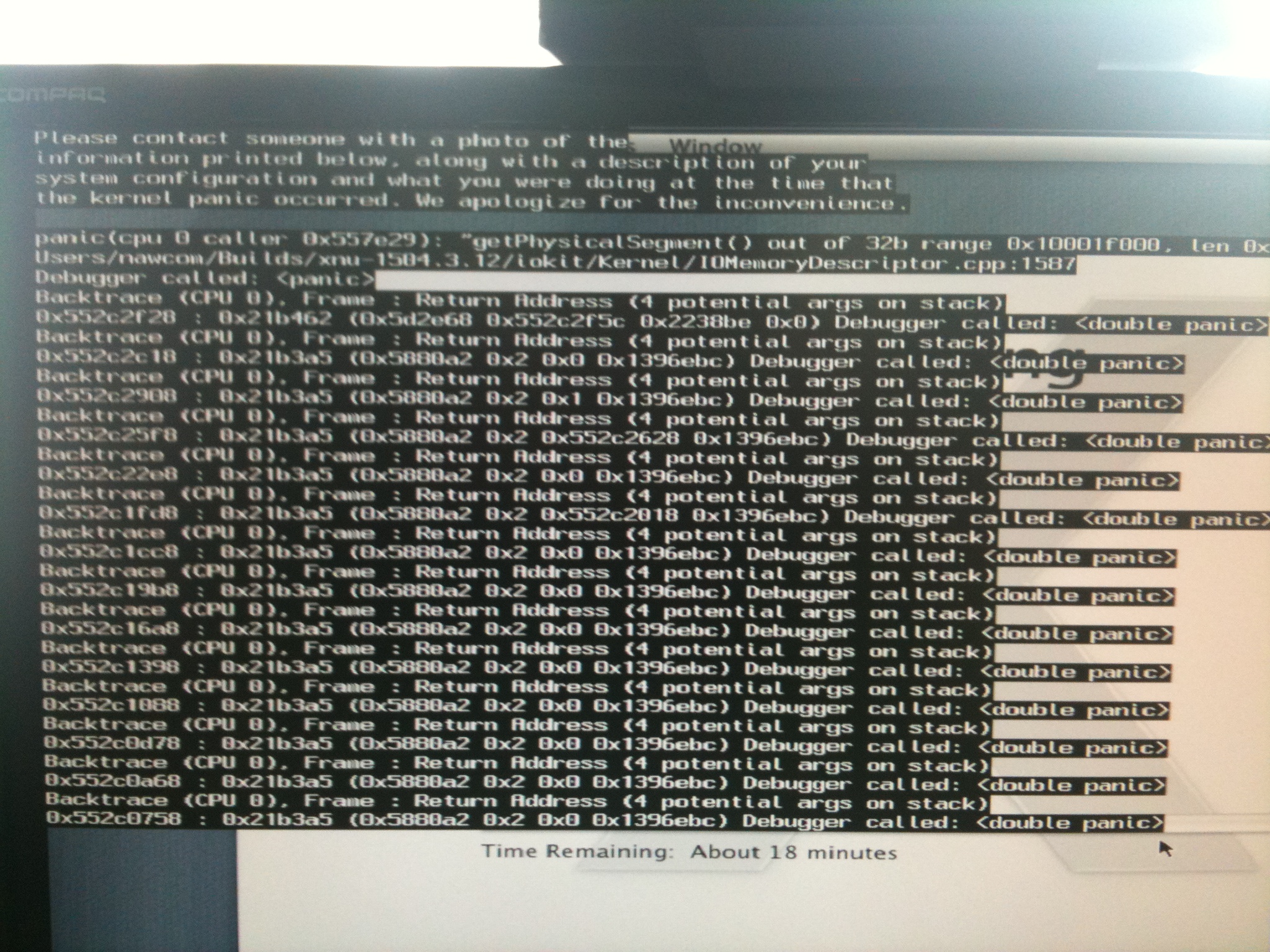

aquadog Posted April 29, 2011 Author Share Posted April 29, 2011 See my iATKOS S3 v2 install guide on an nForce MOBO here......... I've seen this guide many times and nearly studied it! I followed your instructions and made the right selection. Unfortunately I got kernel panic details are on the picture. If anyone has an idea what is wrong please let me know. All your help much appreciated! Link to comment https://www.insanelymac.com/forum/topic/255348-still-waiting-for-root-device/#findComment-1676243 Share on other sites More sharing options...
verdant Posted April 29, 2011 Share Posted April 29, 2011 This kernel panic invariably relates to 32bit versus 64bit memory accessing when you have more than 3GB RAM installed.....AFAIK the reason is that getPhysicalSegment returns a 32bit address but because the physical memory address cannot fit in 32bits a panic occurs.....which invariably happens when more than 3GB of RAM is installed on the MOBO..... So, the system panics with the following message type in the kernel panic log: panic(cpu X caller 0xXXXXXXXX): getPhysicalSegment() out of 32b range 0xXXXXXXXX, len 0xXXXX, class IOGeneralMemoryDescriptor....... Hence, include maxmem=2048 as a boot flag for Chameleon until you have installed the correct AppleNForceATA.kext by slashack......see the latter part of the guide...... Link to comment https://www.insanelymac.com/forum/topic/255348-still-waiting-for-root-device/#findComment-1676412 Share on other sites More sharing options...

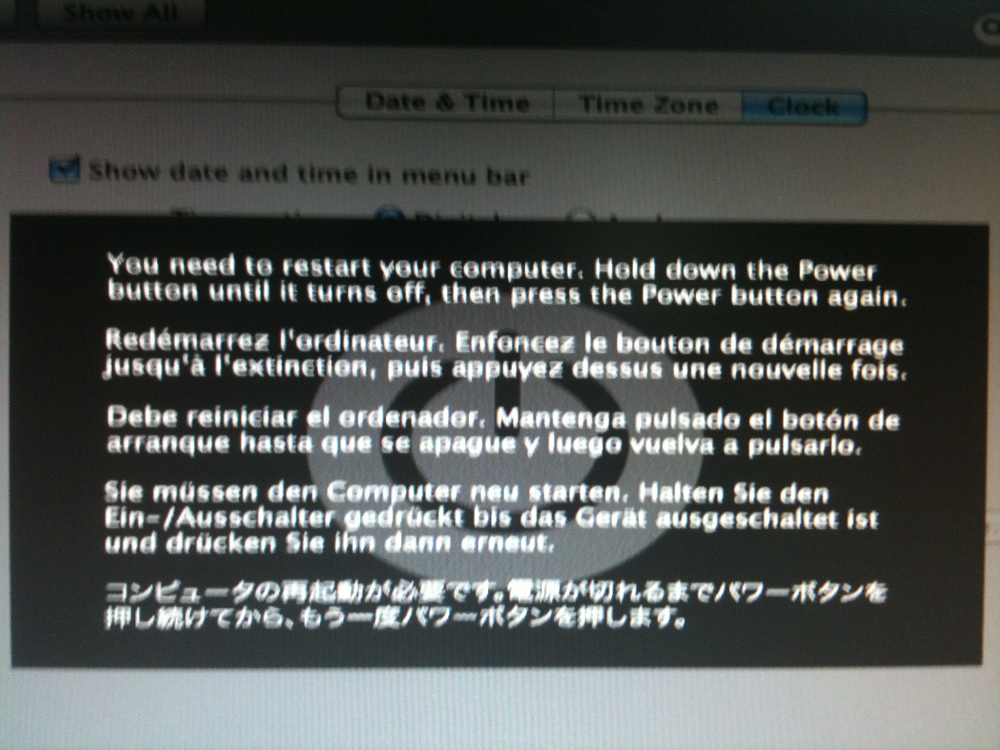

aquadog Posted May 10, 2011 Author Share Posted May 10, 2011 hi I was using mac for some time (mostly trying to get the GPU working properly) but this message gets in my way too many times... Any one know what is the cause of this? Link to comment https://www.insanelymac.com/forum/topic/255348-still-waiting-for-root-device/#findComment-1681652 Share on other sites More sharing options...
verdant Posted May 11, 2011 Share Posted May 11, 2011 hi I was using mac for some time (mostly trying to get the GPU working properly) but this message gets in my way too many times... Any one know what is the cause of this? Yes, that is the OS X kernel panic alert screen........boot with -v debug=0x144 (also try -v debug=0x100) to see what may be causing the kernel panic........ Link to comment https://www.insanelymac.com/forum/topic/255348-still-waiting-for-root-device/#findComment-1681961 Share on other sites More sharing options...
