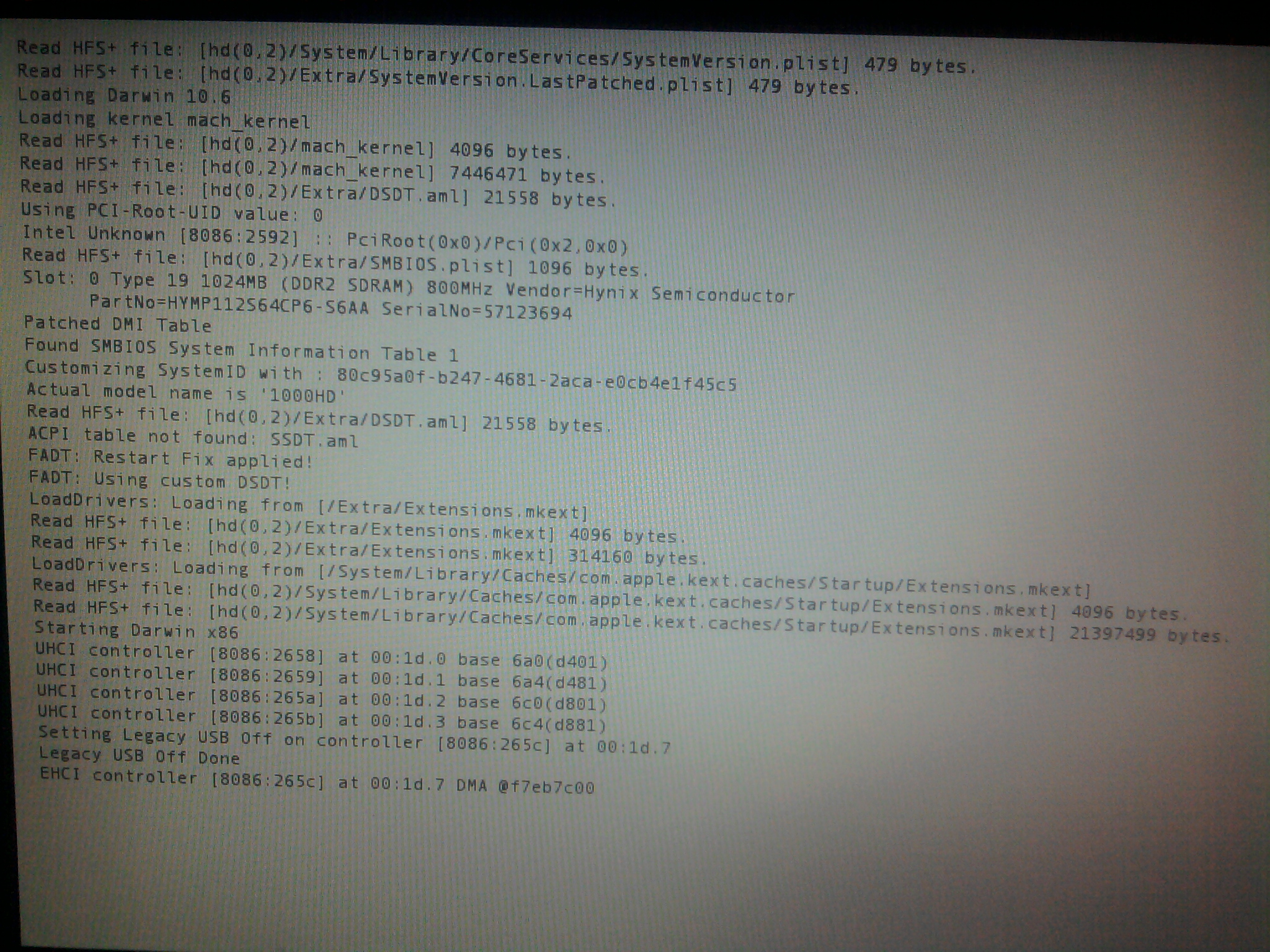

brebis875 Posted March 31, 2011 Author Share Posted March 31, 2011 My netbook does not start, it displays this message at boot (with -v flag), I've one HFS+ partition with GUID table. I did the installation from another PC and use NetBookInstaller v0.85pre. The version of osx is 10.6.7 with 10.7.0 kernel xnu-1504.9.37 ~ 1. Read HFS+ file: [hd(0,2)/System/Library/CoreServices/SystemVersion.plist] 479 bytes. Read HFS+ file: [hd(0,2)/Extra/SystemVersion.LastPatched.plist] 479 bytes. Loading Darwin 10.6 Loading kernel mach_kernel Read HFS+ file: [hd(0,2)/mach_kernel] 4096 bytes. Read HFS+ file [hd(0,2)/mach_kernel] 7446471 bytes. Read HFS+ file: [hd(0,2)/Extra/DSDT.aml] 21558 bytes. Using PCI-Root-UID value: 0 Intel Unknown [8086:2592] :: PciRoot(0x0)/Pci (0x2,0x0) Read HFS+ file: [hd(0,2)/Extra/SMBIOS.plist] 1096 bytes. Slot: 0 Type 19 1024MB (DDR2 SDRAM) 800MHz Vendor=Hynix Semiconductor PartNo=HYMP112S64CP6-S6AA SerialNo=57123694 Patched DMI Table Found SMBIOS System Information Table 1 Customizing SystemID with : 80c95a0f-b247-4681-2aca-e0cb4e1f45c5 Actual model name is '1000HD' Read HFS+ file: [hd(0,2)/Extra/DSDT.aml] 21558 bytes. ACPI table not found: SSDT.aml FADT: Restart Fix applied ! FADT: Using custom DSDT ! LoadDrivers: Loading from [/Extra/Extensions.mkext] Read HFS+ file: [hd(0,2)/Extra/Extensions.mkext] 4096 bytes. Read HFS+ file: [hd(0,2)/Extra/Extensions.mkext] 314160 bytes. LoadDrivers: Loading from [/System/Library/Caches/com.apple.kext.caches/Startup/Extensions.mkext] Read HFS+ file: [hd(0,2)/System/Library/Caches/com.apple.kext.caches/Startup/Extensions.mkext] 4096 bytes. Read HFS+ file: [hd(0,2)/System/Library/Caches/com.apple.kext.caches/Startup/Extensions.mkext] 21397499 bytes. Starting Darwin x86 UHCI controller [8086:2658] at 00:1d.0 base 6a0(d401) UHCI controller [8086:2659] at 00:1d.1 base 6a4(d481) UHCI controller [8086:265a] at 00:1d.2 base 6c0(d801) UHCI controller [80861265N at 00:1d.3 base 6c4(d881) Setting Legacy USB Off on controller [8086:265c] at 00:1d.7 Legacy USB Off Done EHCI controller [8086:265c] at 00:1d.7 DMA @f7eb7c00 PS: Désolé si mon anglais est mauvais (Sorry if my English is bad) Link to comment https://www.insanelymac.com/forum/topic/253518-asus-1000hd/#findComment-1663454 Share on other sites More sharing options...
Gringo Vermelho Posted April 2, 2011 Share Posted April 2, 2011 That's the verbose output from the Chameleon boot loader, from before OS X starts to load. It looks fine to me, I don't see any indication of any issues with anything, except maybe your 'unknown' Intel on board video. Try booting in safe mode with -x -v and see if you get any further. Also try PCIRoot=1. always he block on boot with "ACPI table not found: SSDT.aml". Chameleon 2.0 RC5 looks for SSDT tables in /Extra and if it doesn't find any it will show that message. It doesn't mean that there is something wrong, SSDT dumps are not required but loading them can fix issues with native CPU power management. Read this thread for more information: http://www.insanelymac.com/forum/index.php?showtopic=225766 Link to comment https://www.insanelymac.com/forum/topic/253518-asus-1000hd/#findComment-1664755 Share on other sites More sharing options...
