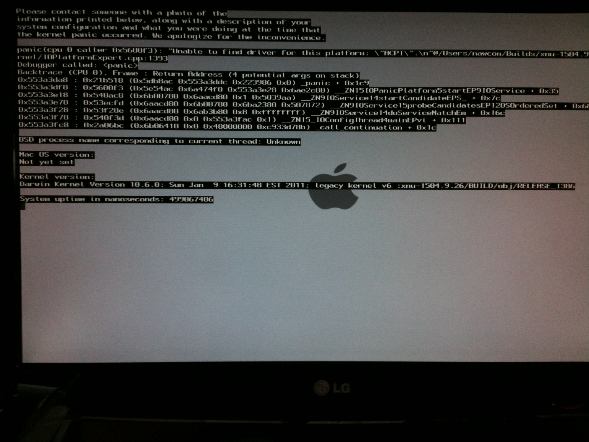

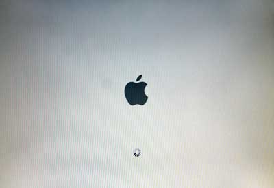

staman Posted March 28, 2011 Share Posted March 28, 2011 Hi guys, I'm having problem of installing Mac OS on PC and I stuck on the first step. When I boot Mas OS it's freezes (pic below)... What should I do to make it work? Thanks for a help. Quote Link to comment https://www.insanelymac.com/forum/topic/253500-installing-problem/ Share on other sites More sharing options...
Gringo Vermelho Posted March 28, 2011 Share Posted March 28, 2011 Useless photo. Boot with -v to see diagnostic messages. Quote Link to comment https://www.insanelymac.com/forum/topic/253500-installing-problem/#findComment-1662354 Share on other sites More sharing options...
staman Posted March 28, 2011 Author Share Posted March 28, 2011 I did it and appeared a black screen and frozen again Quote Link to comment https://www.insanelymac.com/forum/topic/253500-installing-problem/#findComment-1662358 Share on other sites More sharing options...

staman Posted March 28, 2011 Author Share Posted March 28, 2011 I do not know what info should I provide. I am a newby in this thing I used this tutorial http://tgrounds.blogspot.com/2009/04/leopa...on-your-pc.html Tell me what should I provide to you? may be this pic will help. I boot it up with [url="http://www.insanelymac.com/forum/topic/279450-why-insanelymac-does-not-support-tonymacx86/"]#####[/url] when I have got this Quote Link to comment https://www.insanelymac.com/forum/topic/253500-installing-problem/#findComment-1662366 Share on other sites More sharing options...

Gringo Vermelho Posted March 31, 2011 Share Posted March 31, 2011 In the BIOS enable all advanced CPU settings except CPUID limit. Enable ACPI 2.0 and ACPI APIC. Try disabling hyperthreading. Make sure your video card is compatible, use the forum search to find out. Quote Link to comment https://www.insanelymac.com/forum/topic/253500-installing-problem/#findComment-1663742 Share on other sites More sharing options...
