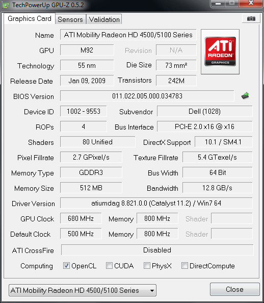

But i 'm not able to extract myself the VBIOS of my 4570m 512. Gpu-z refuse to extract the bios and i dont know how to extract the vbios from the motherboard bios (dell 1557 A08).
the gpu-z output is :
http://gpuz.techpowerup.com/11/03/27/8g0.png
Anyone can help me ? Especially kizwan , to got my 4570m vbios?
